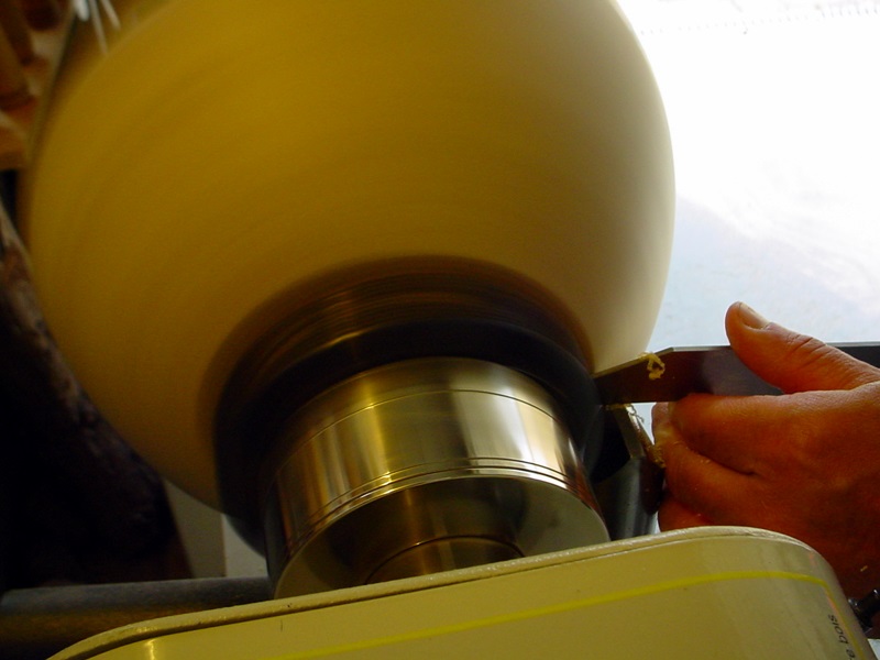

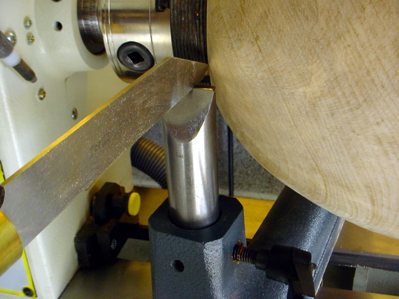

    And finally, this very simple tool rest , not so common, is thought for special cases where you need close support but don't have the room laterally.
    Typically used for supporting inside a deep cove, or for parting off the foot of a large bowl, like in the following example:
    I think I found the idea of this one here on HMT, but can't remember from whom, thanks to him anyway
    Cheers !
    Christophe

    Thanks Christophe! I've added your Spot Tool Rest to our Wood Lathes category, as well as to your builder page: Christophe Mineau's Homemade Tools. Your receipt:
    793
    Showing how you'd use it was good. Makes understanding how the tool works easier for non-turners like me.
