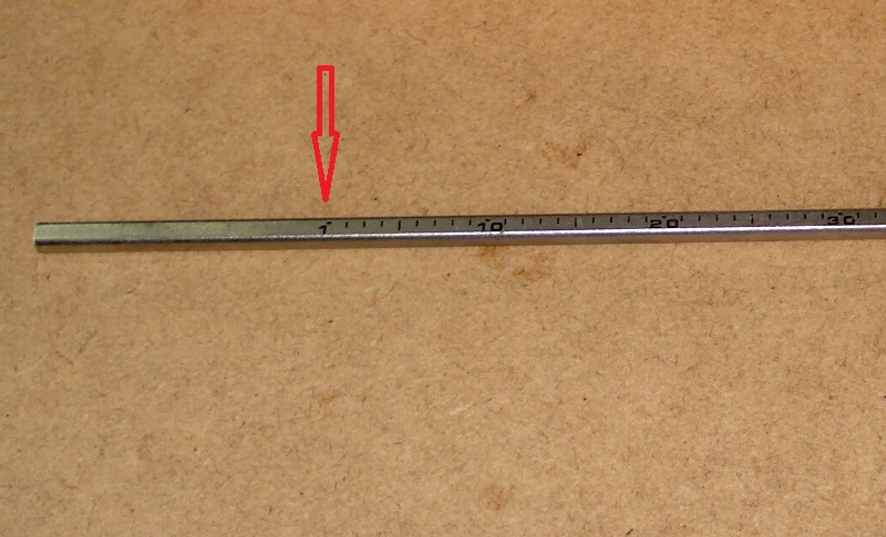

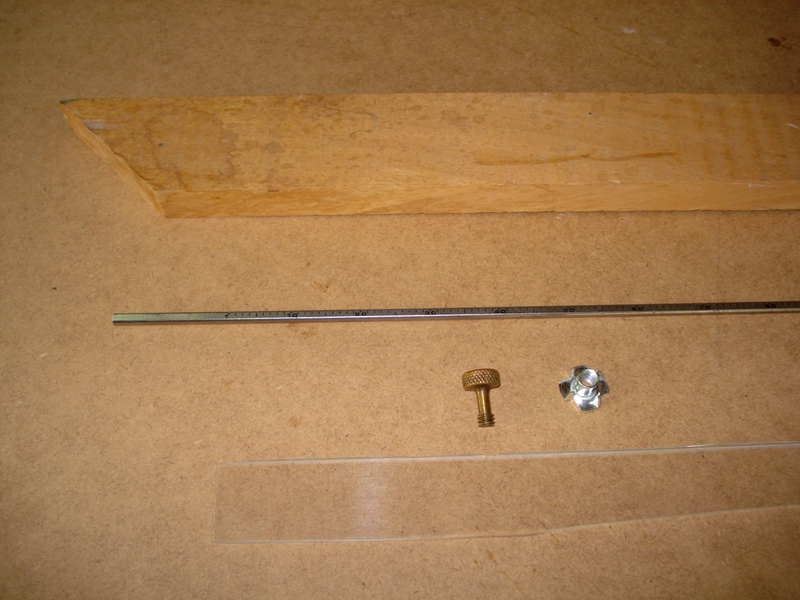

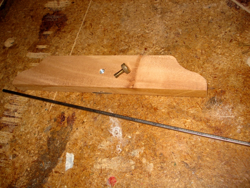

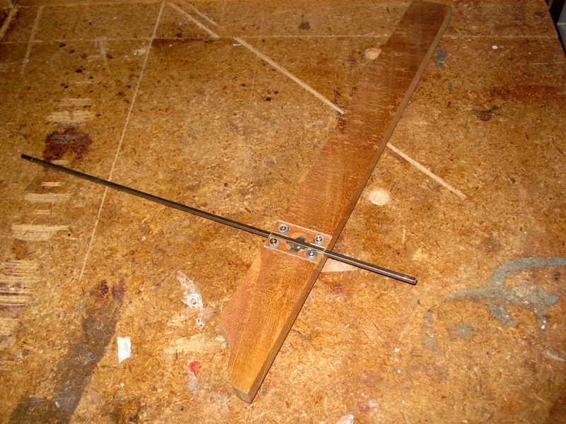

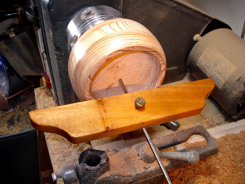

    Depth gauges used in woodworking are not generally useful for measuring the depth of a hollow made in a bowl or other pieces at the wood lathe. There are several homemade depth gauges for this purpose on the net.
    This version I show was made with a discarded printer bar (calibrated in tenths of an inch), a piece of cedar, a brass screw, a “T” insert nut, and a piece of acrylic.

    A great measuring tool! simple but should be very useful for not hollowing through long or narrow vase "blind" stlye bowls.

    Indeed, it is practical and reliable. Before making this tool, I used to use two rules: one resting on the edges of the piece, and the other, perpendicular to the first, to measure the distance from the bottom to the rule.
    To use the tool, you can measure the depth of the hollow as you advance; as alternative you can set the desired depth in the gauge and hollow until this limit.
