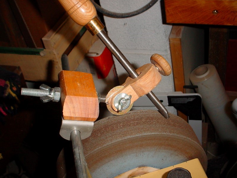

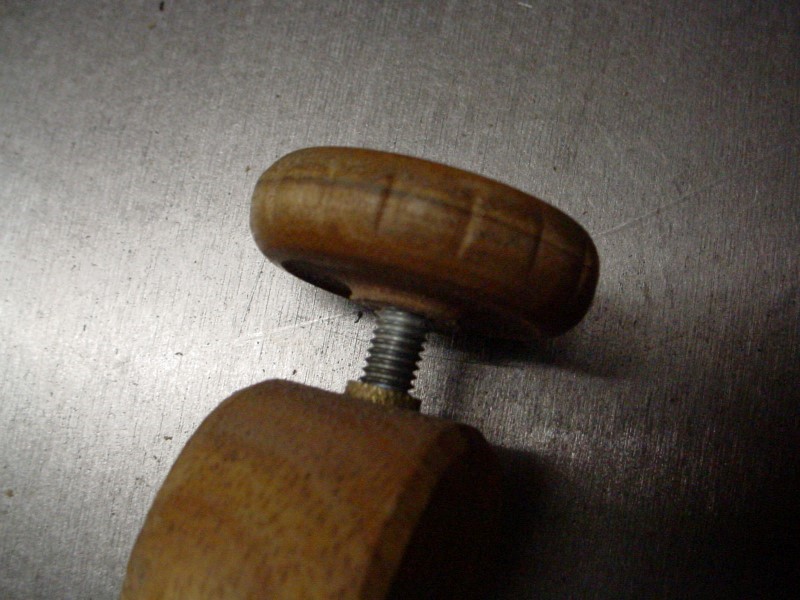

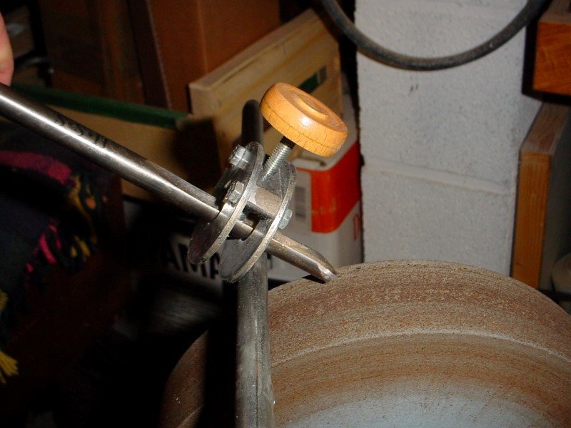

    I would like to highlight my technique for making wooden knobs.
    People often think that a wooden knob could be too fragile for a strong tightening or think that the screw could too rapidly turn into the wooden part ...
    That's not true and here is how I make my wooden knobs :
    Two wooden disks are turned out of a same piece and are then parted in two pieces.
    An hex head screw is then drilled across its head, and a pin is inserted in that hole.
    In one of the two wooden disks, a hole is drilled, just the size of the outer diameter of the screw head.
    Then a little groove is carved to let the head with the pin to be inlaid entirely in the wood.
    Both wooden disks are then re-glued with epoxy.
    After drying, the screw shaft is chucked back on the lathe, and the knob is turned to its final shape.
    Here it is :
    Here are some other examples where I have used this technique :
    Cheers !
    Christophe
