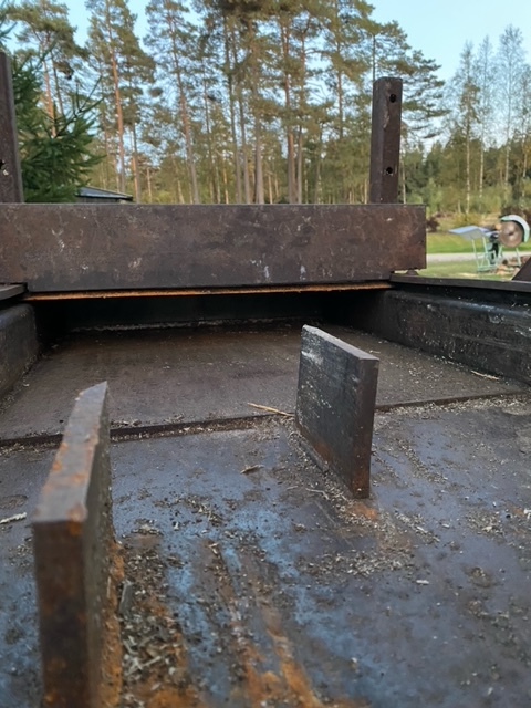

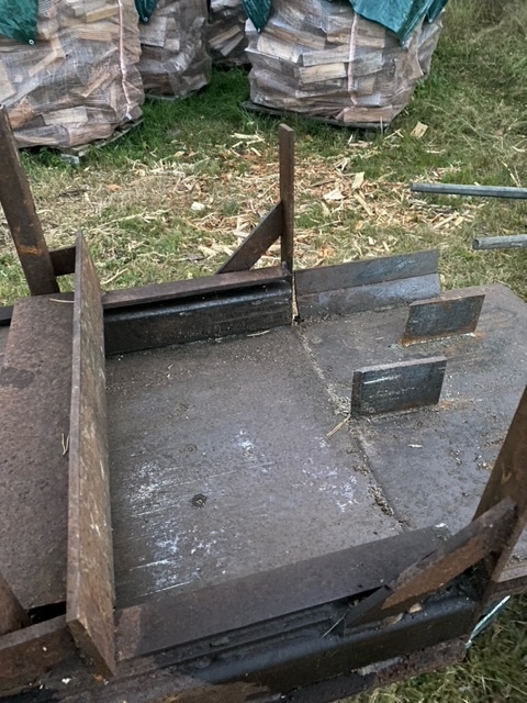

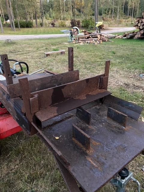

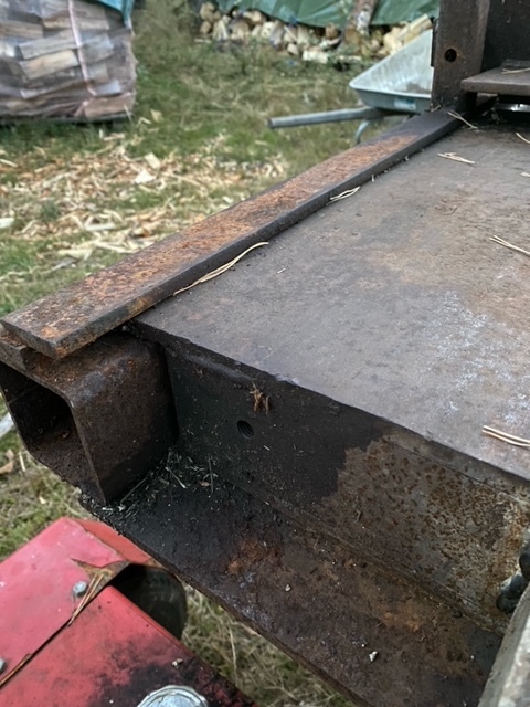

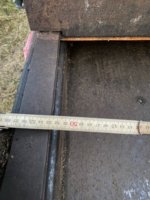

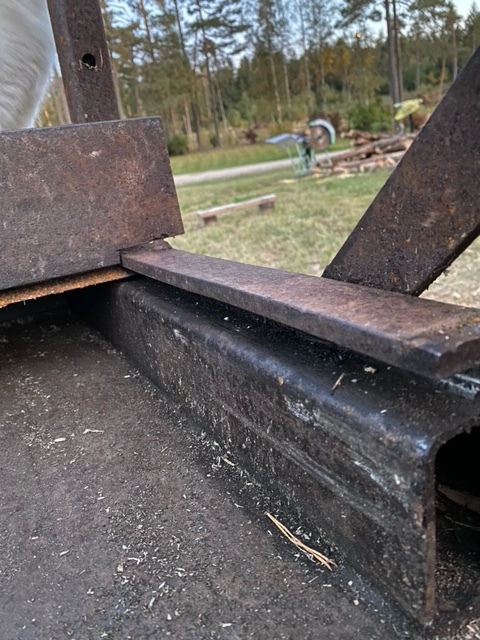

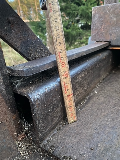

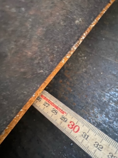

    Hi
    I just read about ironbark on wikipedia, and it's obviously tough stuff
    Here are some pictures and measurements of various parts of the splitter, but it can be made with other measurements as well. If anyone wants more information, just ask and I will answer as best as I can (with good help of google translate ).
    This is set up for wood lengths of 30 cm which is a common standard here.
    Wood splitter-image10.jpegWood splitter-image9.jpegWood splitter-image7.jpegWood splitter-image6.jpegWood splitter-image4.jpegWood splitter-image3.jpegWood splitter-image2.jpegWood splitter-image0-1-.jpeg

    ups!
    sorry
    I posted close-ups and measurements in response to previous posts. It should have been posted here, but now it is there for people who would like to make somthing similar.

    That is a cool splitter. Very well executed. Maybe you could "automate" it, so you put in a log, and start the cycle. Then you can walk away to fetch the next log while it is processing the first log .
