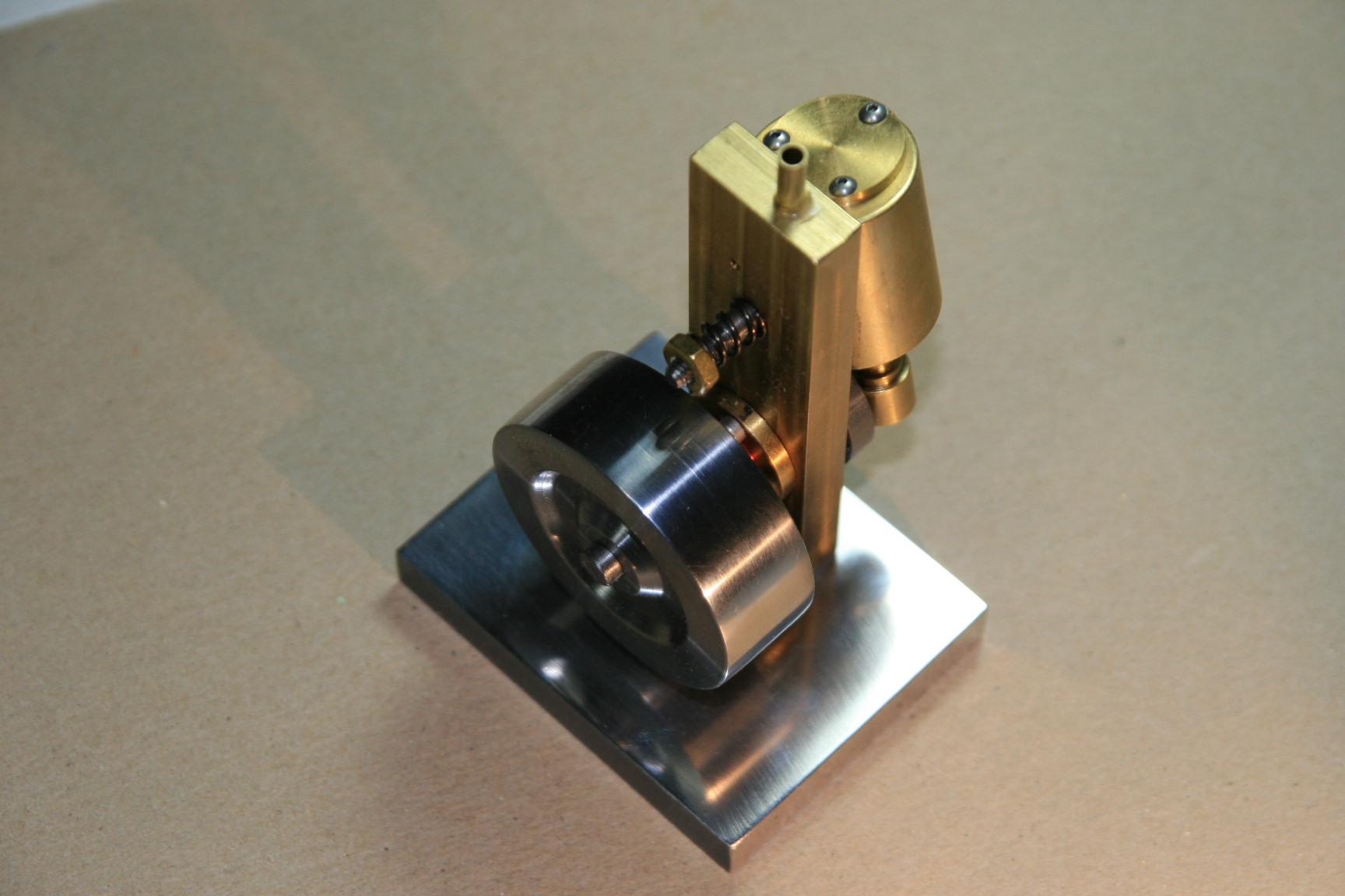

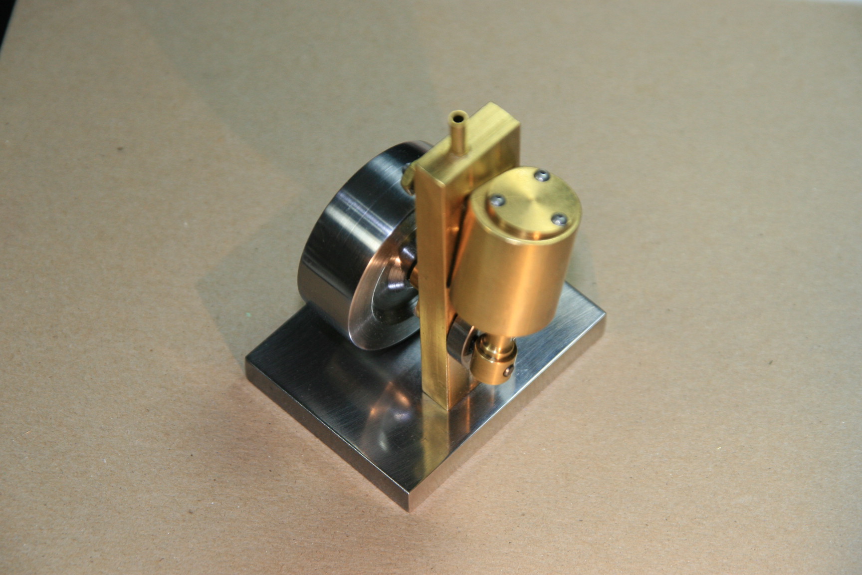

    There are a lot plans on the net for these little wobbler engines.
    Easy to make and only a few parts. The base is steel and the flywheel is steel.
    The rest is brass.
    Cheers, JR

    Very nicely done, JR. As you probably know, the wobbler is the engine form most often recommended for folks who are starting out in the engine building hobby. That said, the basic engine design can be elaborated considerably. Here's a picture of one I built from a Verburg design that is both double-acting and reversible...
    The wobbler is simple and dependable. They can be surprisingly powerful given their simplistic valving design. Plans for multi-cylinder versions exist where one cylinder won't do the job.
