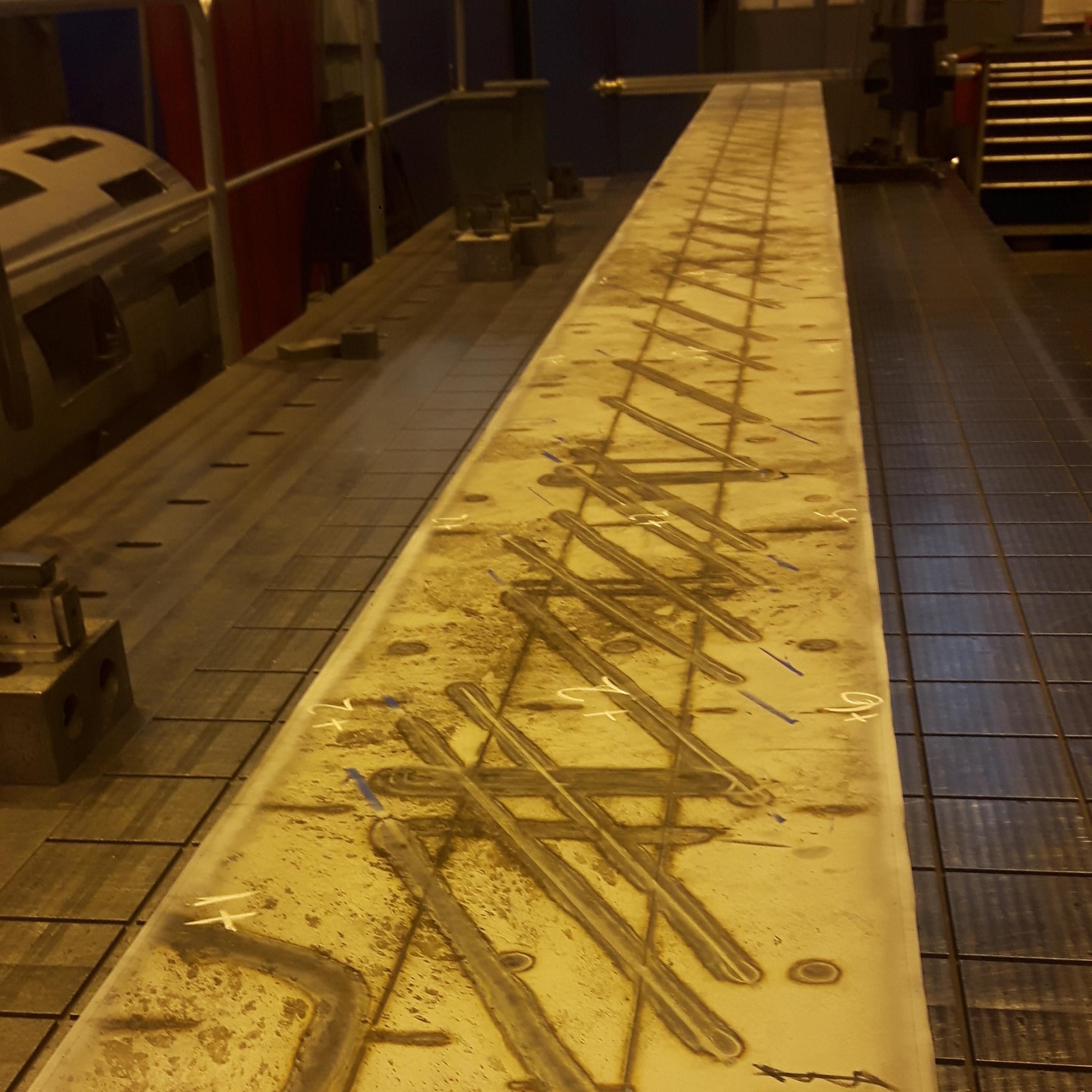

    Yeah. That's familiar to me.
    Its sometimes very frustrating to explain that "we really need those tools".. or that "we need couple days to straighten our worktable".. maintain our tools or..
    We have 13meters long worktable that's supported from the ends, it can be lifted and turned 360 degrees electrically.
    We build components that weight + 10 tons on top of it. Loads of welds, so it should be obvious that it starts to bend slowly, and soon centerpoint is 5mm lower than ends.
    That doesn't sound much, but when you need to make pieces with 5mm machining allowance, it takes much more time to straighten workpiece afterwards, because we have to build it bendt from the start. Lots of shrinking with heat afterwards to get result straight, mostly just because we don't have time to fix the table.
    This example is from the one simple and light part. But it has loads of machining. Because our worktable is twisted and bend.
    Result is that we need to straighten twisted workpiece with diagonal heats from both sides.
    This has 2mn machining allowance on horizontal surfaces... and every time, it reguires loads of heating, just because.. blaah..
