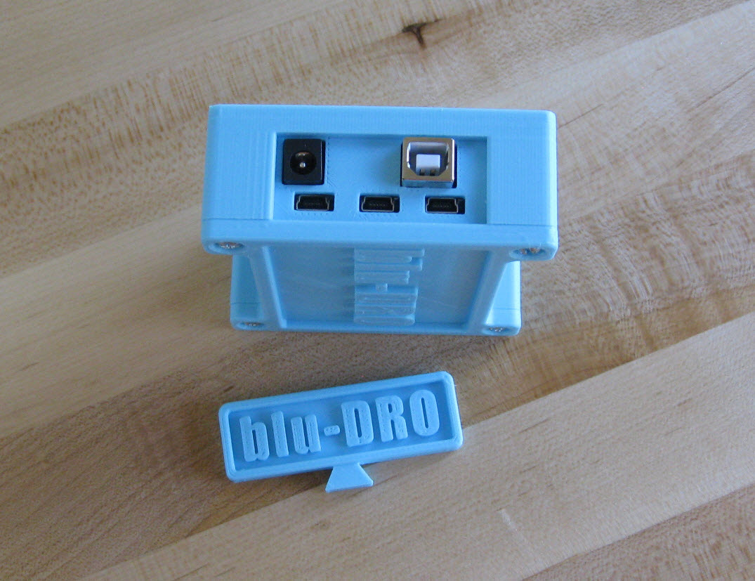

    Helped an online friend a while back design a 3D-Printed electronics box for a Bluetooth wireless Digital Readout (DRO) that uses any 'Android' type tablet and the TouchDRO App ...
    As a Thank You he sent me one of the blu-DRO electronics enclosure units.
    al@blu-dro.com ... http://blu-dro.com

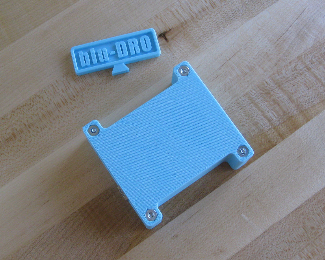

    It came in nice looking Dark Blue 'blu-DRO' box, but just for the fun of it I drew up and 3D-Printed a box on my 3D-Printer when I was 3D-Printing the Android Tablet mounts ...

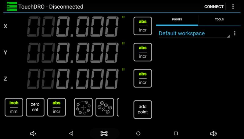

    For More info about Yuriy's very well done TouchDRO App:

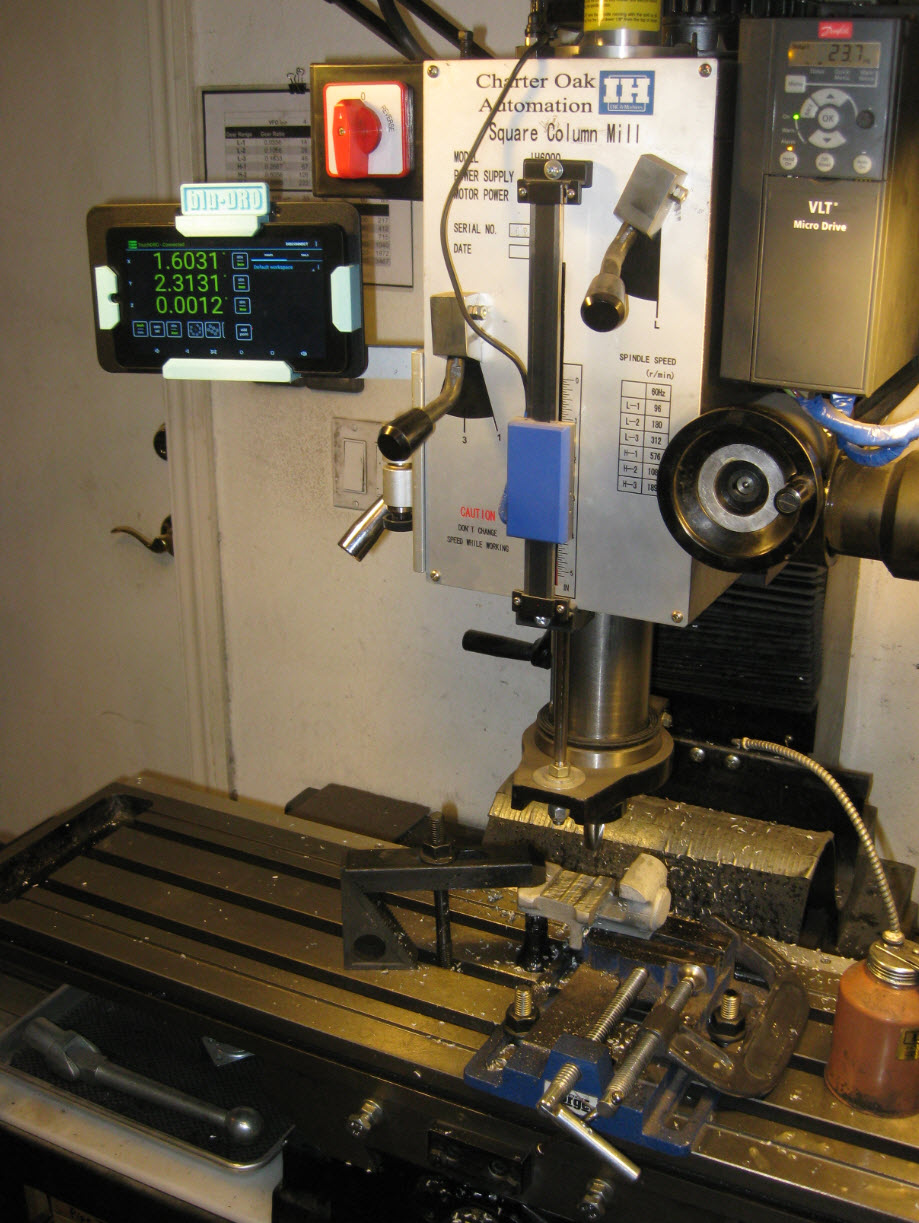

    It works seamlessly with the inexpensive AccuRemote Digital Readouts I already have on my Milling Machine.

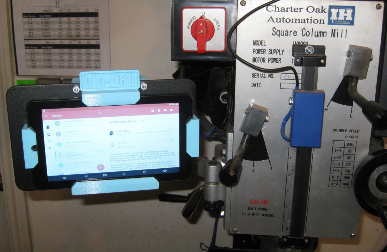

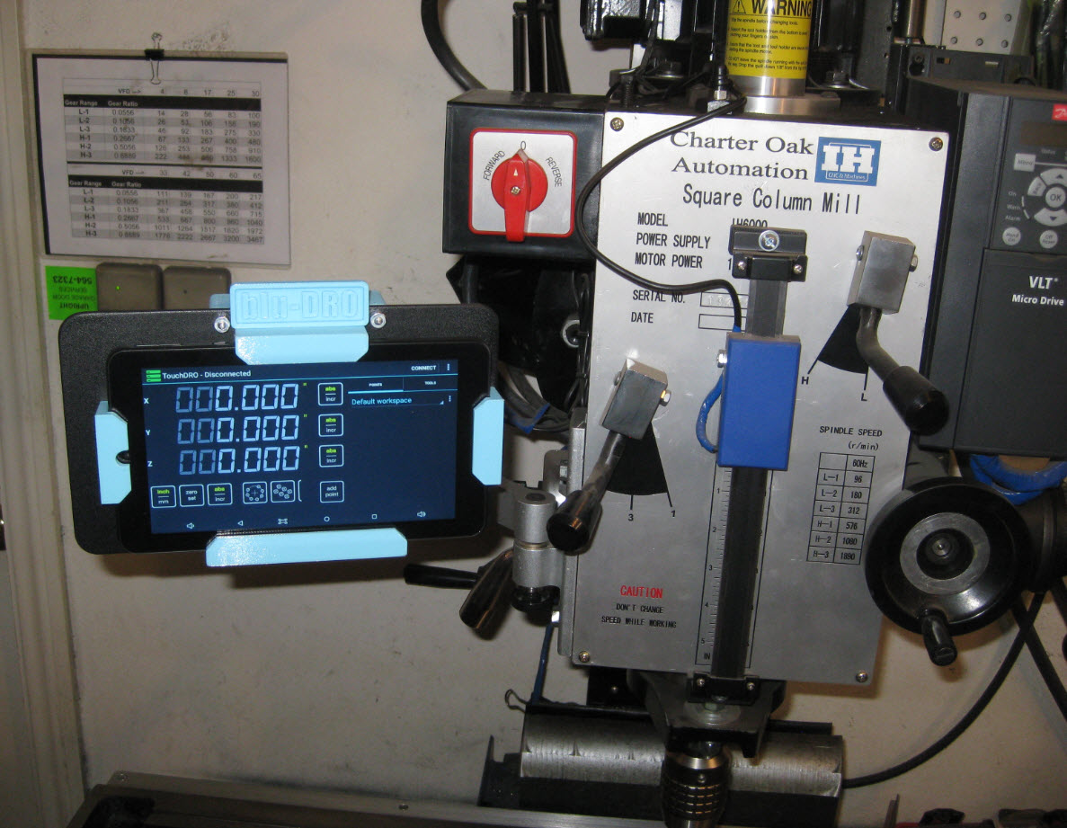

    I purchased an inexpensive EMATIC brand Android type 7" tablet for $49 to use with the blu-DRO electronics box ...

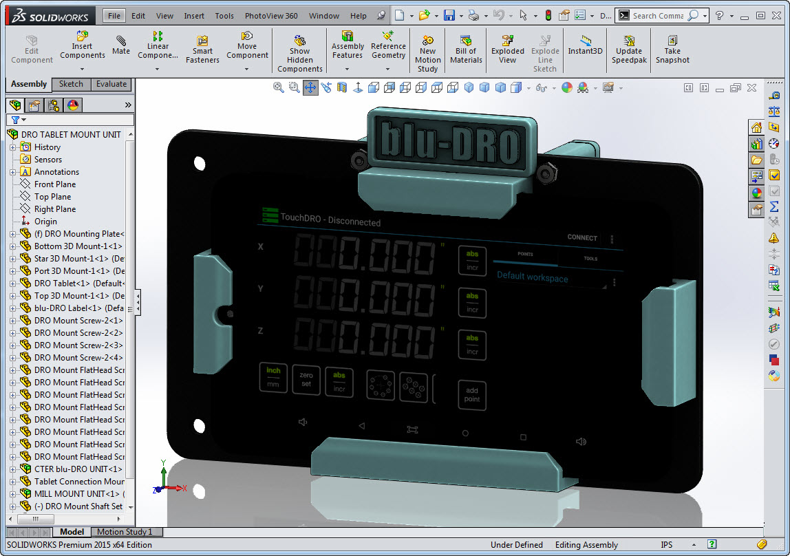

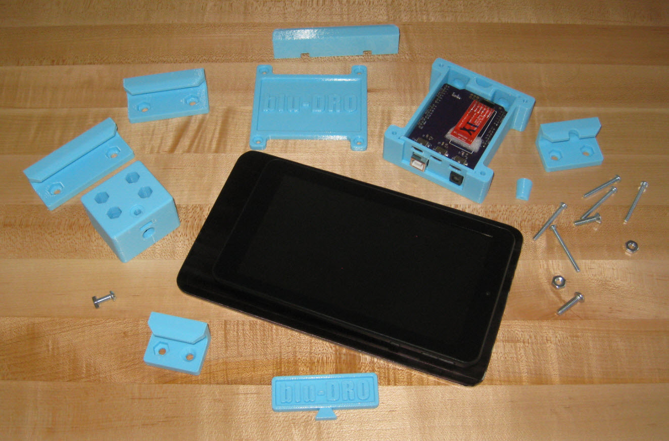

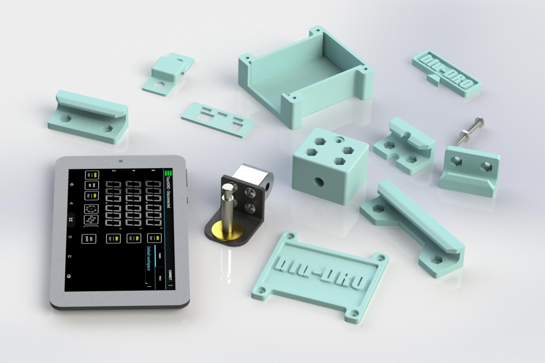

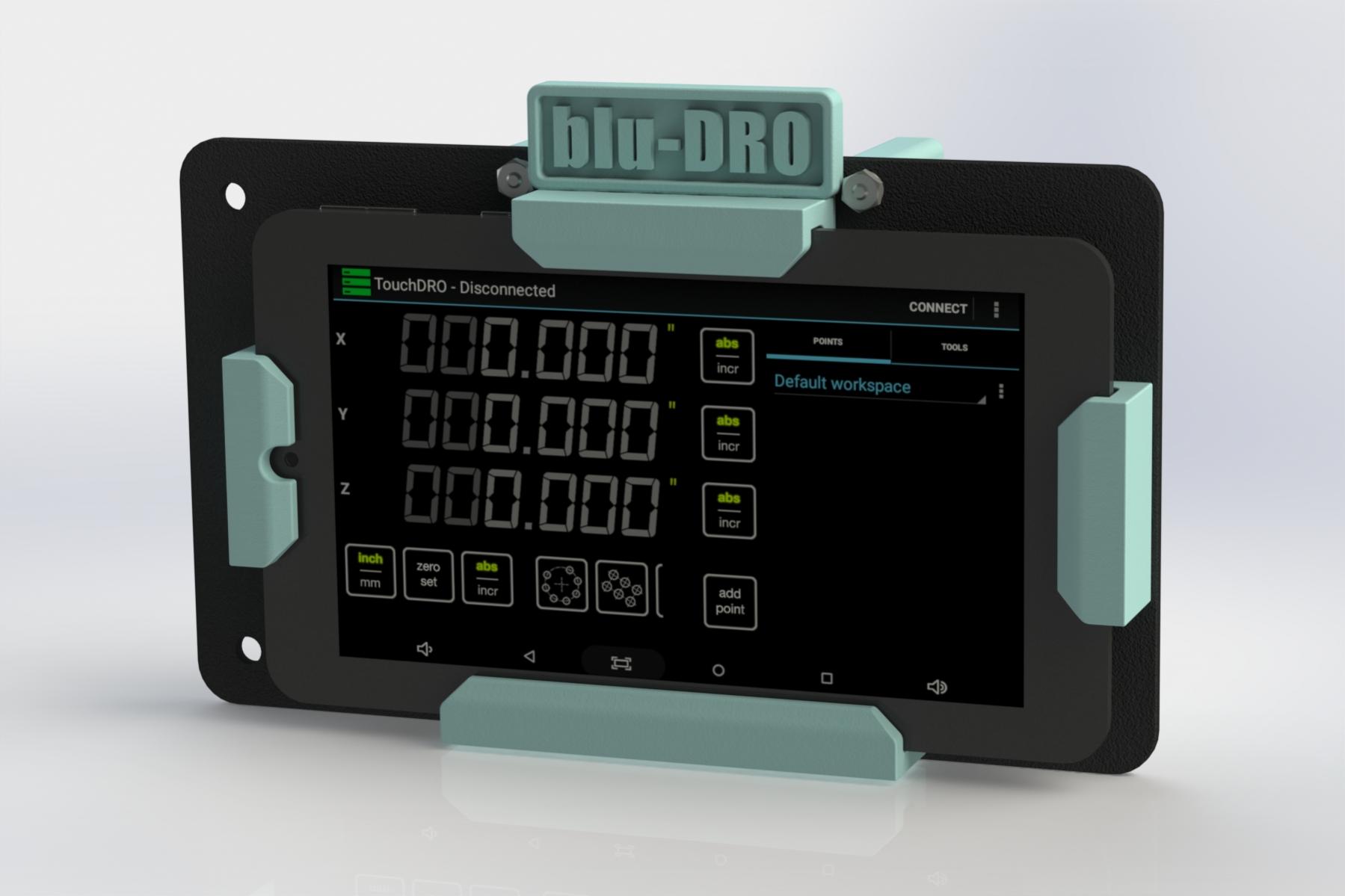

    Used SolidWorks CAD software to draw my tablet mounts and 3D-Printed them ...
    Wireless Mill Digital Readout (DRO)-blu-dro-parts.jpgWireless Mill Digital Readout (DRO)-blu-dro-tablet-unit.jpg

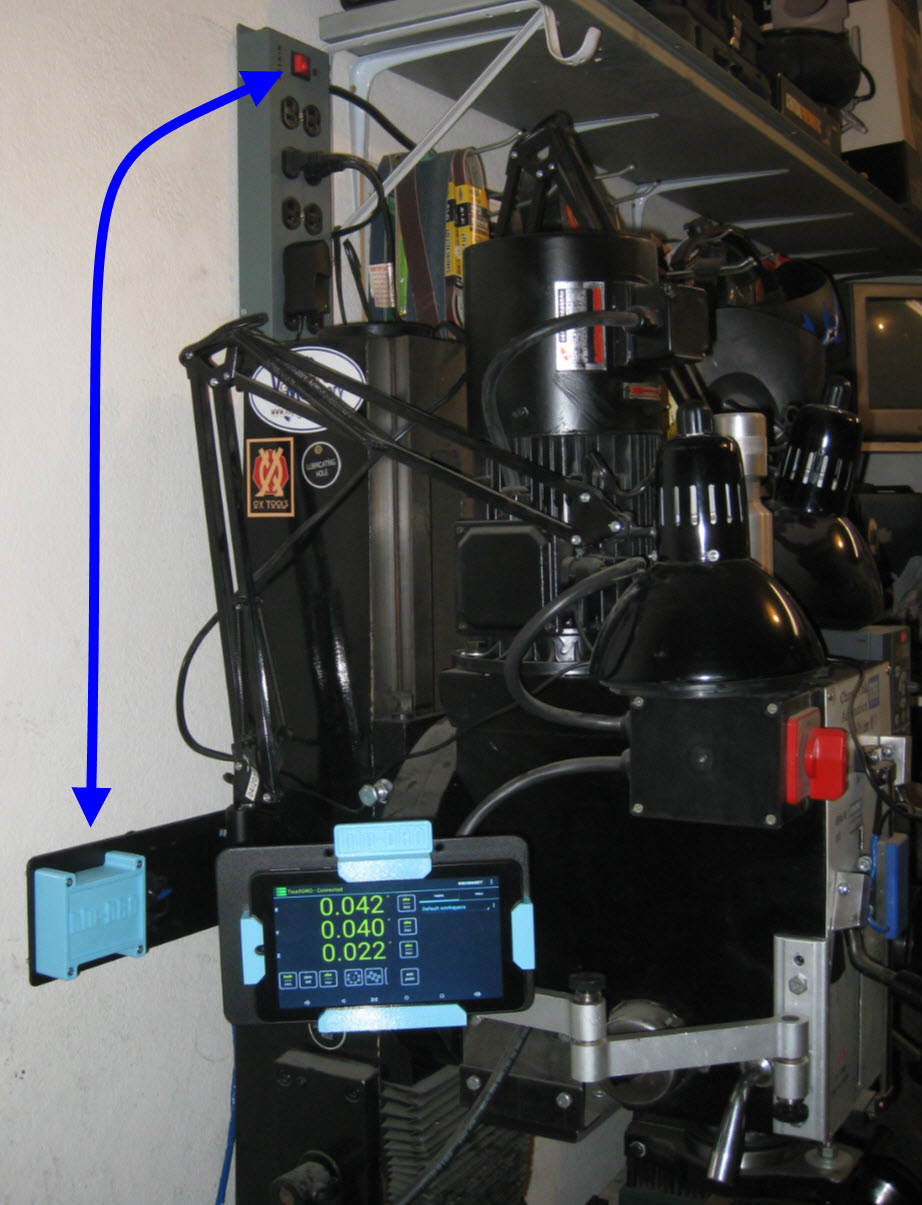

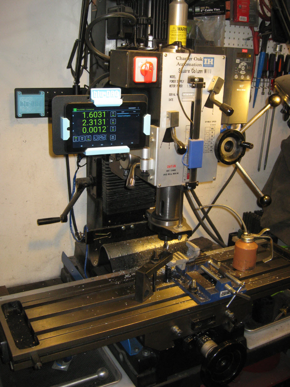

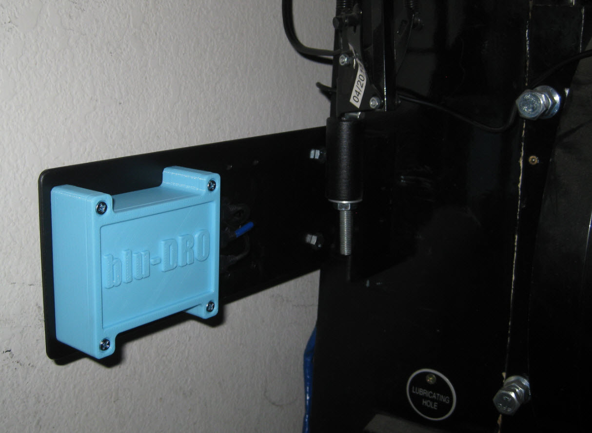

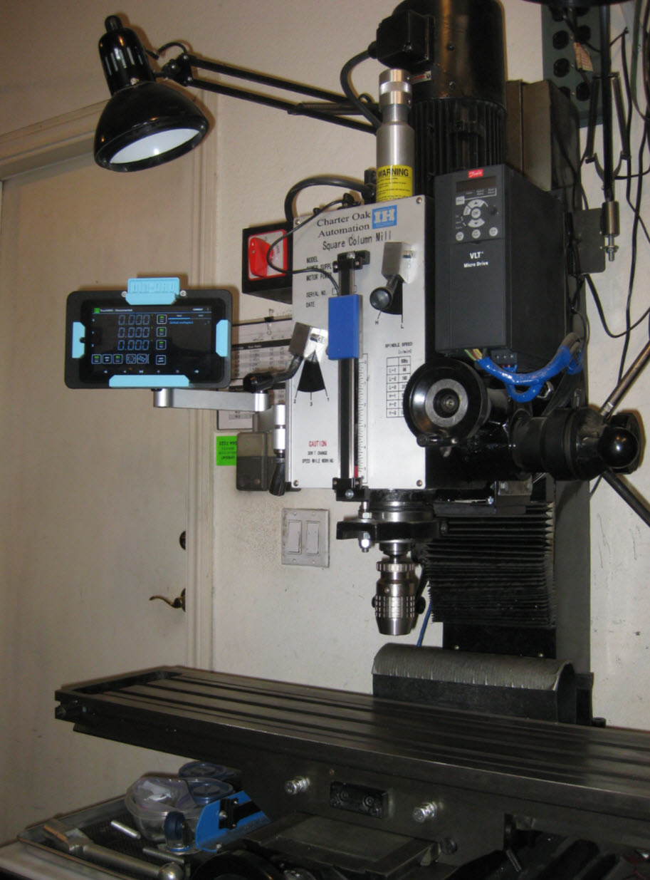

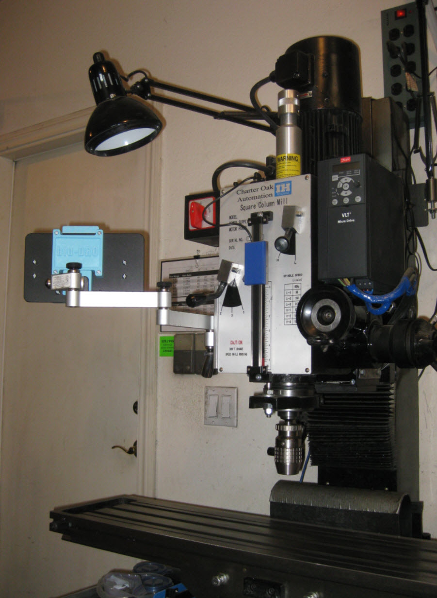

    I installed the Unit onto a Metal Plate connected to a swivel arm on my Milling Machine and I am very pleased with the results
    Video Link: https://twitter.com/MetalDesigner/st...06214675001344
    I can mount the blu-DRO box on the back of my mount plate and pull it off in seconds and mount it on my lathe ... but being wireless connection to Tablet/Screen one would probably mount the blu-DRO box on the side of the mill out of the way.
    Even better as soon as more blu-DRO electronics box units are available I am going to get another blu-DRO electronics box and mount on both my Lathe and Milling machine because then there will be no cords running out on the swing arm that holds the Android Tablet. (Same tablet works on both Lathe & Mill and slips into 3D-Printed holders on each machine in just seconds because it is wireless)
    Don't need a power cord on tablet because it works off the battery all day ... and I take it inside during night time and plug it in.

    Bonus is I can read my email out in the shop ... and View PDFs of Mechanical Drawings on the Tablet ... and can view Machinist Speed/Feed Apps on the same tablet I use as a DRO
    At first I thought the blu-DRO had to be plugged into the Android Tablet with a cord ... then he informed me it was Wireless and uses Bluetooth so I could mount the electronics way out of the way of fluids and chips and plug in the 3 AccuRemote cords into the electronics blu-DRO box... and then that frees up to mount the wireless tablet on a swing arm or where ever one wishes to mount it.
    I thought is was great BEFORE found out it was wireless, but now it is amazing!!

    Put a post on my Website with Links for more TouchDRO details; https://ctmprojectsblog.wordpress.co...-wireless-dro/
    and http://www.yuriystoys.com/p/about-me.html

    I added some more photos with the blu-DRO Electronics Box mounted to the back-side of my Mill and the tablet & TouchDRO App are completely wireless ...

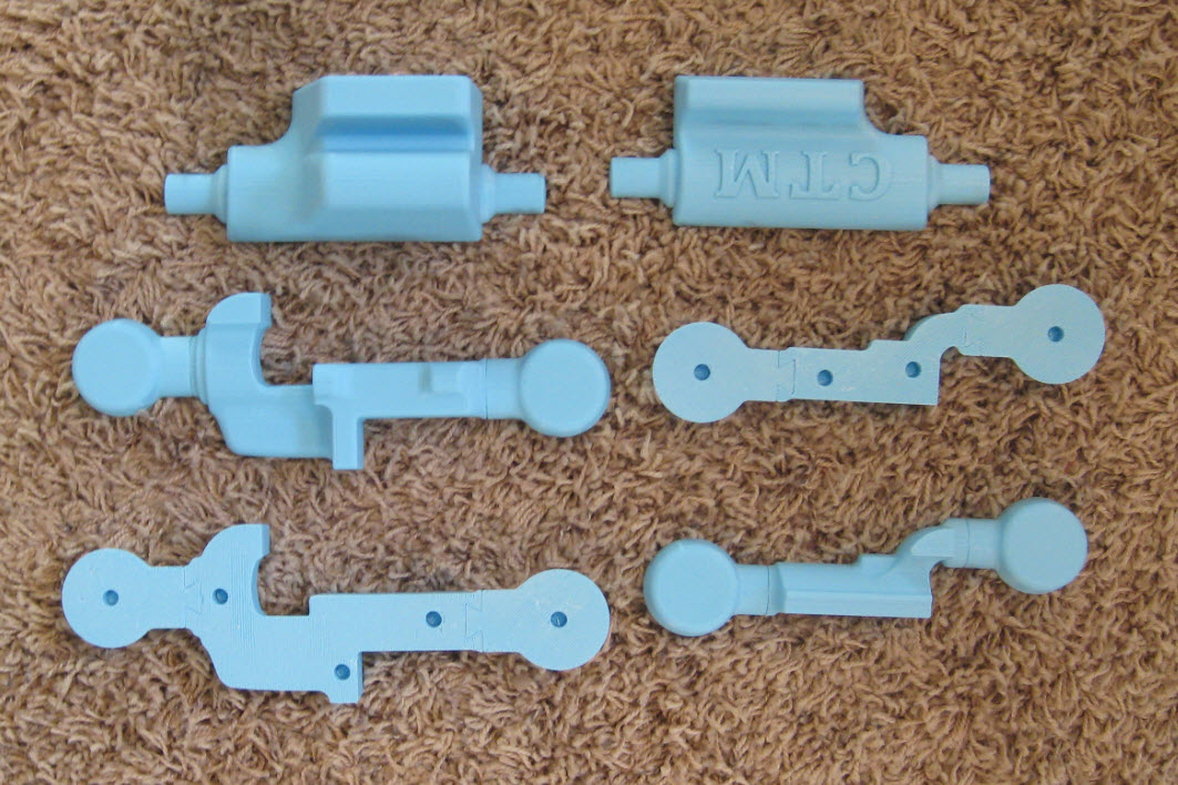

    Here are some updated photos showing using that blu-DRO control unit my friend Al sent to me to machine a Aluminum Casting on my Milling Machine ... it works with the free TouchDRO App that works 'wireless' on any Android OS tablet.
    I 3D-Printed the Vise Split-Patterns to create a sand mold hollow shape to pour in the molten Aluminum ... The castings were made by my friend SuperDave.
    The two Machinist Vises I usually use were at a different workshop, so I had to rig up this bizarre little ‘Cat-in-the-Hat’ milling hold down setup using my drill-press vise.
    Setup worked to get the test cut measurement needed, but I was about to the point of getting out the duct tape ��
    … The important thing is the blu-DRO worked flawlessly!! Thanks AL!!
