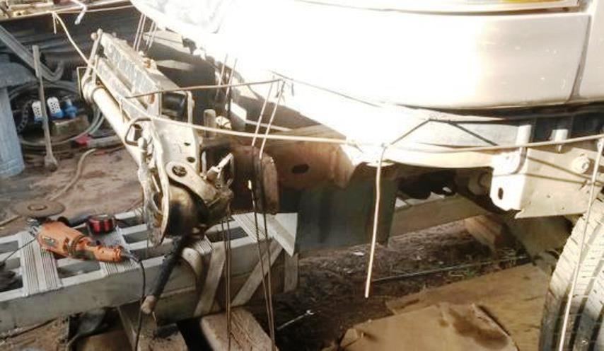

    Now that I have the tow bar mount figured out it is time to construct a new bumper
    To give me an idea of the final outcome I decided to create a partial mock up of how the bumper would look amd function by using wire
    Since a bumper is symmetrical I only needed to tack up the 1 side to give me my clearances
