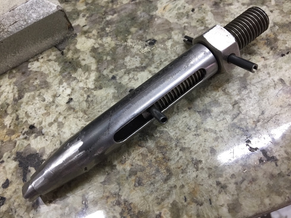

    My take on the "old" wire clamp tool. Used it to connect what ever pipes I could find to make up the 20 meters I needed to get to the tanks. Can share its working if someone does not know this type of clamp. Fortunately made it some time ago so it was ready for use and at least clamps were going to be no problem.

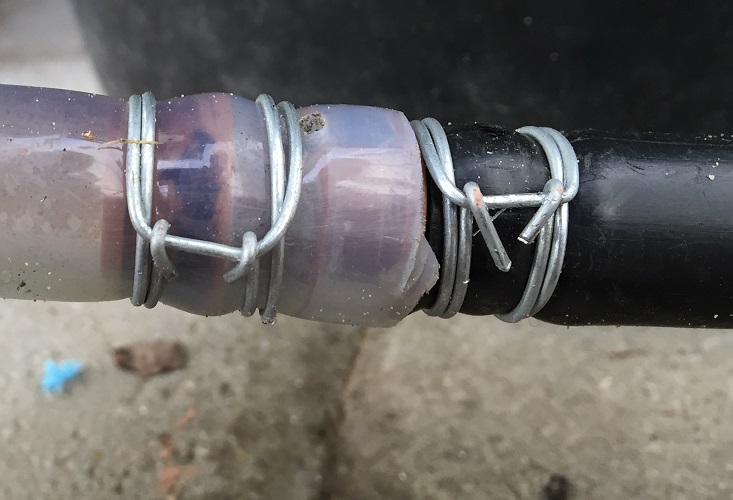

    the clamps are super neat, low profiled and for mine I use galvanised wire. I tried stainless, but find the wire has too much spring back.

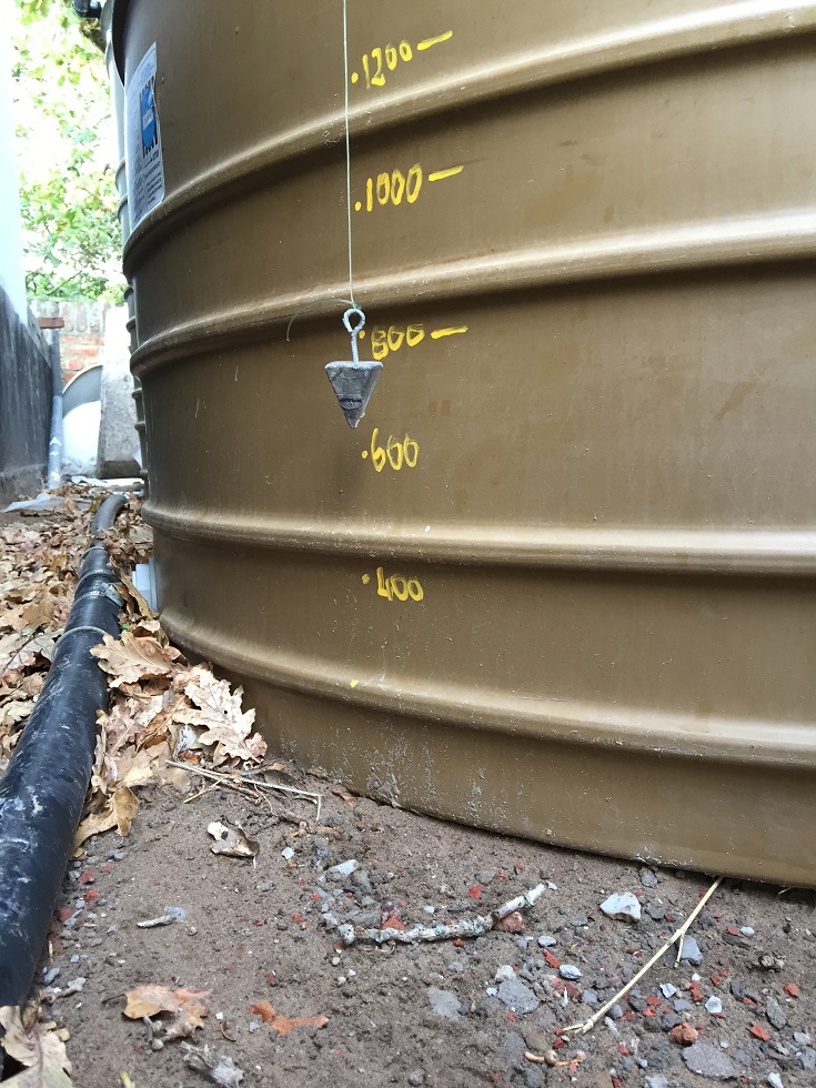

    And I have to share with my Web family that I managed to recover +600 Liters of water with some promise of some more rain Monday after noon

    OK, I'll bite . . . please explain the operation. It looks simple enough to make and the clamps looks very useful. Thanks for the post.

    Was hoping nobody would ask, my video skills are terrible, but will go and find a link that is more easily understood that all my bla bla bla

    No need to become a videographer. The manufacturer's page...
    https://clamptitetools.com/
    has videos describing its use.

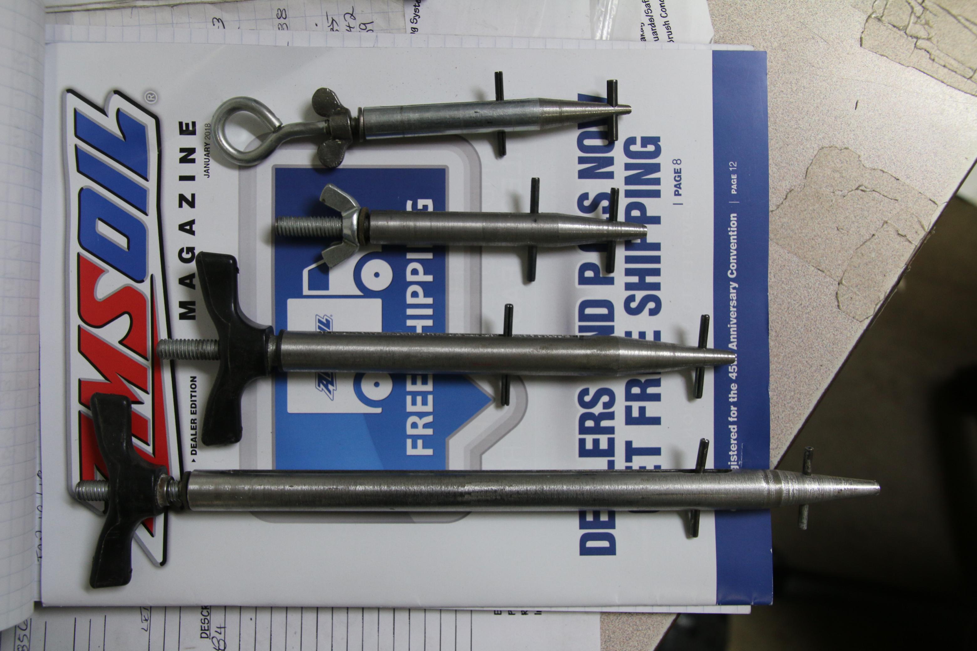

    Here are the ones I have left of the ones I made, three different sizes. One year a bunch of my "handy" friends and my kids got them for Christmas presents.

    Here is the tutorial from the manufacture's page.

    This was the one I was looking for. Construction is even simpler. Stumbled on it long after I had made my first one and given it to a farmer, and he could not understand how to use the tool.
    Was also not sure If I could post the "Manufacturer's" video
