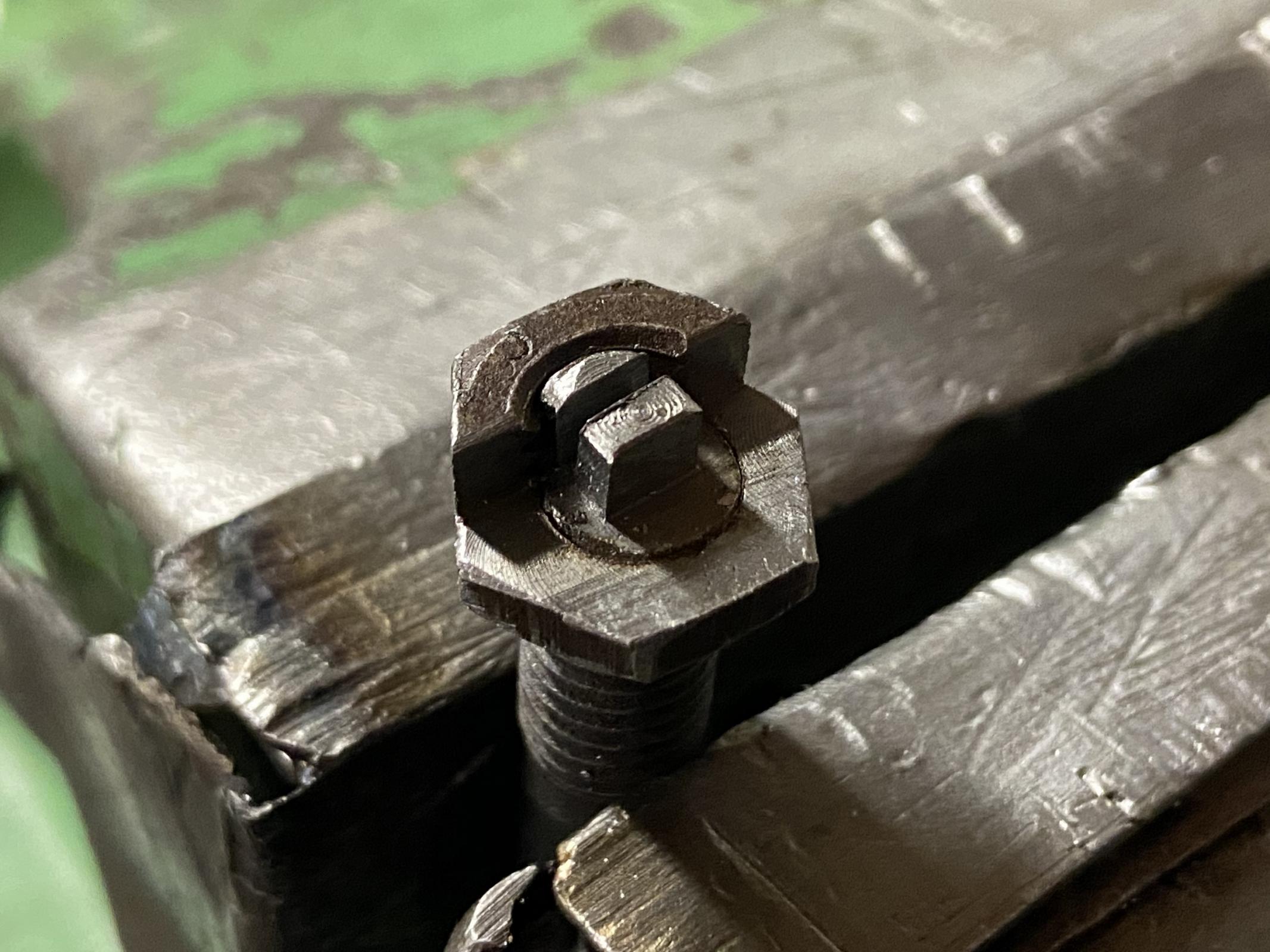

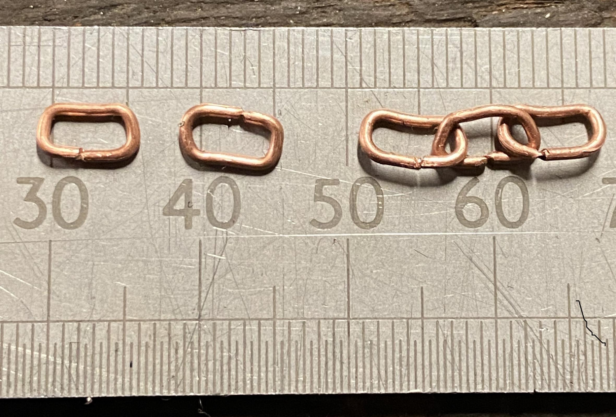

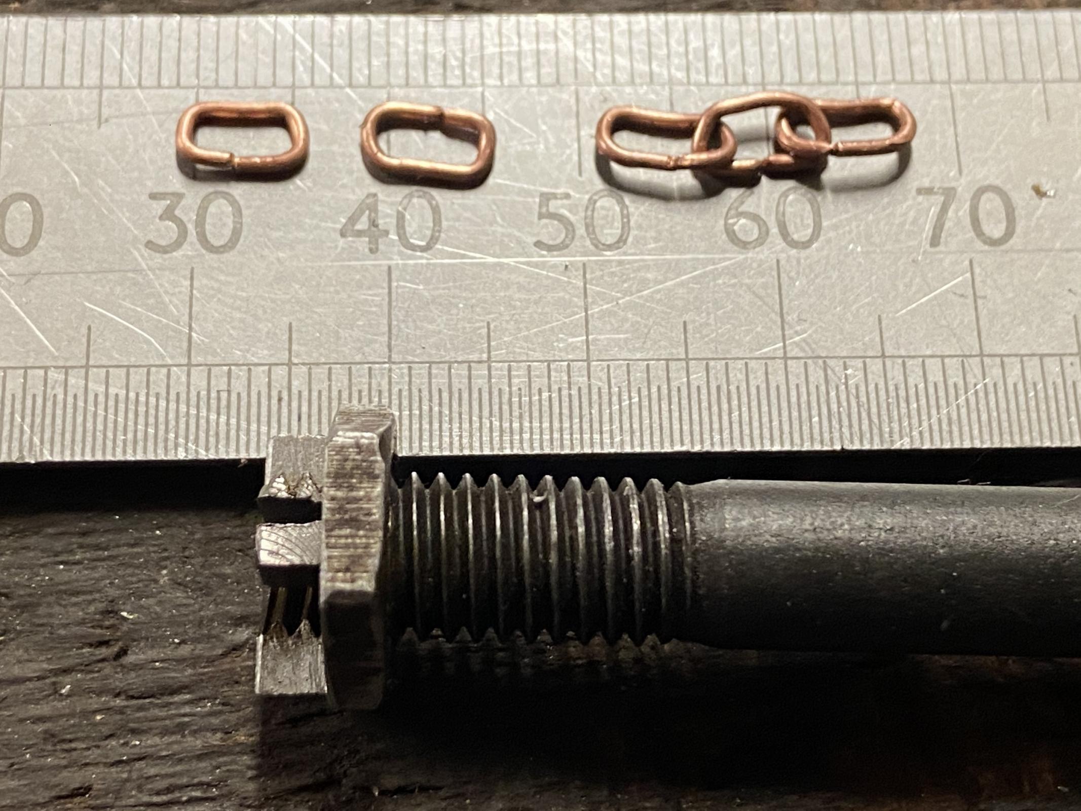

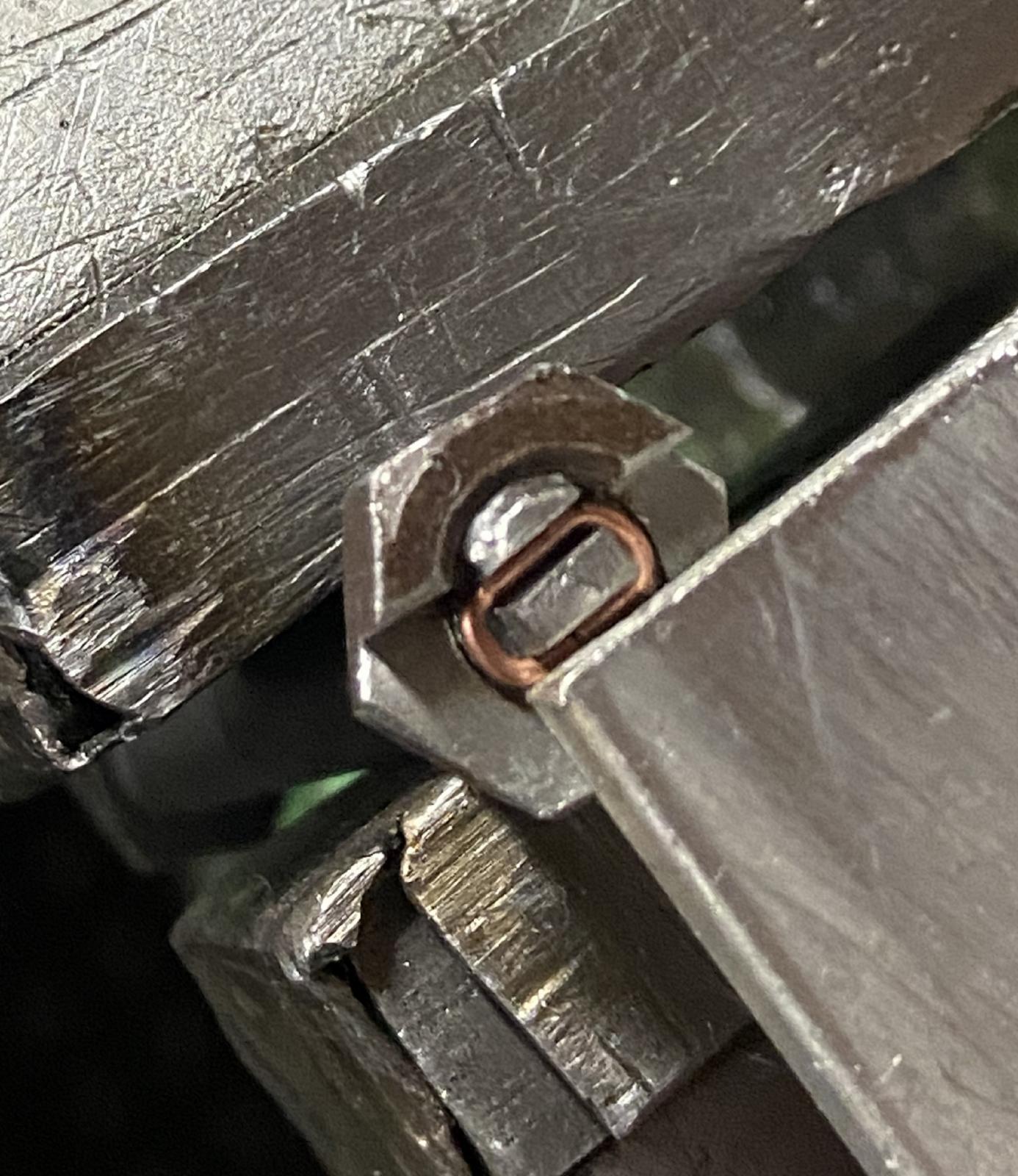

    After seeing this thread by kess (supporting member) Wire Bender I had a moment and thought about adapting this style of bender to make chain links for my 1" scale traction engine.
    I decided to use a M8 (5/16") nut and bolt to make the bender as the links are only 6mm x 4mm (1/4" x 5/32") made from 1mm (0.040") copper wire. The following photos show the first few test links and the method used to form links.
    Wire bender for making small chain links for model traction engine steering chains-img_4432-nut-bender.jpg
    Bender made from M8 nut and bolt

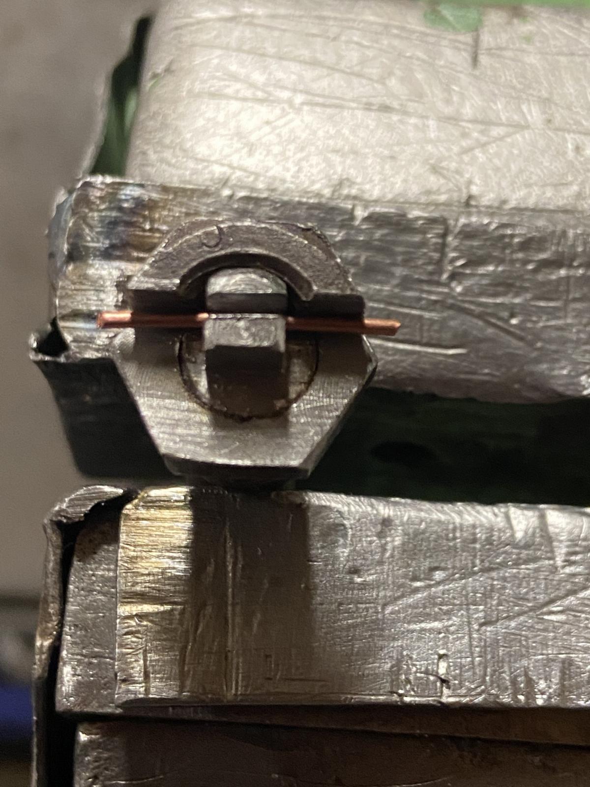

    Wire bender for making small chain links for model traction engine steering chains-copper-place.jpg
    Copper cut to length ready for forming

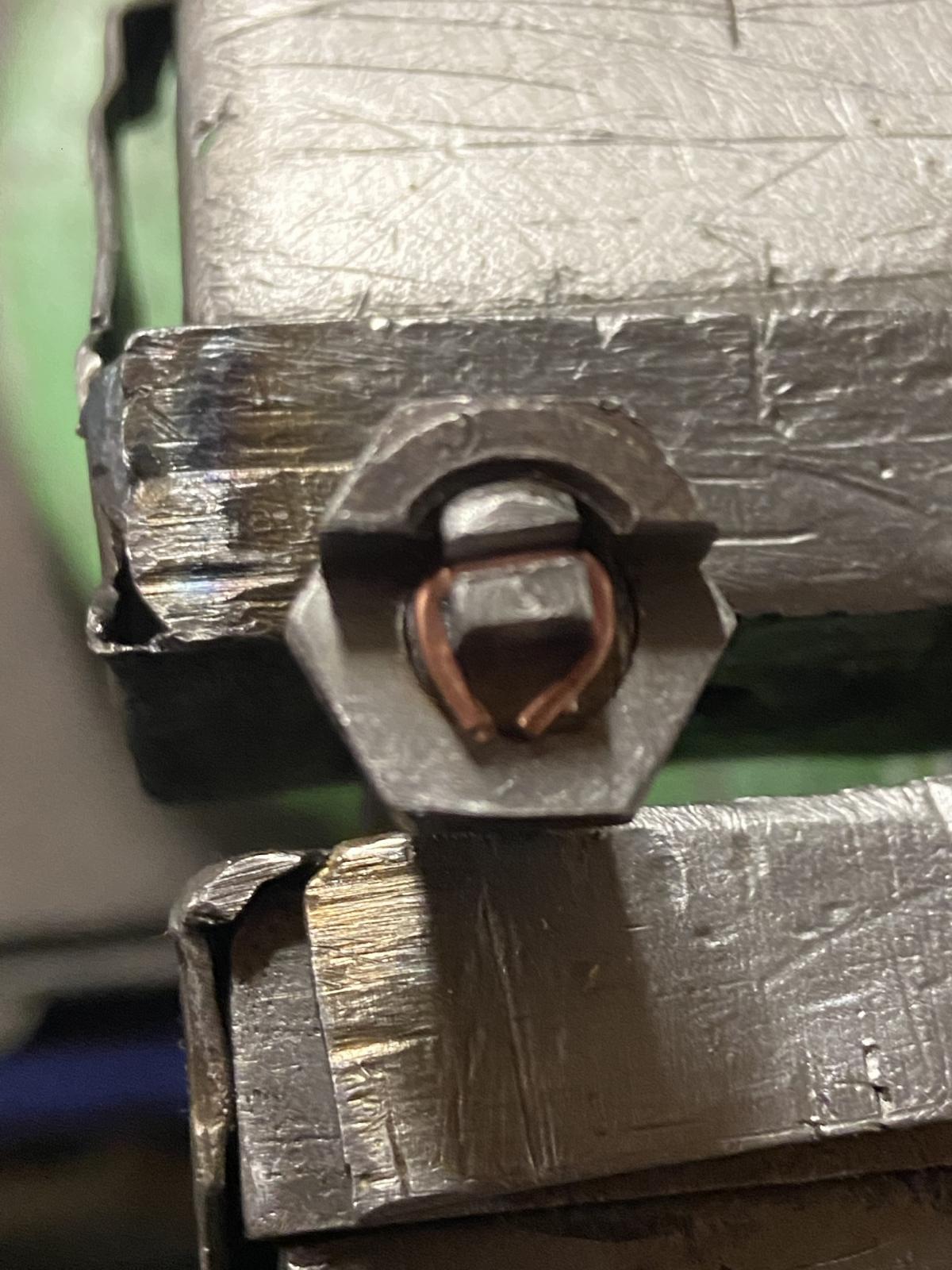

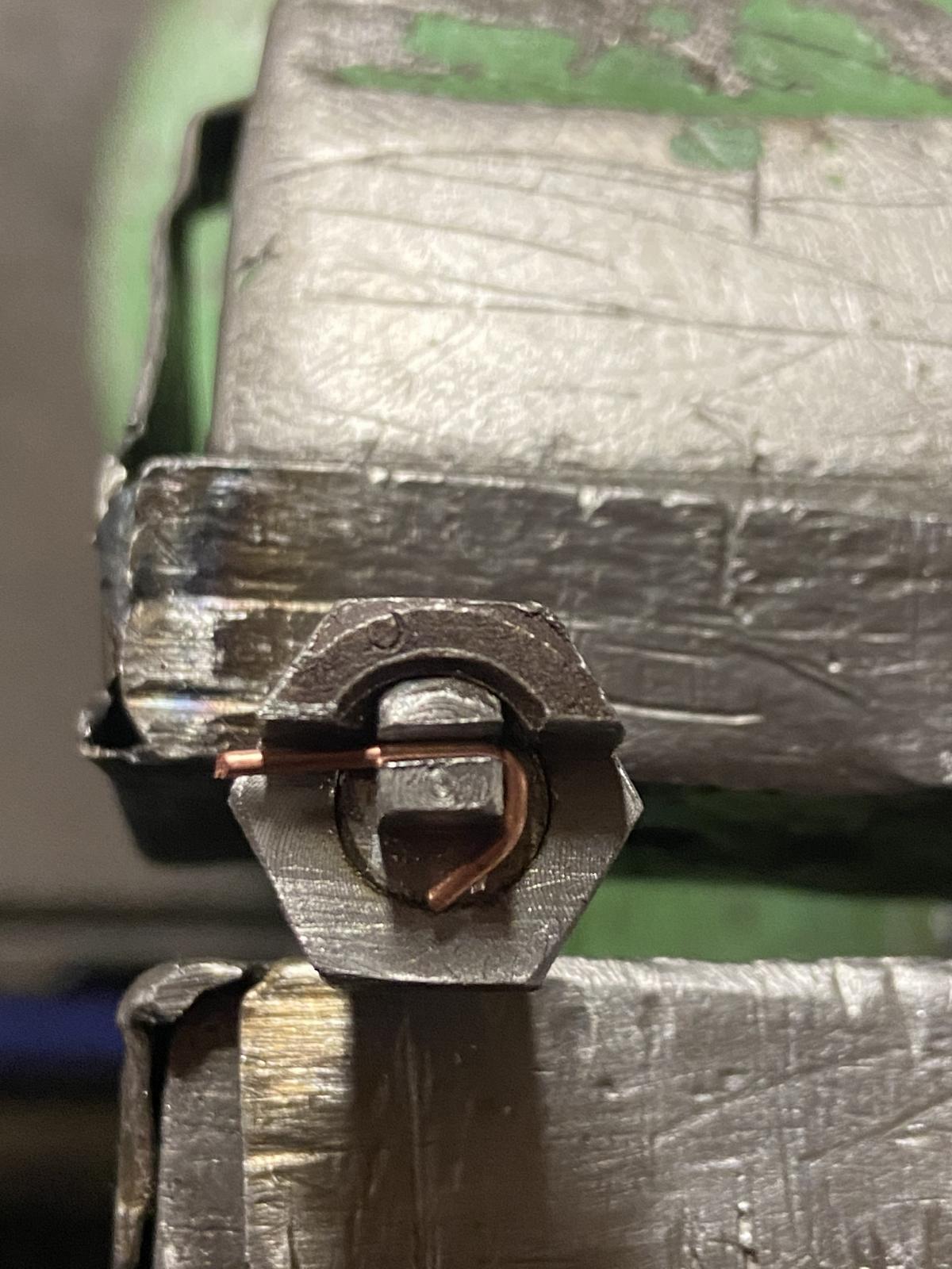

    Wire bender for making small chain links for model traction engine steering chains-img_4434-first-bend.jpg First Bend Wire bender for making small chain links for model traction engine steering chains-img_4435-2nd-bend.jpg Second bend

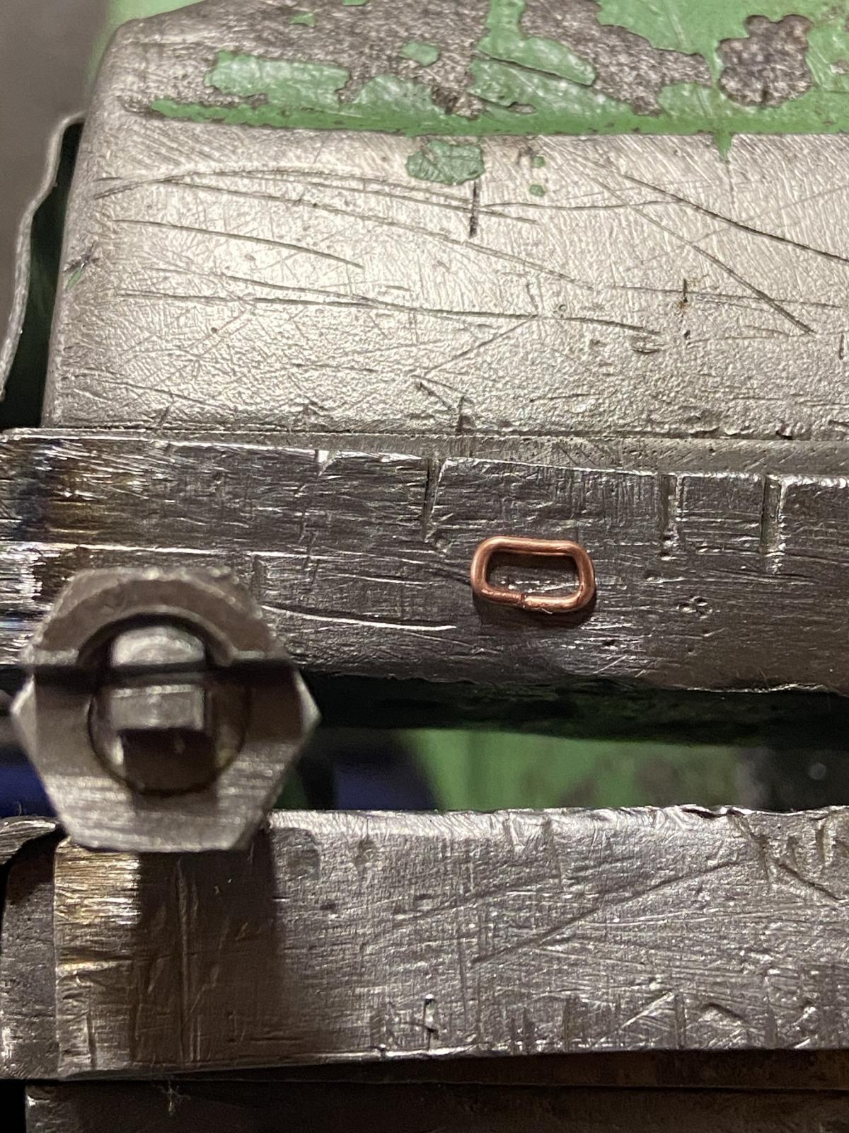

    Wire bender for making small chain links for model traction engine steering chains-img_4436-closing-link.jpg Closing link with a piece of aluminium
    Wire bender for making small chain links for model traction engine steering chains-img_4437-completed-link.jpg Link removed from bender

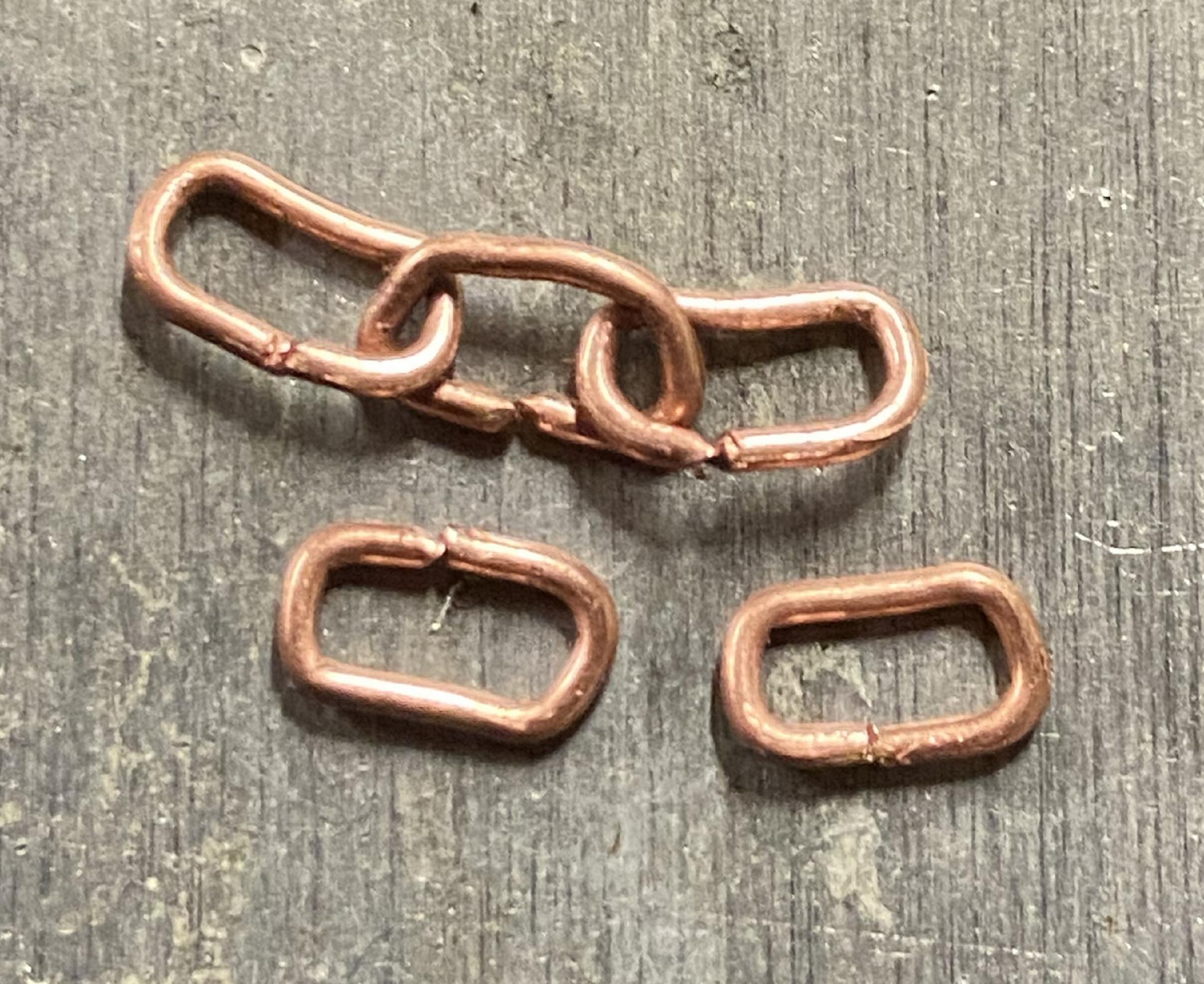

    Wire bender for making small chain links for model traction engine steering chains-img_4440-links-tool.jpg Wire bender for making small chain links for model traction engine steering chains-img_4438-test-link.jpg Wire bender for making small chain links for model traction engine steering chains-size-link.jpg First few test links
    The links will be silver soldered at each joint. As there are quite a few links needed I am in the process of designing and making a guillotine to cut the wire to a constant length.
    I hope this thread will be helpful to anyone considering making chain for their model.

    That works really well. With your guillotine, if you make the blade shear instead of cut you will get nice square ends on the links.
