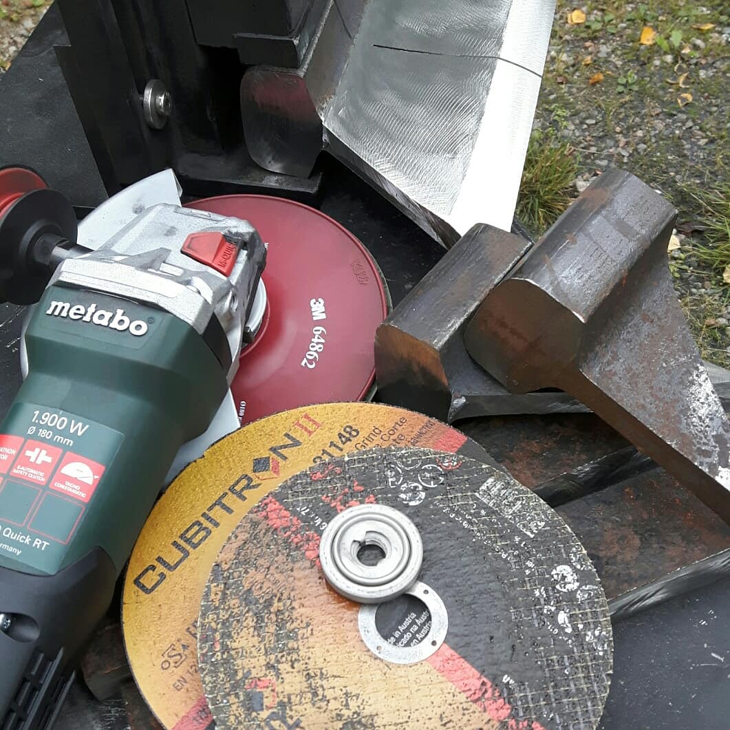

    An amassing build. I own 8 angle grinders 2 9 inch a 7 inch 1 5 inch and the rest are 4 1/2 inch all of them have different types of grind wheels, cobs, brushes, and sanding disks on them I figure that I would wear out everyone of them trying to grind away that much materiel.
    I must say you have perfected the art of using an angle grinder.
    Thanks Frank.
    I used one 1.6mm cut off wheel.
    Partly one 2mm cut off wheel
    One 36 grit fiber sanding pad and partly one 60 grit.
    Partly one 4.5mm grinding wheel
    And just a little from one 80 grit flap wheel.
    Four 40 grit sanding drums..
    About 10 pcs different grade sanding pads for finishing.
    All those are 3M Cubitron 2 brand.
    Didn't supposed to advertise, but those really lasts well.
    Price for the used accessory is about 20 $.
    Of course these sanding backing pads costs more than that 20$
    But i can use them in the future too, so i don't count them.
    https://www.3m.com/3M/en_US/company-...94857497&rt=r3
    For sanding grooved parts i used these softener pads between sanding paper and pad.
    https://www.3m.com/3M/en_US/company-...8710948&rt=rud
    We use those at work too, those are great when you need to finish interiors of the round objects. It follows grooved surface and sands from larger area.
    I got those 3M products for free, but i checked that when bought price would be around 20 $ for the accessory used. 20-30$ more for the pads and backings.

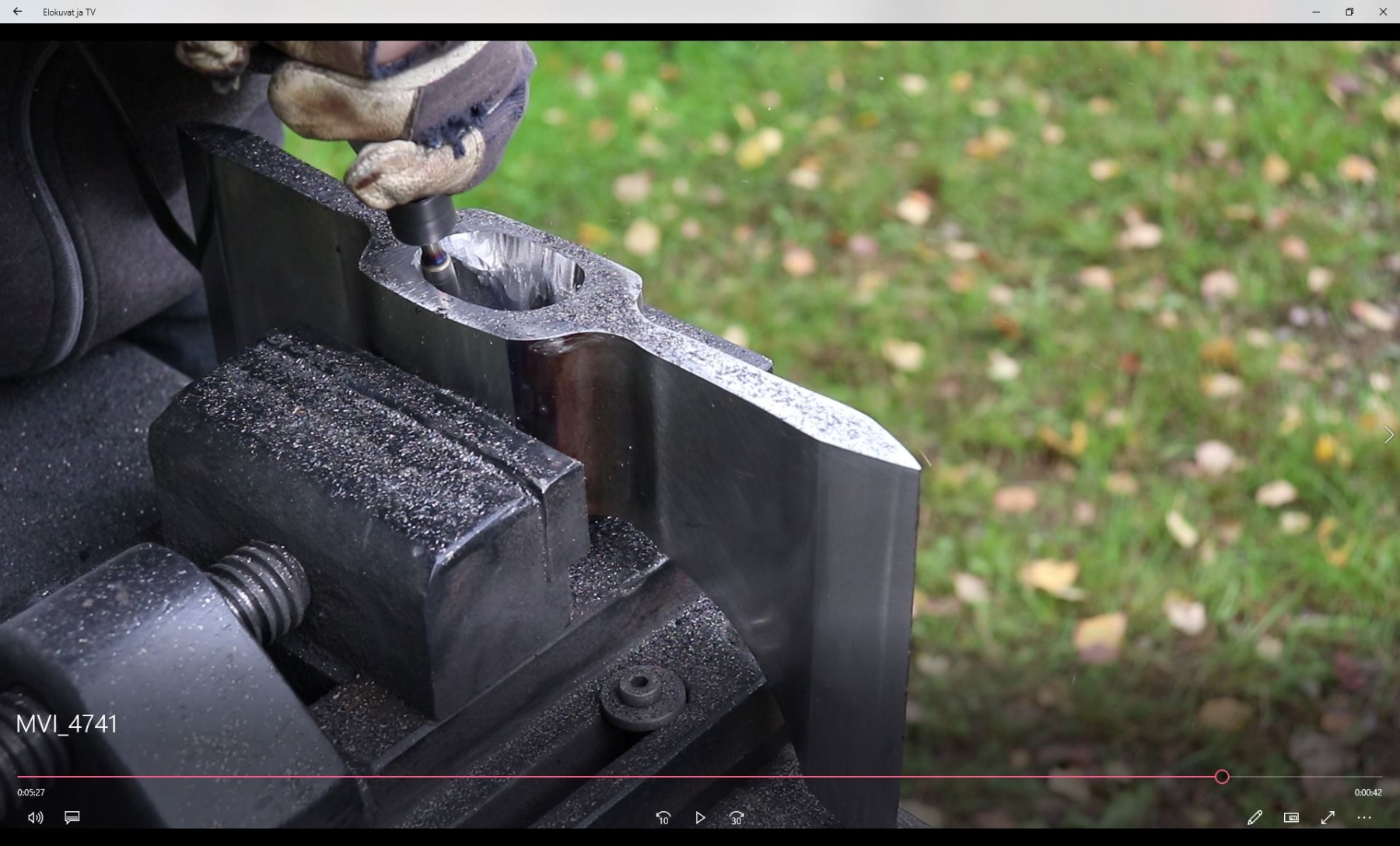

    Nice axe, and great finish, I hadn't thought of doing it that way. If you don't mind a suggestion, on the handle, or any wood handle for that mater, leave a little wood above the head, just a 1/16" to 1/8" sticking out. It'll basically make sure the handle never gets loose. Wood fiber has a spring back and the little sticking out expands and helps lock the handle in the head.

    Here we use this kind of method..
    End of the axe is shaped to cone, spline spreads the end of the handle against that cone shape. Spline is secured with epoxy.
    It gives firm and solid connection. Videos are allways tricky, i passed that point too fast.

    That will certainly help, but with use and moister changes in the environment it can work loose as the wood fibers compress over time. It will still work loose, not off. Took me a while to figure out, but after talking with a blacksmith well known for his hammers and axes I haven't had any more issues with a head getting loose. Leaving a little sticking proud of the eye is just an additional lock and added insurance. All of my axes and hammers have a taper at the eye, but if I don't leave a little wood proud of the eye they will work loose over time, even the ones I tried with epoxy on the end. Part of that is the high humidity we have here part of the time, and dry spells later. YMMV.

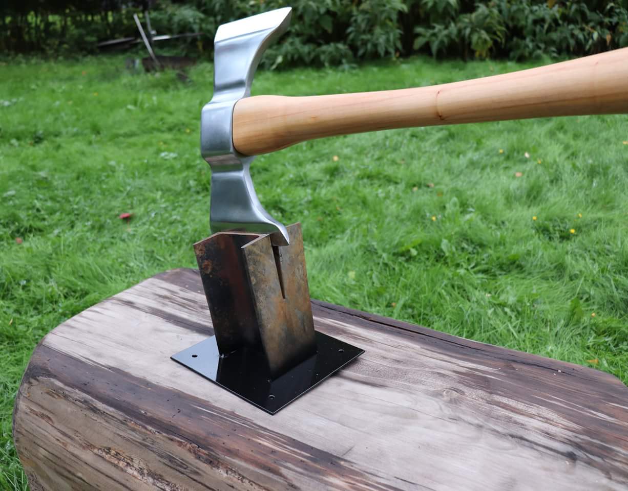

    Made a stand for it.
    Step 1. Cut 10" long piece of H-beam.
    Step 2 . Smash axe to one end of it.
    Step 3. Weld a little mild steel plate to other end of the H-beam.
    Very simple but working solution.
