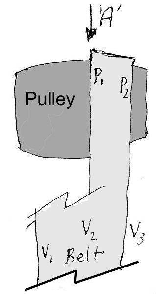

    Firstly, let us consider only a slice of half the width of the belt passing over just one side of the pulley as in Fig.1.
    Why flat belts need crowned pulleys.-pulley-1.jpg Fig.1. Click for full size.
    If we consider the linear velocities across the width of the belt, say V1, V2 and V3, shown near the bottom of Fig.1, we can see that they must be equal or the belt would be tearing itself apart. We known that is not happening. In other words the linear forward velocity of all points on the belt must be equal.
    Now consider the circumferencial velocity of the pulley surface at points P1 and P2. Due to different diameters at these points it is obvious that P! has a higher velocity than P2.
    The only way that we can reconcile this with a belt which has a constant velocity across its surface is to realize that over most of the contact area between belt and pulley there is slip of varying magnitude.

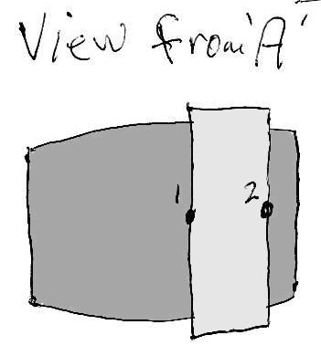

    Fig.2 shows us a view looking from "A" in Fig.1.
    Why flat belts need crowned pulleys.-pulley-2.jpg Fig.2.
    It is reasonable to assume that somewhere around half way between points 1 and 2 the belt and pulley surface will be travelling at matched velocities. So at point 2 the belt will be travelling faster relative to the pulley surface and at point 1 the belt will be slower than the pulley. This means that the belt will be trying to climb up the crown of the pulley, as in Fig.3. Think of a car in a curve, the outer wheels will be travelling faster that the inner wheels. The belt is like the car and the pulley surface is like the road surface.

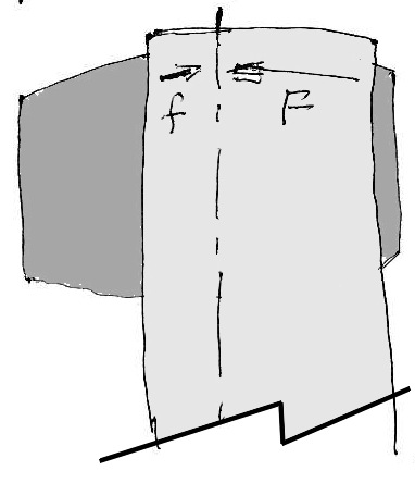

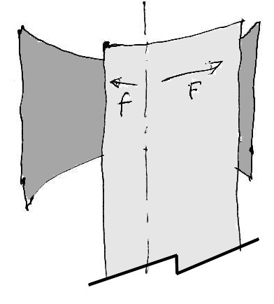

    Let us now put a new full width belt on the pulleys in place of our sliced belt as in Fig.4.
    Why flat belts need crowned pulleys.-pulley-4.jpg Fig.4.

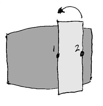

    Imagine that we did not put the belt on properly and it is a little offset to the right. We have seen that the crowned pulley produces a force tending to force the belt towards the crown. The wider the section of the belt on one side of the pulley the greater the difference in velocities between the outer edge and the inner edge and hence the greater the force. So in Fig.4 we can see that the force "F" on the right hand side is greater than "f" on the left side. This force imbalance will make the belt move toward the left until f = F or in other words the belt becomes centralized over the pulley. That is it automatically corrects any errors of alignment.
    This is in accord with our experience.
    Intuition often leads many (including me in my naive and inexperienced youth) towards the idea that a hollow pulley would centralise a belt. However, anyone who has tried this will have learnt very quickly that it doesn't work. Looking at Fig.5 we can easily see why.
    Why flat belts need crowned pulleys.-pulley-5.jpg Fig.5.
    As in the preceding explanation we can see that if the belt is not perfectly centred there will be unbalanced lateral forces acting on each side of the belt. This time the forces will act outwards rather than inwards as before. So when F > f as shown the belt will be flung off, which is exactly what anyone knows who has tried such pulleys. It reinforces any intial alignment error rather than correcting it.
    QED.

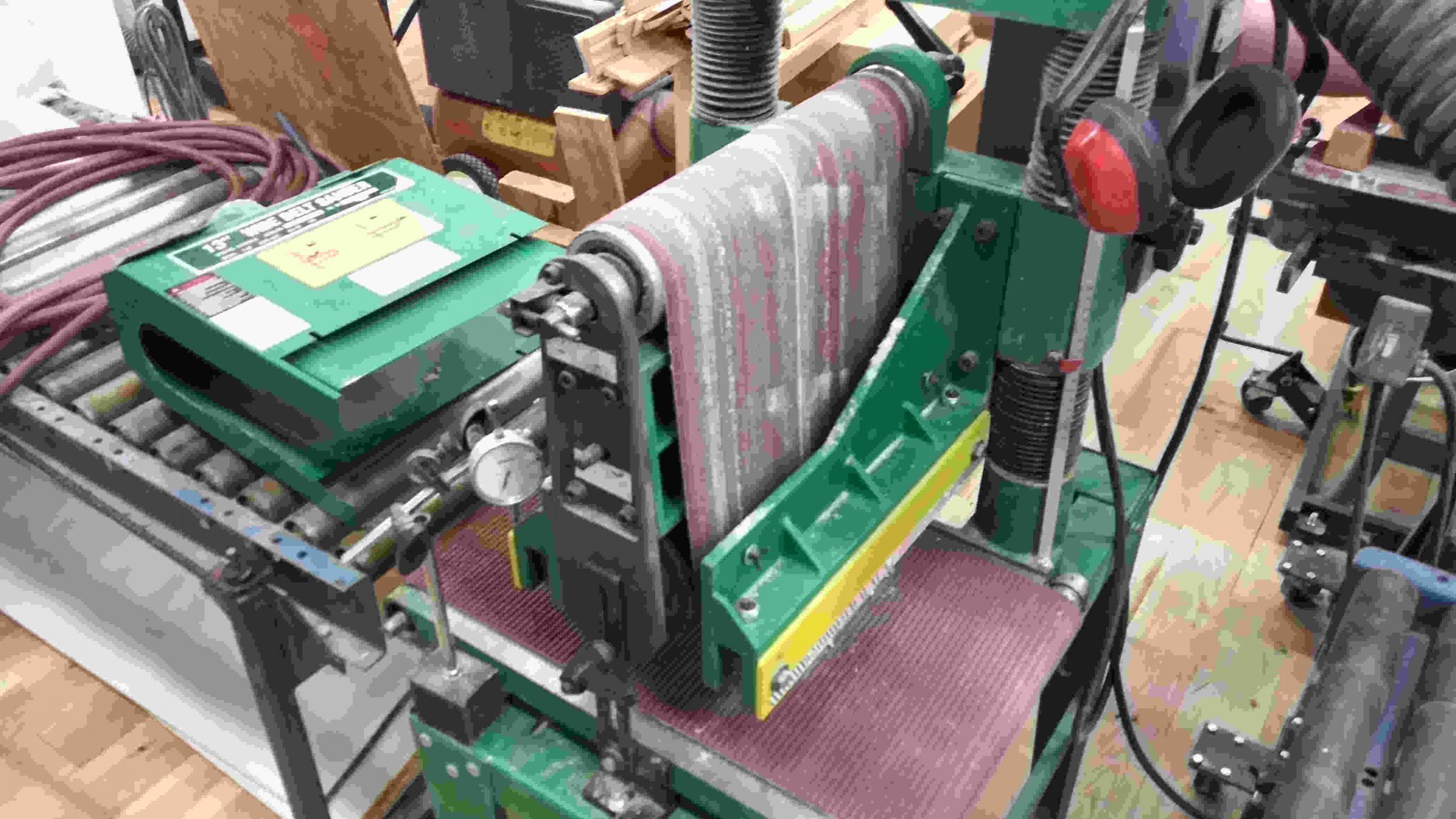

    Why crowned pulleys and bandsaw wheels?
    I had it saved as a link in my bookmarks.
    I have a 13" wide belt sander that will not keep track with a convexed crown, and even though theory says a concave crown fails, it did not......
    The "original" China copy had the idler pulley a smooth cylinder, no crowning, and the motor driven pulley that contacts the wood work piece a convex crown. Well that didn't work, as it made the board have a dish concave scallop along it's length, and depending on where you fed the board, it would remove so much material, it would be burned by the belt.
    So I pulled the whole thing apart and machined the pulley in contact with the wood board (sanding belt in between) to be a perfect cylinder.
    I used duct tape on the idler pulley to make the crown convexed originally. But whenever the belt got warm, it would take off from center position, and the sanding belt would grind the sides of the machine internals. I muttled with it this way for years. Then last year I stripped off all the duct tape, and tried it with a convex crown. That has worked reliably.
    There were a few other serious manufacturing design/manufacturing defects. The power feed belt they used, that had a drive roller and idler, however the idler support brackets were machine in the incorrect location, and it was at an angle to the table, essentially twisting the boards being fed in. The root cause of machining the hole in the wrong location, looks like a casting pattern that didn't leave enough material to put the hole where it needed to be, so they just located it .1 inch higher. There were several importers of the 13x32 belt sander. I got mine from Woodworkers supply, with the Wood Tec name brand. But Harbor freight imported them and others.
    I am not surprised that you had problems with the convex crown on the work wheel. Terrible idea.
    You did not describe your machine but I am guessing that you have 3+ pulleys. 1 on the motor, at least one idler and the work pulley. I would put the crown on the motor pulley.
    The only reason that I know that would require a concave pulley is if one or more pulley axes is/are misaligned causing a tendency to throw the belt one way, compensated by the concave pulley trying to throw it the other way, hence compensating. On wide pulleys such as on a belt grinder it only takes a tiny axes misalignment to force the belt one way. In fact some machines do not have crowned wheels, instead there is a misalignment adjustment with which you can use to make the belt track true. The misalignment works like one half of a crowned pulley and obeys the same rules.
    Glad that you have found a workable solution.
    PS. You mentioned the problem got worse when warmed up. Expansion somewhere in the system may be causing any slight misalignment to change. 13" wide belts only need a tiny change to act differently.

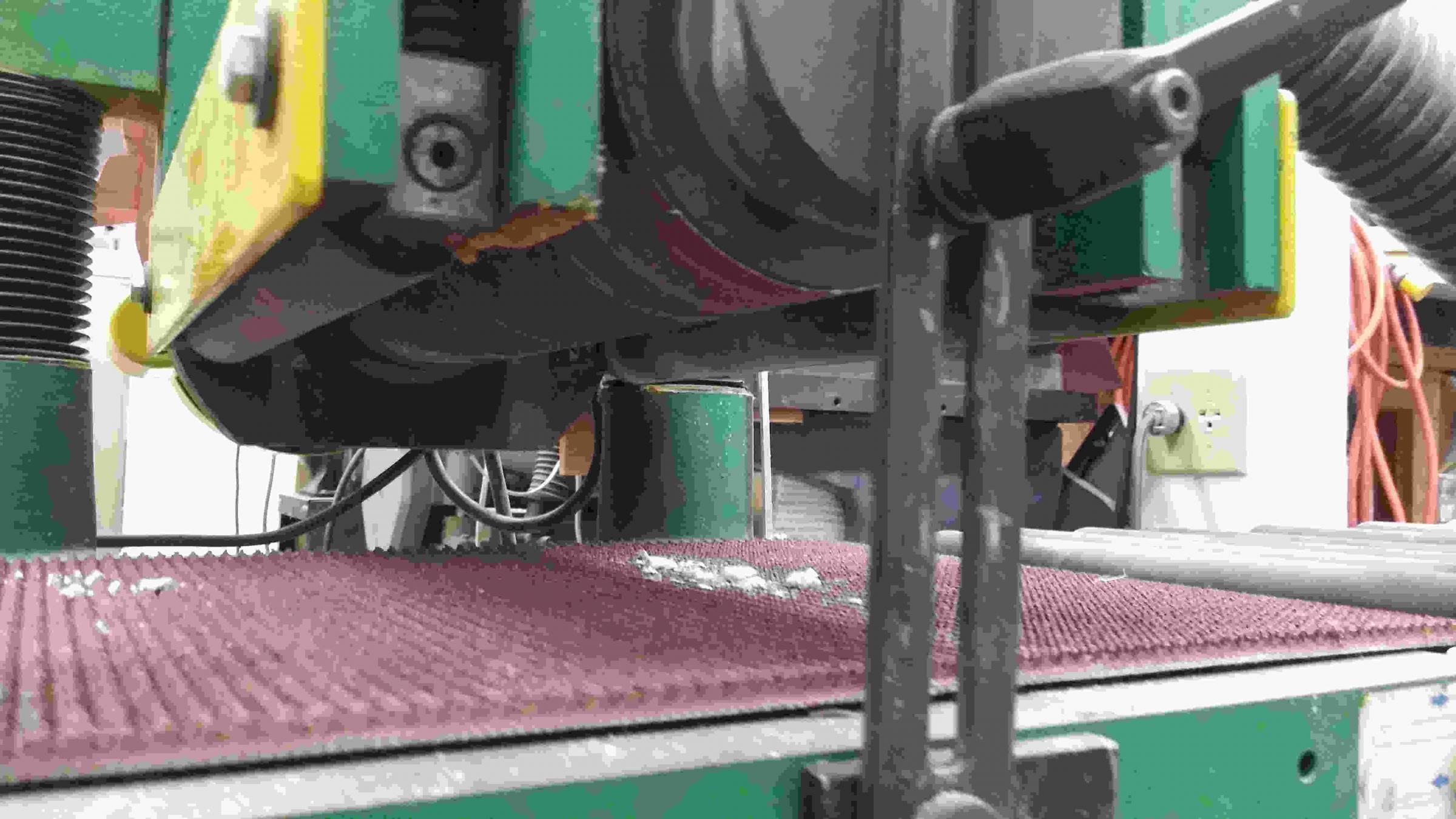

    What gets hot is the sanding belt, and elongates just enough to run away.
    However, by having the idler with a concave crown, the belt can only get so long, and it is captured by this trough.
    This is a two roller system;

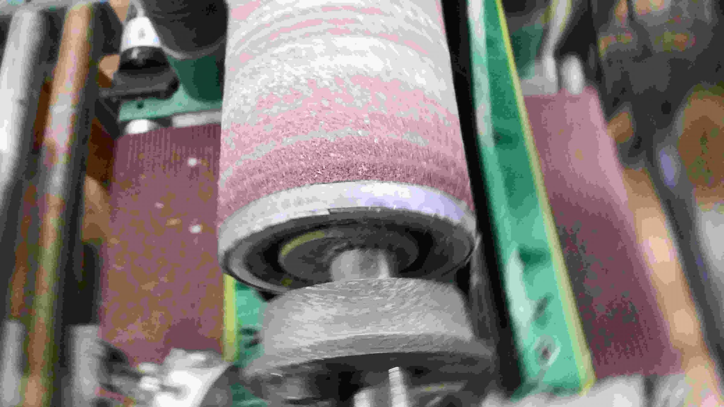

    Top roller edge showing duct tape. This is a stable configuration as the bottom roller has no crown. A convexed crown in this machine was unstable.
    Bottom view showing driver roller, opposite side of machine has 2HP motor with direct connection to this roller.
