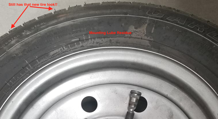

    That is caused by the wheel nuts not being tightened properly, one has come loose and started the others coming loose, whilst they have merrily kept driving along.
    Now with all that shaking and totally ignoring the vibrations and noise, eventually the wheel studs get chewed out,and or, the holes get flogged out and that is the end result.
    One of my 'brother's in law' had this happen to him, but he was too stupid to stop and check the car to see what the problem was.
    So this is what he presented the mechanic with.
    Ah well, I've heard tell that an "IDIOT is born every minute", eh.
    Oh, the tow truck driver took lots of pics and plastered them over the local community web, just to make sure he was totally embarrassed by his stupidity.

    Before I retired I worked 35 years in road construction. I have found dozens of tire/wheel combos like that one shown in the picture. Many of them
    with the new "tits" not worn off of the tire, apparently because the wheel was not properly tightened after installing a new set of tires. Every briar patch along the interstate highways has possible tire/wheel finds. Mobile home tire/wheel combos are scattered everywhere. I kept track one week while I was marking patches, and I found ten mobile home tire/wheel combos that week and I only looked each day during my 30 minute lunch break. I found a few 20 inch semi tires with the tube liner inside and the sticker still on the tread. How did that happen? I remember finding new looking Budd wheels with no tires on two separate occasions. There's treasure along our interstates!

    That tire looks to me like it was just installed on that wheel.
