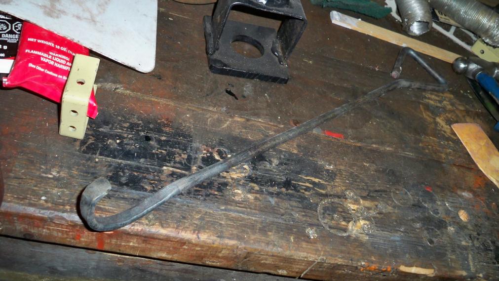

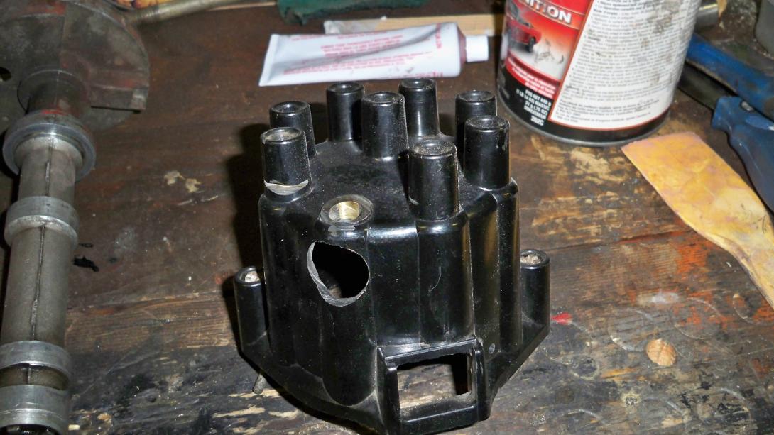

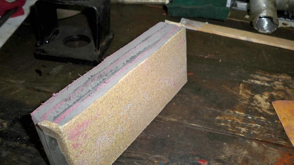

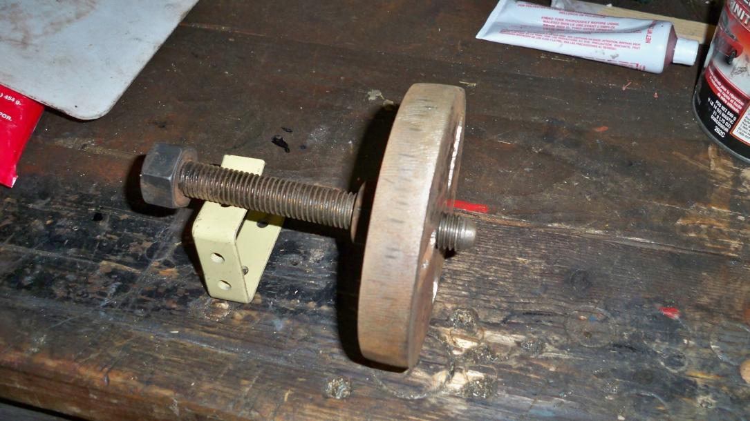

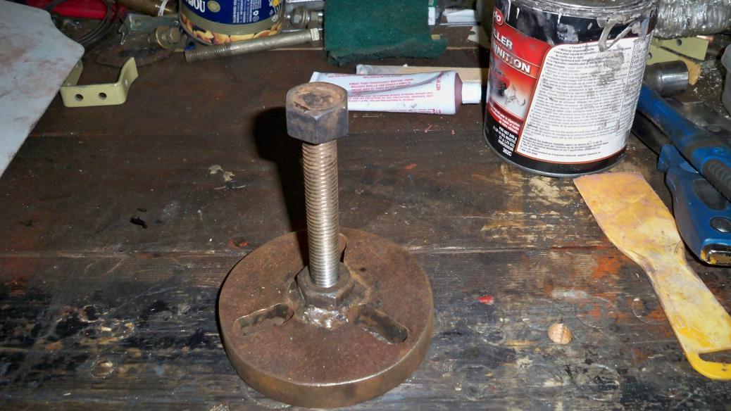

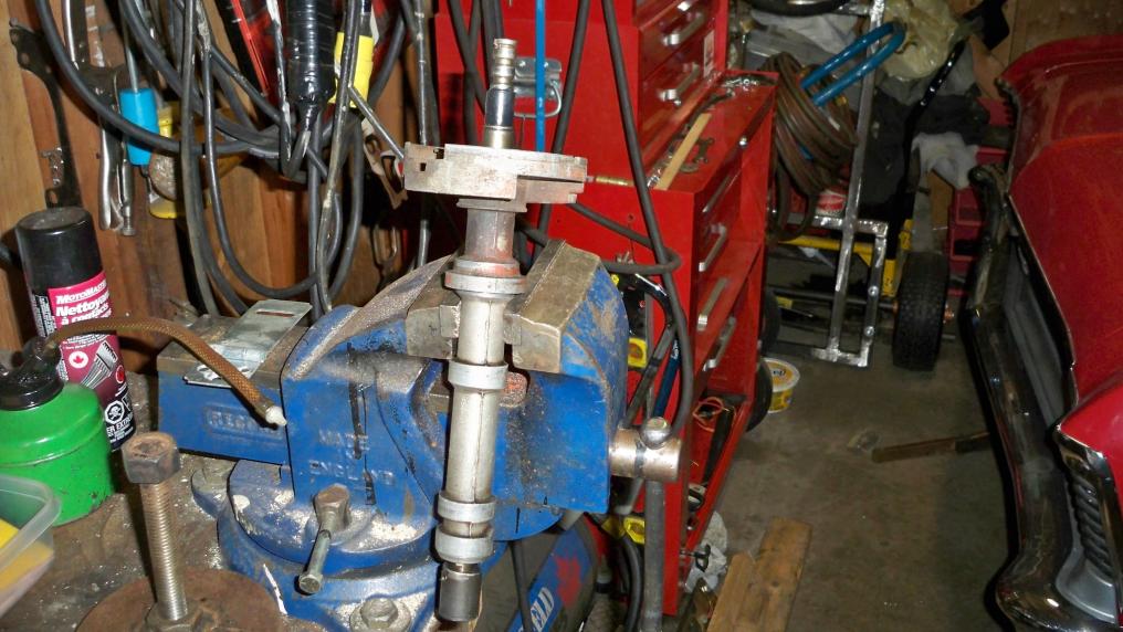

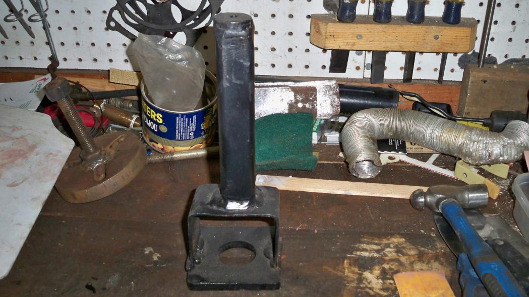

    Puller for harmonic balancer from scrap pile and bolt and a seal and bearing race driver also from the scrap pile.A piece of half inch round rod heated,flattened and bent used for a body pick for working out autobody dents in hard to get at spots.the stripped down distributor can rotate the engines oil pump(slot)to aid in placing the distributor.A slot cut in the top of the shaft indicates exactly how the slot in the pump is sitting.Also can be spun with a drill to prime engine with oil prior to startup. The drilled distributor cap is a visual aid for checking location of the rotor when engine is on its timing mark,helpful to verify if its on the compression stroke.Sanding block is 3 pieces off of a snap together rubber floor tile glued together ,just gorilla tape sandpaper on and sand away,Make a long one for flat surfaces.
