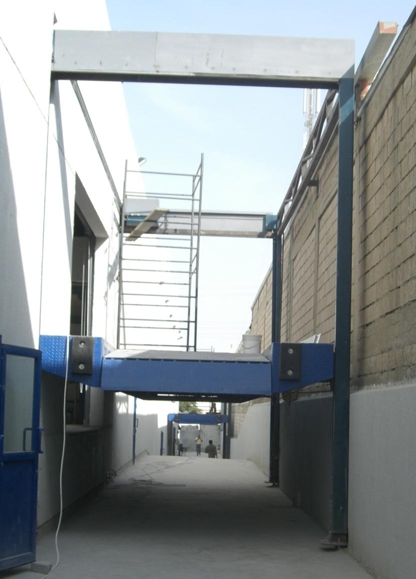

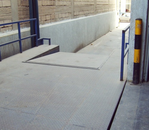

    IS you rdock board going to be spring loaded self leveling or hydraulic leveling?
    Imade this lift with 2 dock levelers in it one on each end of the platform 2 forklifts at a time could load and unload from 2 trailers in an alley then drive in the door
    If need be the platform could be raised with both loaded forklifts then a trailer driven under it

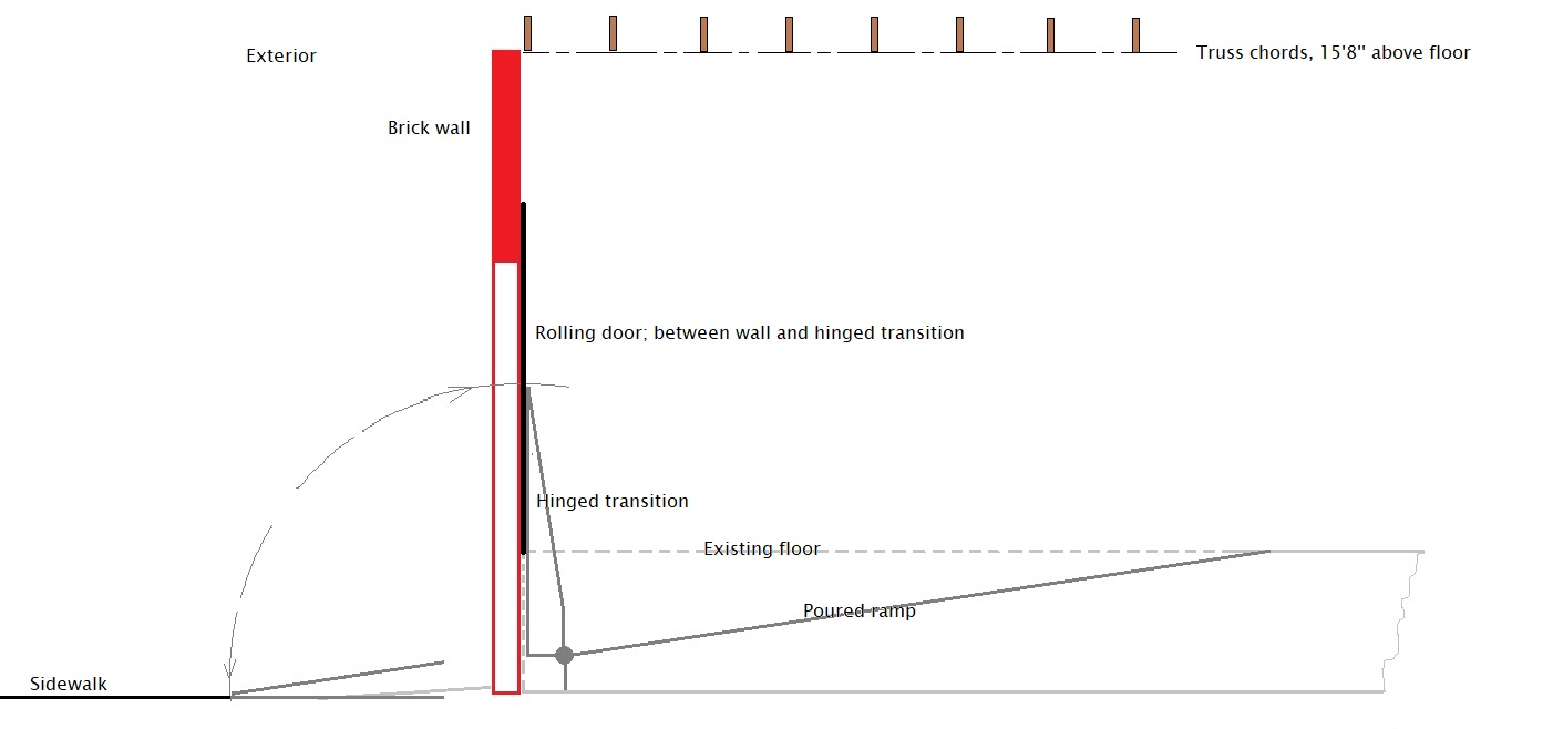

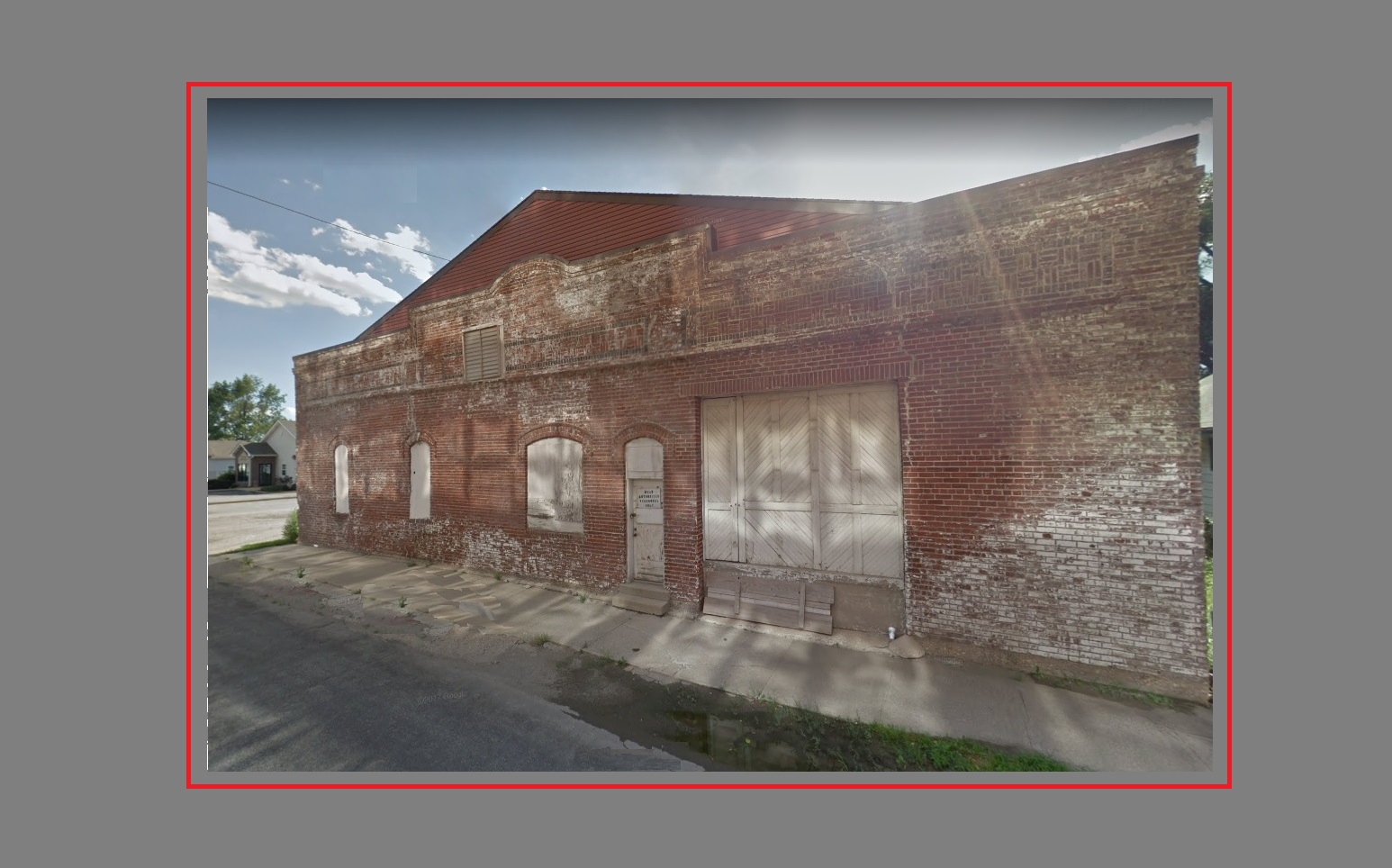

    I'll do a drawing on the access ramp project. Its to enable road vehicles enter from street level at grade across sidewalk. Been thinking how to close threshold under rolling door. I think the angle needs 18' run for loads to clear raised door, and truncate at the inside 'jamb'. A second hinged ramp would connect grade and truncate end. Like a lift gate or WWII landing craft ramp, just not olive drab, 11 tons, or any opposing troops! Same exterior wall, east as post #2, What would be your dream build-ramp.jpg
    Different than load ramp, also needed eventually. I'd thought of articulating ramps, there were some removed from a warehouse, too $$ intense for rare use. Instead, a portable board with rectangular forklift eyes. When building was erected, truck-beds were lower. Sometime back the rear of the structure was torn down and a concrete ramp poured from existing floor to modern flatbed height, it's 20' long and 8' wide. West wall redone in cinder block and rollup door. I have a pair of bolt-on sturdy rubber stops, and vertical ladder dockside for the driver.
    I like the Kuwaiti solution but haven't their deep pockets. Be nice though, preserve flat floor when truck isn't indoors...Hate to guess cost of excavation, cylinders, pump, hoses, hinge, locks and switchgear to level 60 or 70k lbs.

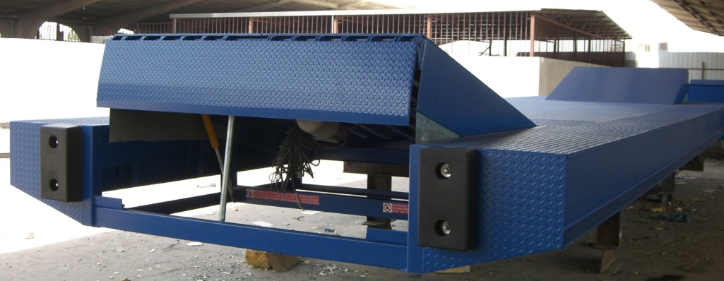

    At one of the new retail big box establishments that was being built in Kuwait they had a similar requirement limited vehicle access to the inside of the building plus the need for dock high unloading the floor was about half a meter above street level too high for a simple approach drive apron given the minimum required set back and too low and too short to pit a dock ramp for the same reasons. My solution was to have the contractors pour a recessed pit under 3 of the doors then We manufactured 3 8 meter long 3.5 meter wide hydraulic ramps which when all the way down allowed traffic to drive in or out or when raised to full height they became loading docks when at rest level they formed the seal for the doors and the lower part emulated the look of the slab You couldn't tell from outside when the doors closed that there was even a possible way to access the building.

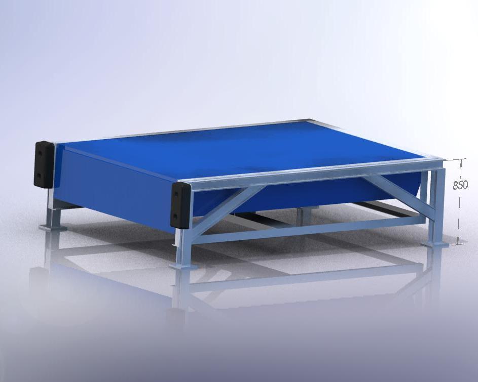

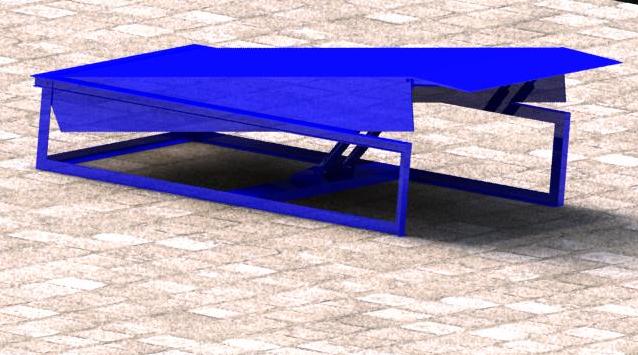

    I still have the drawings for hte 8 meter units but never made jpegs of them these are of a 2 x 3 meter ramp the application would be the same only scaled
