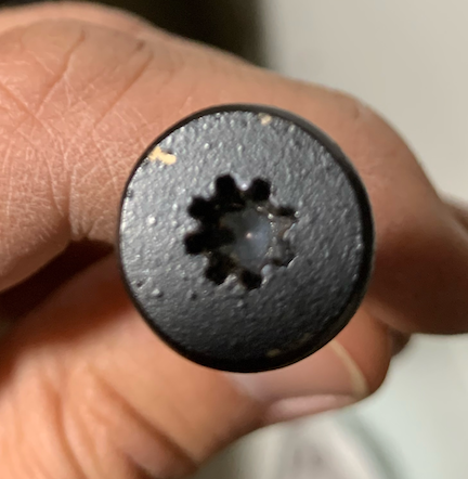

    What is this screw head called? Was able to remove them using a #2 ECX screw driver bit, but that only engaged 2 of the slots. Never saw this before.
    What is this screw head?-screw-head.png Name:  ECX bit.png

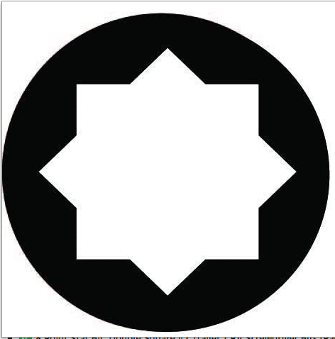

    It is called a vega double square or 8 point star bit some trailer manufactures use them in an effort to make their products Pro priority items. It is also said that the drive bits hold the screws better for production runs

    I work on trailers, and have bits for this kind of double square,
    But they do not fit this head correctly

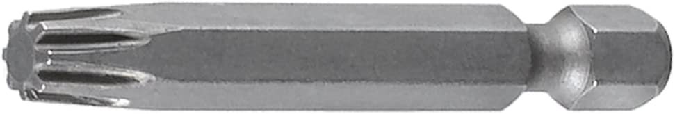

    Found it
    headloc spider bit
