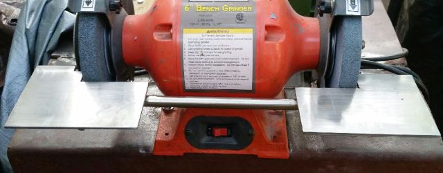

    Today I got up and looked at the extension cord first thing and discovered that a sliver of metal had fallen into one of the sockets and I happened to touch it while putting it away. I took the box apart and tidied all the connections up anyway since it's been needing doing. Next I jumped on to my bench grinder tool platen project and finished it up in not that long. It'll be a boon to my tool grinding efforts because my hands aren't that steady and my eyes aren't that good these days.

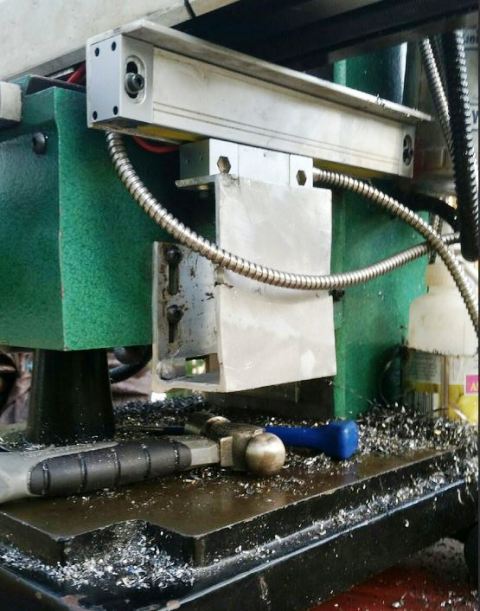

    Then I started again making a new Y axis DRO reader mount that allows access to the Y axis lock down bolt so I can make better cuts. To my surprise and pleasure my welding clicked today and I was able to finish a new mount that will fill the bill. This project was notable to me because
    1. I made it for free using bona fide scrap from my bin
    2. I can now lock down the Y axis when making long cuts and I'm sure that better milling will result
    3. I made my first successful TIG welds in aluminum and they looked acceptable after grinding off the globs. Nowhere to go from here but up and though it's still not anything to write home about I can make more things out of aluminum now.

    I've already worn out one Lincoln SST brush and need to go buy a couple more. I degrease with acetone too and it helps. For tips, I bought a bag of 30 preground Lanth tips on Ebay (ground at each end) and I've used and reground all of them at this point and now many are getting too short to use. Guess a good handle for me is The Big Dipper, though I don't do the walk of shame to the grinder any more (because I moved my grinder next to my welding table ☺). My biggest problem right now seems to be getting a good starting puddle that bridges both surfaces - when I do get one I can run the weld more or less normally but most times I find that my puddle has only fused properly onto one of the two surfaces and often I'll overheat the material trying to form a good puddle. If I can get my start sorted out I should be able to improve my welds considerably. I did figure out that since I'm welding outdoors I have to really crank my Argon flow up and keep the torch almost square so that I get enough shielding and no bug holes. I've noticed that the recommended current setting of 1 Amp per thousandth of material thickness is too much heat and will bloop the joint quickly so my best guess is that my current markings aren't accurate.

    The bracket that I made was from .190" thick stock and I finally settled on 140 amps being a good setting for it. I do have a foot pedal and I'm starting to think that I need to develop better skill at using it in response to the appearance of the puddle, but learning to simultaneously maintain a constant tip distance and travel rate, feed in filler rod at the right spot and times, and dynamically control the heat is a considerable trick for this old dog to learn.
