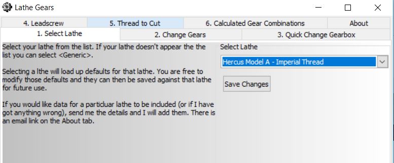

    I think its great
    Hello Murph,
    I have found it to be an incredibly useful program over the last couple of years.
    Work your way through the tabs starting at tab 1.
    If your lathe is not listed then use generic lathe on tab 1.
    Discussion here might be helpful for you Metal Work Forums
    Bill
