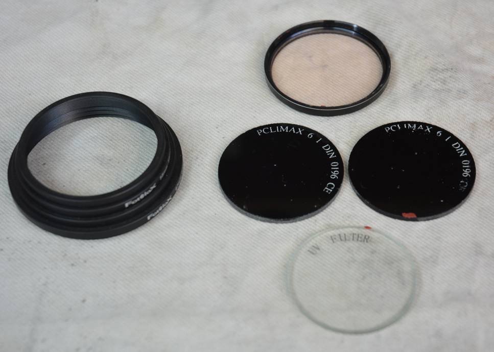

    I wanted to make some video shots of MIG welding for a tool making video but I had never done this before and I didn't want to destroy my camera. I do not know how easy it is to burn the sensor.
    I thought that for safety sake I needed to hold a welding helmet filter in front of the lens. I did not not want to spend much time on this and to mount a typical rectangular filter looked to be too much work, but then I wondered about the circular lenses from gas welding goggles. I quickly discovered that two filters gave about the same light attenuation as a typical electric welding filter. My luck was running well and got even better when I discovered that the round filters were a perfect fit into a 52mm camera UV filter that I had from my film photography days. My camera lens has a 67 mm thread so I made a stack of reduction rings from 67 mm down to 52 mm, installed the UV filter followed by the two welding filters also followed by a welding UV filter.
    It worked, the videos came out nicely and the camera still functions.
    Welding videos-videofilter02.jpg Click thumbnail for full size images.
    The components.

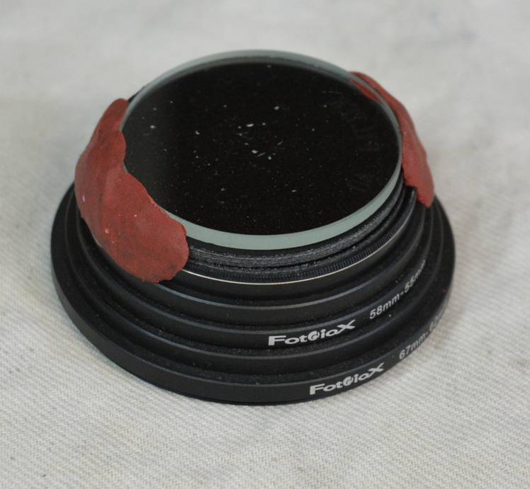

    Filters stacked. Some plasticine holds it altogether.

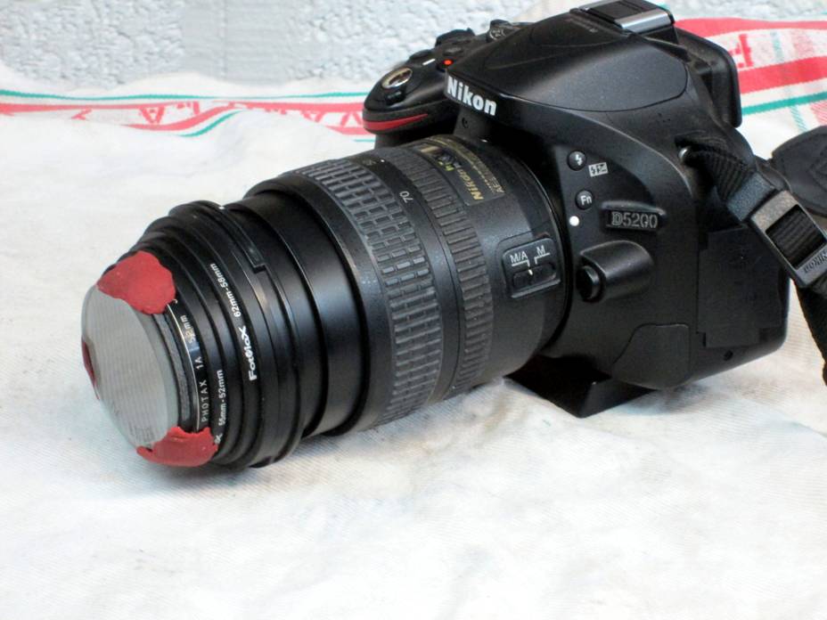

    Fitted to the camera.
    I expect that there are several people on this forum who have videoed welding and I would love to hear how others have done it. Videos on the net seem to vary a lot regarding quality and brightness so I suspect that some people just use a naked camera ????????

    Maybe I wasn't clear but I did put the dark lens on the clear one. It was basically a no work solution, I had to make nothing.
