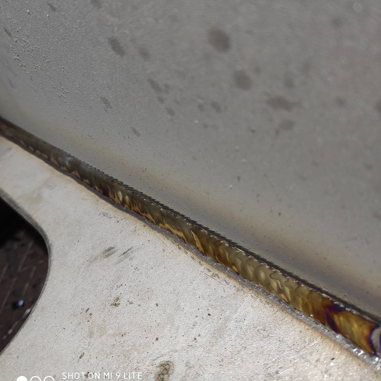

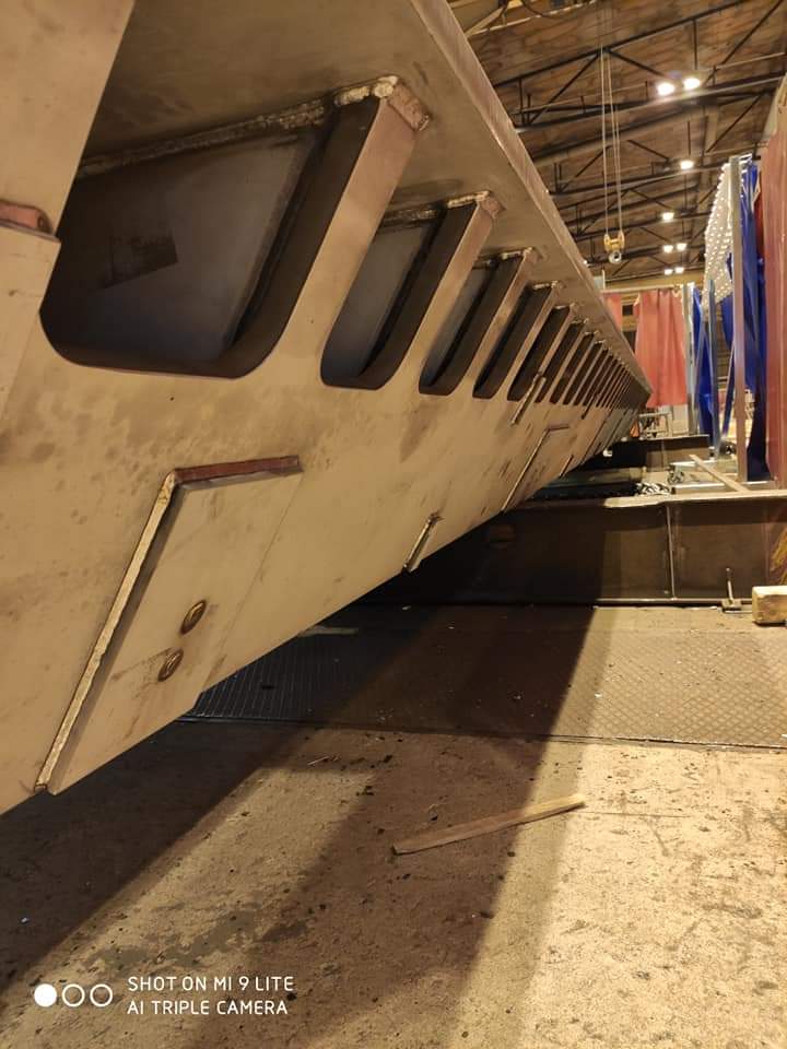

    Here is some pictures.

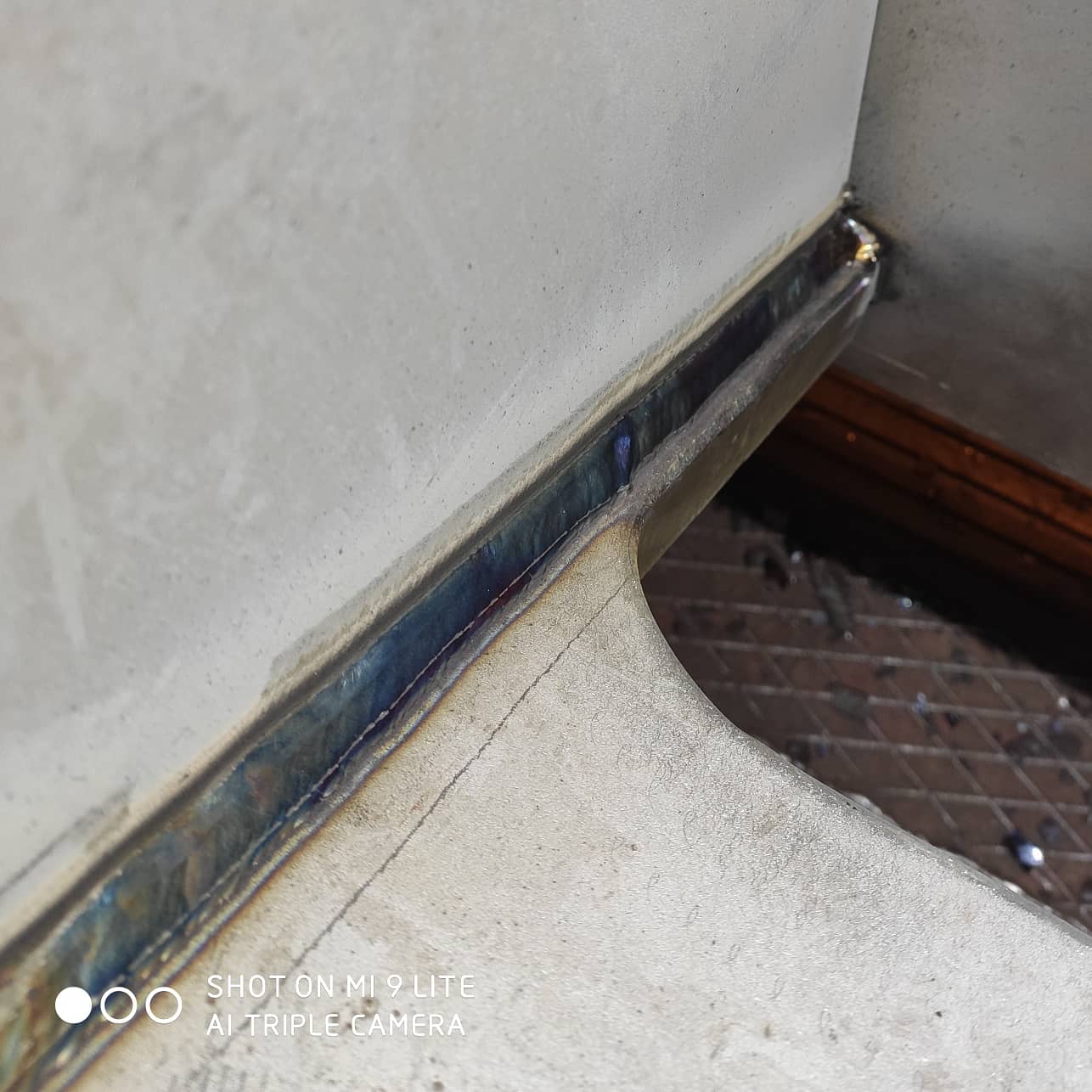

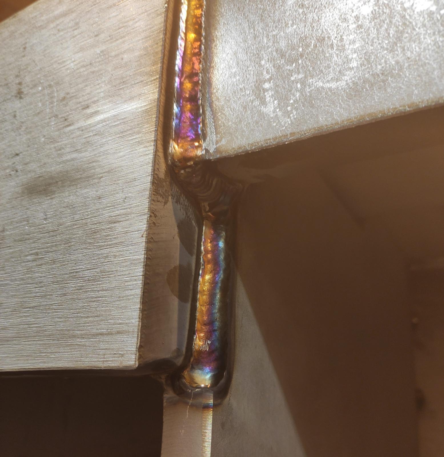

    Some vertical welds.
    Difference between right and left handed vertical welds can be seen..

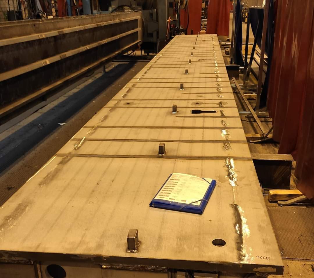

    After welding, frame was flame straightened to 2mm level.
    Finished frame was shrinked 15mm shorter than it was build.
    This needs to be considered at the beginning, otherwise it happens that there is no enough machining allowance.
    Drilled holes goes thought heating water casings, or something like that..
    Build has several water casings, to heat and keep frame straight in use.

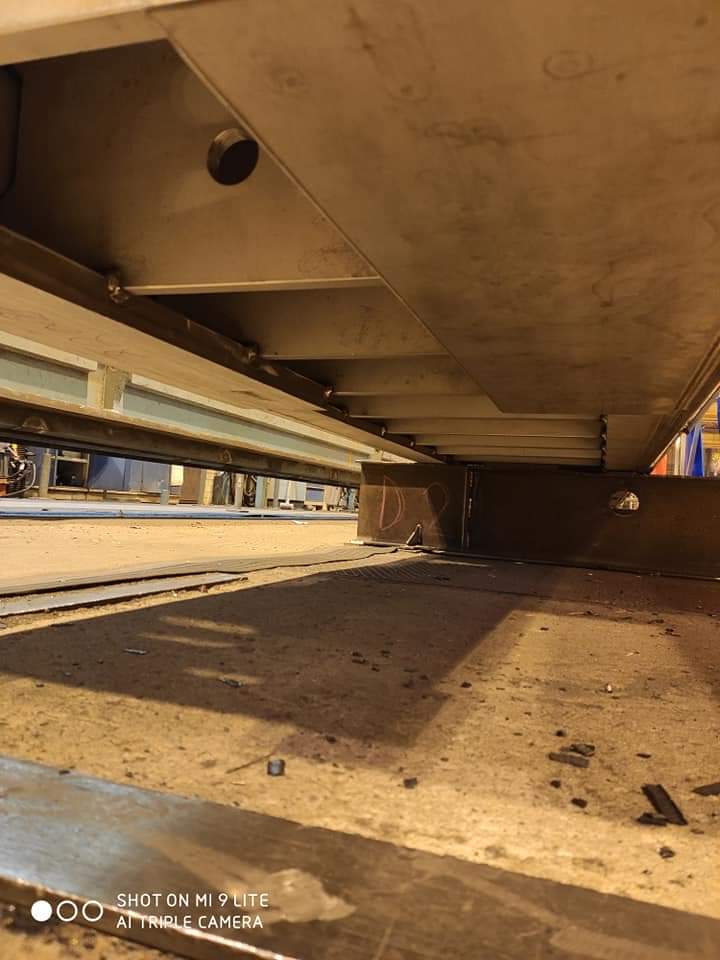

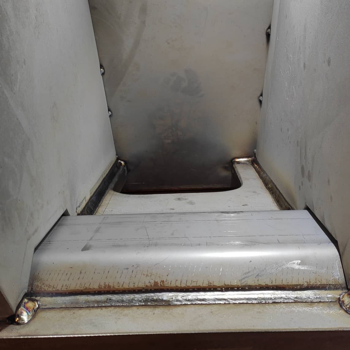

    Here's another tight place.
    Those welds are in "upper hull frame" in paper machine OptiFlow type headbox.
