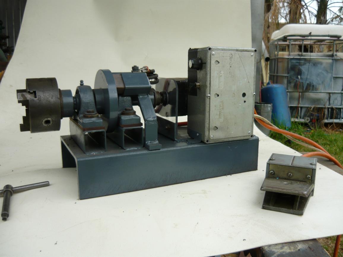

    Welding rotator
    [Welding rotator-p1000663.jpg Welding rotator-p1000664.jpg Welding rotator-p1000665.jpg

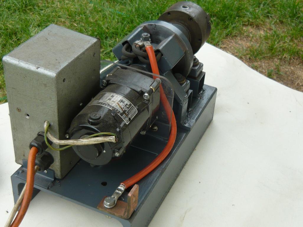

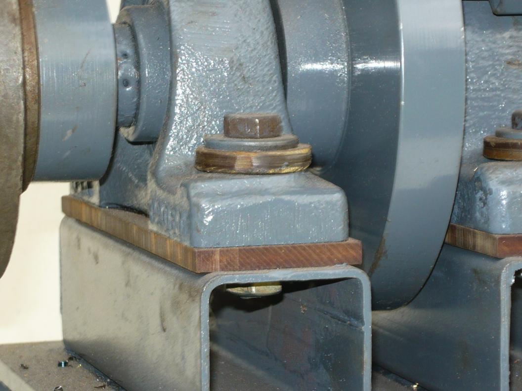

    This is a welding rotator that I built to allow me to build up a shaft for a project. The bearings for the shaft are insulated from the base to prevent ground current from passing through them. The drive is a variable DC motor, it does not have a great deal of torque, but it does not need much either.

    Very nice. I like the foot pedal control.
    Sep 2014
    South Australia, Australia
    6
    Thanked 6 Times in 3 Posts
    Greg Dix's Tools
    Hi. The foot pedal allows for interrupted welds. Thanks for the comment.
