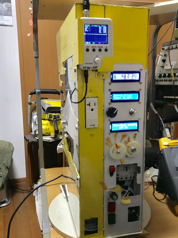

    A small tip about an oscilloscope that I need in this.
    Some of you may feel it's too costly to buy an oscilloscope for a sort of small job like this, namely to see the wave forms of your welding. Then I think I can recommend a cheapest one like the one I use on another tool I posted here;
    (Variable Frequency Drive for a larger factory fan)
    I got this (the one you see at the upper part of my VFD) new but it still does not cost too much, nearly $40 or less.
    Oscilloscope for this welder-purpose does not require too big features. We want it to see only very low frequencies like 1Hz to 1kHz (this means it's not pricey though), but one thing we need is that it must have a 'Hold Button' to keep the view when you want to stop its detection.
    Chy

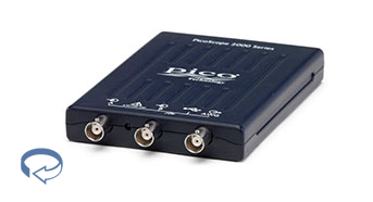

    Probably the cheapest oscilloscope is software on a laptop which plots the input on the microphone jack. Unfortunately the frequency response would probably not extent down to the 1 Hz range.
    Other cheap options include Arduino (and similar micros) based scopes, either stand alone with a dedicated TFT screen or even cheaper using a laptop for display and signal processing.
    There are many examples of how-to on the net.
    A big step up the food chain are oscilloscope boxes that connect to a laptop. I use a "Picoscope" which start from around USD 120+ and go up to $1000s. These are full featured scopes but with the advantage over dedicated scopes that the software has more processing power available from the PC.

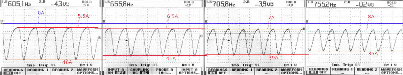

    Showing a sample of usage for this tool in my another thread below;
    Adding Digital Generators to an Old Analogue TIG Welder
    in which I used a comparison data of this;
    Hope this can help your welding.
    Chy

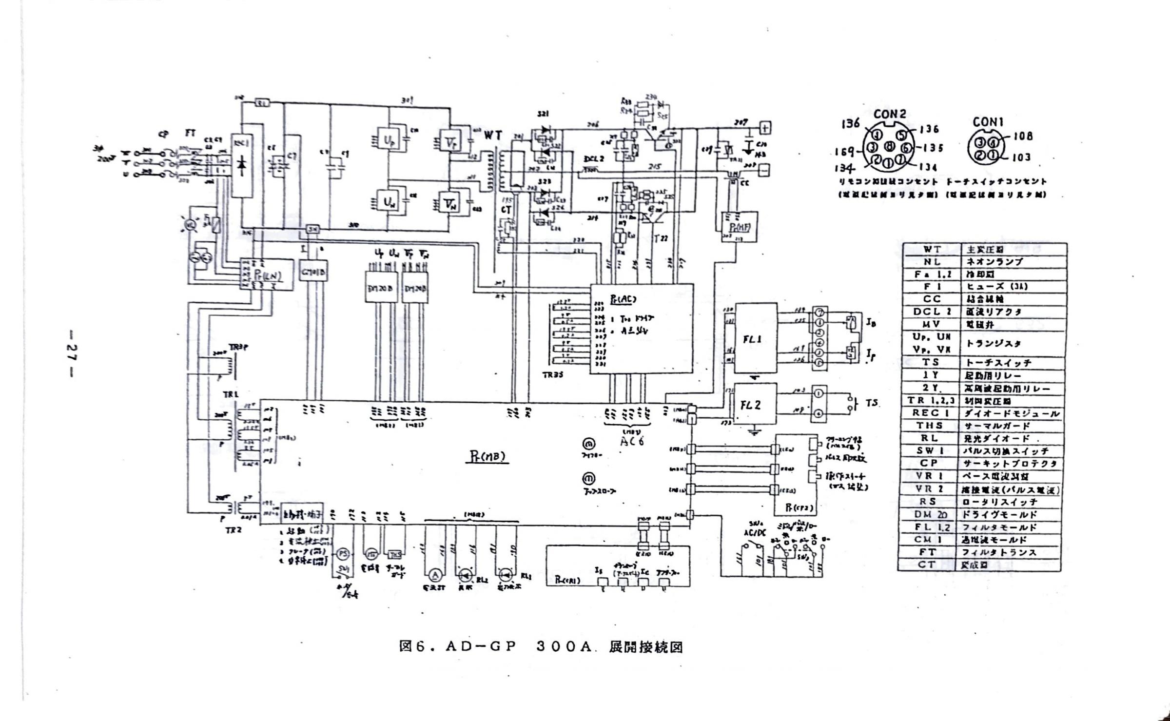

    Quote Originally Posted by Tooler2 View Post
    Could you just post the make/model of your welder?
    Good evening Tooler, if you mean you want to see my old welder the set-up, see this pls;
    Chy
    I would prefer a link to the manufacture's page describing the welder, or a make/model that I can google search.
    Good morning Tooler, they do not have a site for this old welder made in early/mid 90's.
    Instead I have a copy of the manual here, posting a couple of meaning page out of it. Try read them with your good imagination!
