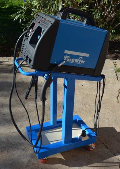

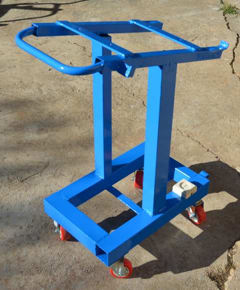

    A week or so back I bought another MIG welder. It is a medium size one and so is portable. I have a bigger industrial one that I bought new in 1976 which is far from portable. One of the first jobs that I used the new one for was to make a trolley for itself. I just wanted a simple support with the only "special features" being some cable supports. The electrical socket on the bottom rail is not connected to anything, it is there simply to stop the plug wandering when not in use. I think that a lot of things should come with such a dummy plug.
    The only things that I had to buy were the casters, 16 euros for 4. Everything else came out of the scrap box.

    Tony are you using this baby mig strictly as a gas-less unit? I don't see any provisions for a bottle

    Frank,
    Yes just flux in wire. I much prefer using 75 Argon/25 CO2 gas but the main benefit to me of this "baby" machine is its portability. I just have to undo a fastener under the unit and I can lift it off the trolley and stick it in the boot of my car, no worries with lugging along a gas bottle. I haven't used flux cored wire much before but it seems to do a pretty good job, although it seems more sensitive to voltage and wire feed settings than I'm used to with gas shielding.
    Actually there is provision for a small bottle moulded into the shape of the rear plastic cover of the welder.
