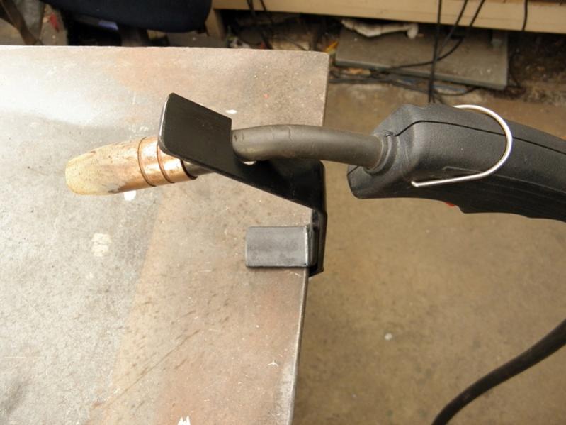

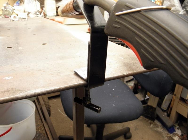

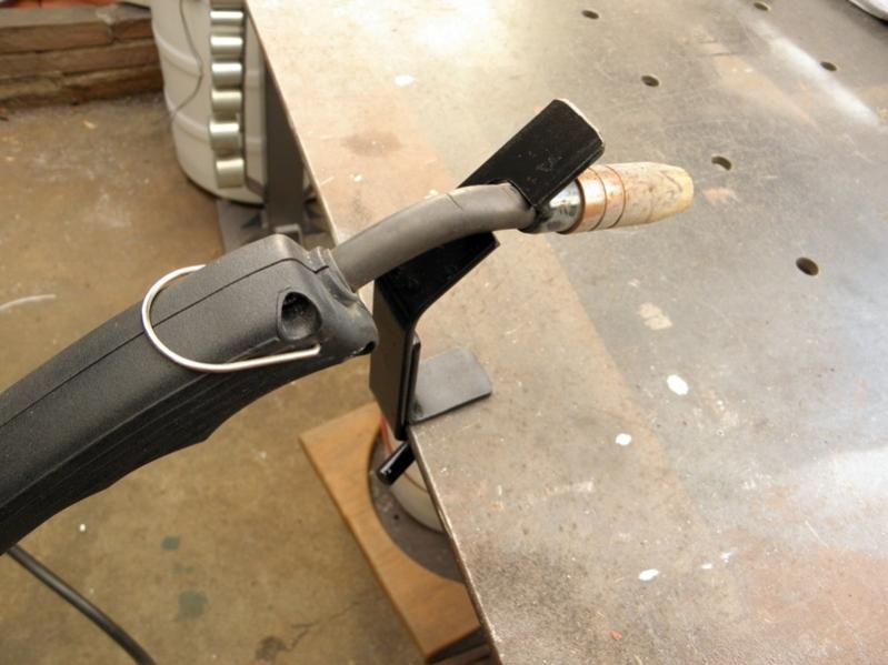

    Welder tip holder made form 1"x1/8" bar stock and 1 5/16 bolt and small rod. :O)
