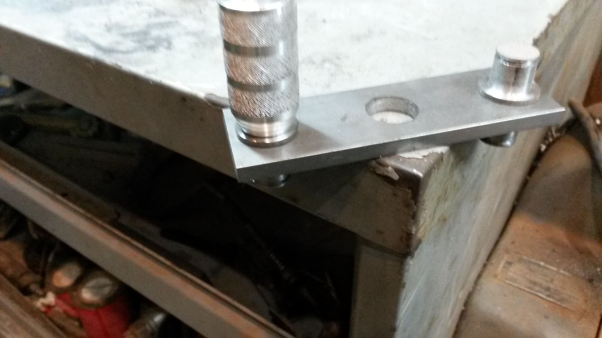

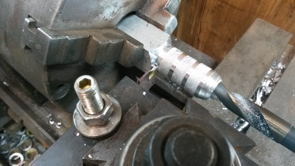

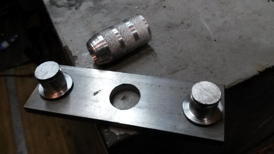

    When a stub shaft needs to be welded to a parent part the surface must be protected from weld splatter
    I have several .590" dia stubs hafts that need welded to a member
    So I made this little aluminum cover to protect them
