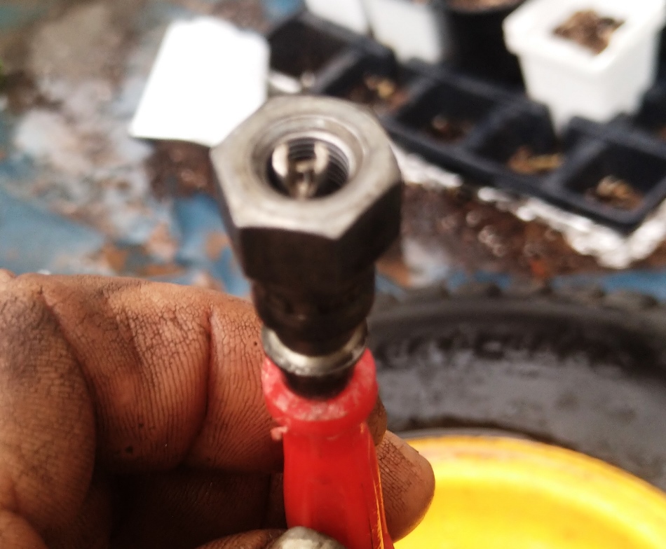

    We use our little lawn tractors more for moving things around than we do mowing, their biggest failing point is the lack of weight over the drive tires. I decided that since mine had flats on both rear tires that I would install heavy puncture resistant tubes in them then maybe this summer I will replace the tires with Wider more aggressive tread ATV tires but in the meantime why not water fill the ones on it to add some much-needed weight where it will do the most good.

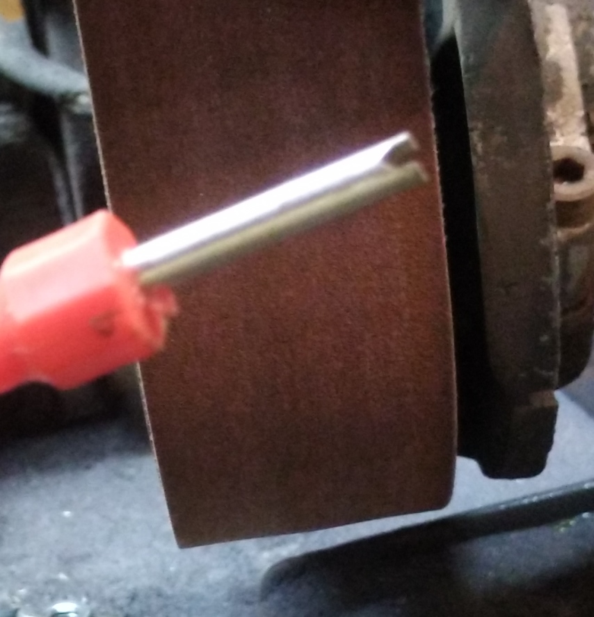

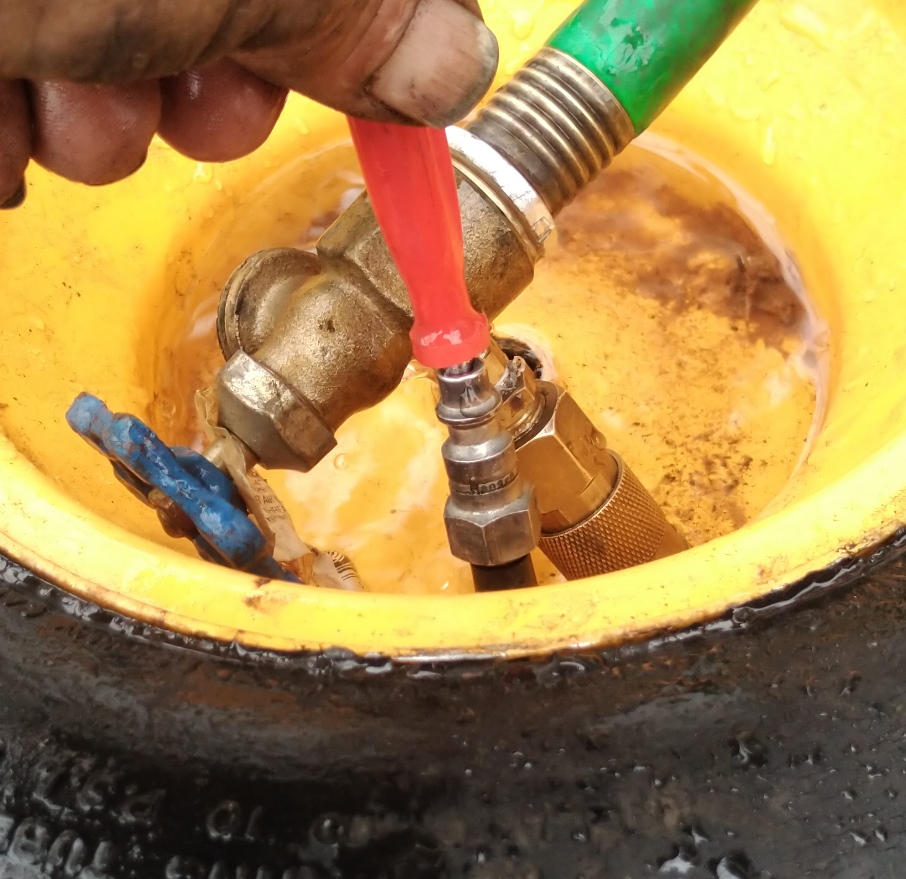

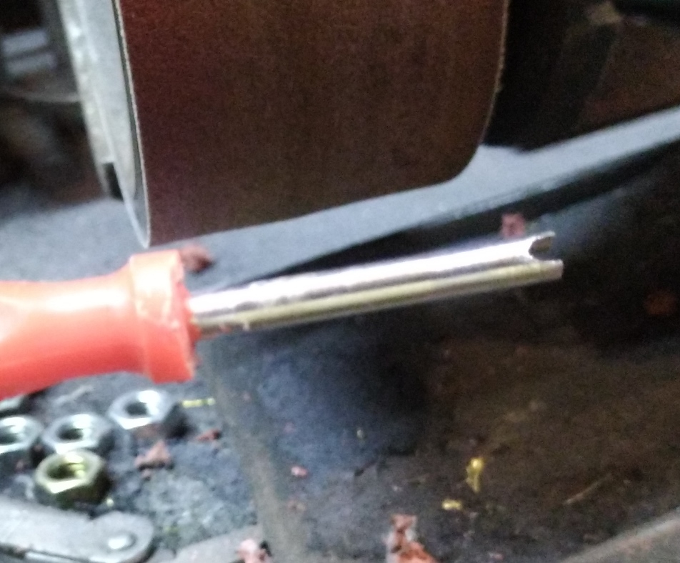

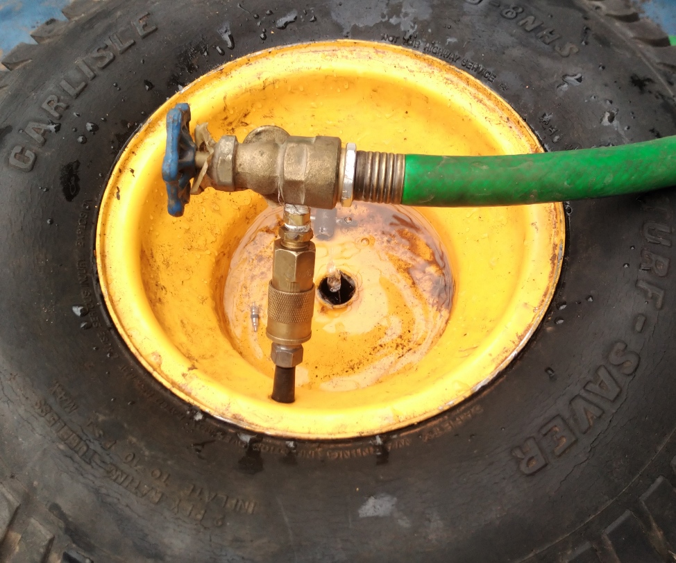

    For this I needed an adapter to connect the garden hose to the valve stem. Milton makes a female air plug that fits the quick connects which had the .305-32 thread which fits the stem. somehow I happened to have one but don't ask me where it came from. I took a Hose bib that had a 1/8" NPT outlet for an evaporative cooler line to which I threaded in a 1/8 inch brass hex nipple then bushed up to 1/4NPT and installed an air hose quick connector. I mounted the tires without putting any air in the tubes. Instead of airing them up I watered them up to seat the beads and bring them to the hardness I wanted. The adapter allows for insertion of the valve stem through it without the need to unscrew it first but to do that I had to modify a cheap core removal tool by grinding away part of the handle.

    There is right at 9 gallons of water in each tire this adds a significant amount of weight right where it is needed most

    Right now I have 100& fill and pressured up to about 20PSI water only. This is fine for the summer and I plan on replacing the aging tires with larger much more aggressive tread ATV tires sometime during the summer. But if I don't replace then then I will have to allow a significant amount of water out for the winter. We may not have the harsh winters that many do but it can stay below the freezing point for several days at least once or twice during any given winter without any air in the tubes there is no chance of the water having any expansion room during the freeze thaw process, the tires are old enough they will not stretch but just rip apart Calcium chloride mix or Beetjuice would have added a couple lbs per gallon, Hardly worth the effort or expense for a total of about 18 gallons in the 2 tires even with the up to -35°f freezing point. And then there would be the issue of removing it when I change tires. Although since I have tubes I could pump the stuff out easy enough.

    About 20% larger volume of ice versus water Frank. Up here it's brine. Anything else is suicidal for tires. I was in Texas for the record cold winter in the early 80's. We walked around in T shirts. Came from minus 30 in Manitoba. Wimps!
