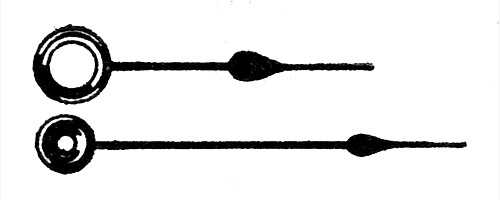

    I find it increasingly expensive to source hands for pocket watches - many of these are simple stamped steel or brass about 0.2mm thick from thin sheet using a die. I've attached a fairly typical picture - the length of a typical hand being .9 mm to 20mm and anywhere from 0.01 mm wide to 0.5 depending on the design.
    My question is it possible to hand make a die that could be used to make these hands - how would I go about doing it...
    I can't afford a laser cutter yet :-( The picture below is about 2.5 actual size i guess

    I think that you will find that trying to make your own watch hands will be more cost prohibitive than sourcing replacements
    For vintage American pocket watches you might try these folks
    Vintage American Watch Hands

    You could try photo etching the parts. Watch this vid.:

    Doh! - why didn't I think about this ??? - I make my own PCB's - it's not a long step to get to this :-)

    Etching would be efficient production too; in variety, duplication, and controlled production rate.
    Die sets don't require laser or wire EDM. Centuries of such fine parts were diestruck, and those were filed in.

    I took a lost wax casting class at the Arrowmont School in TN. If a bug's wing could be caste, a watch hand should be EZ. You could cast several at one time
