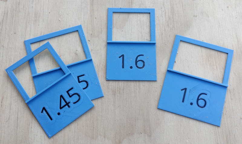

    3D Printed Waste side jigs for track saws / guide rail saws / plunge saws.
    Waste side jigs for track saws / guide rail saws / plunge saws.-kerf_jigs.jpg

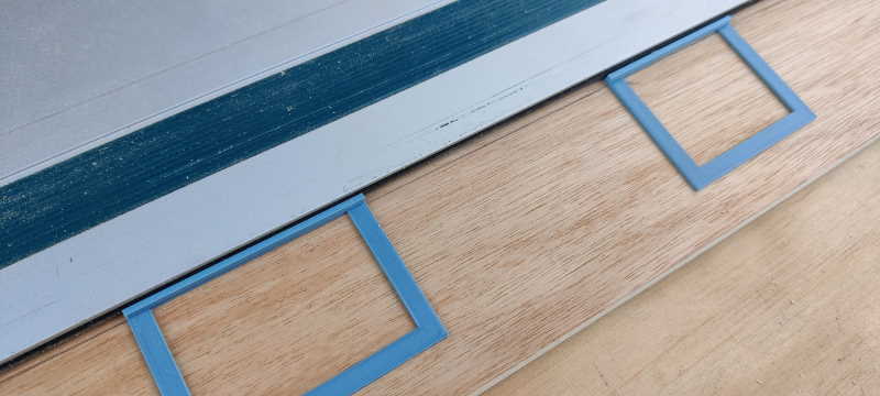

    These are used when you want/need to have your guide rail on the waste side of the line. If you put the splinter guard up to the line on your workpiece, your workpiece will end up too narrow (by the width of the kerf of your saw blade). These jigs help to offset the guide rail by the right amount.
    Waste side jigs for track saws / guide rail saws / plunge saws.-kerf_jigs_in_use.jpg

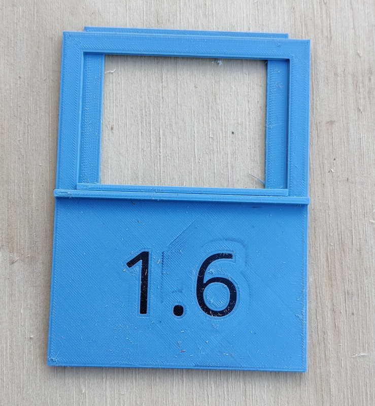

    Designed to clip together for ease of storage:
    Waste side jigs for track saws / guide rail saws / plunge saws.-kerf_jigs_clipped_together.jpg
