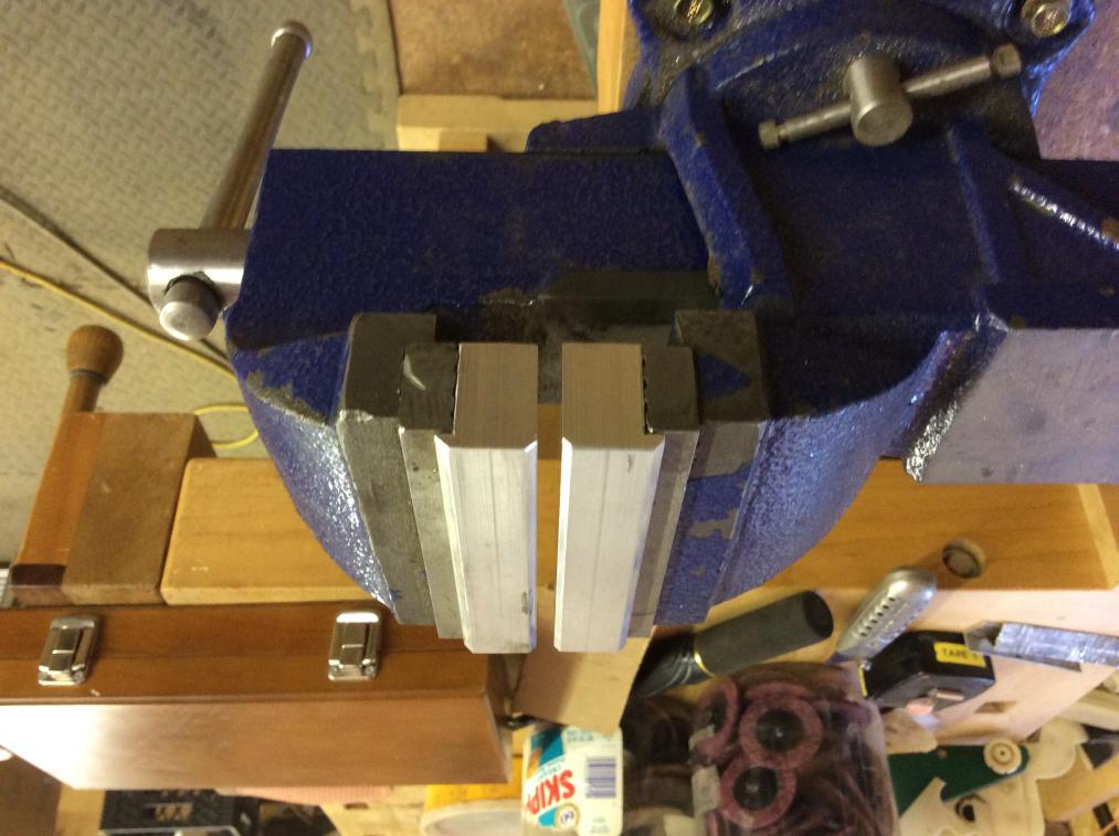

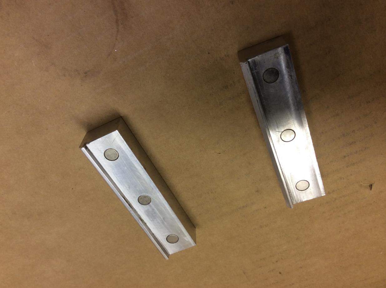

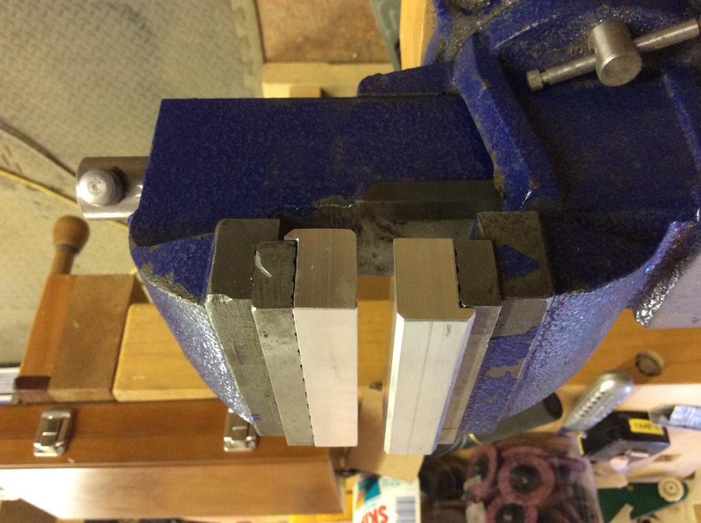

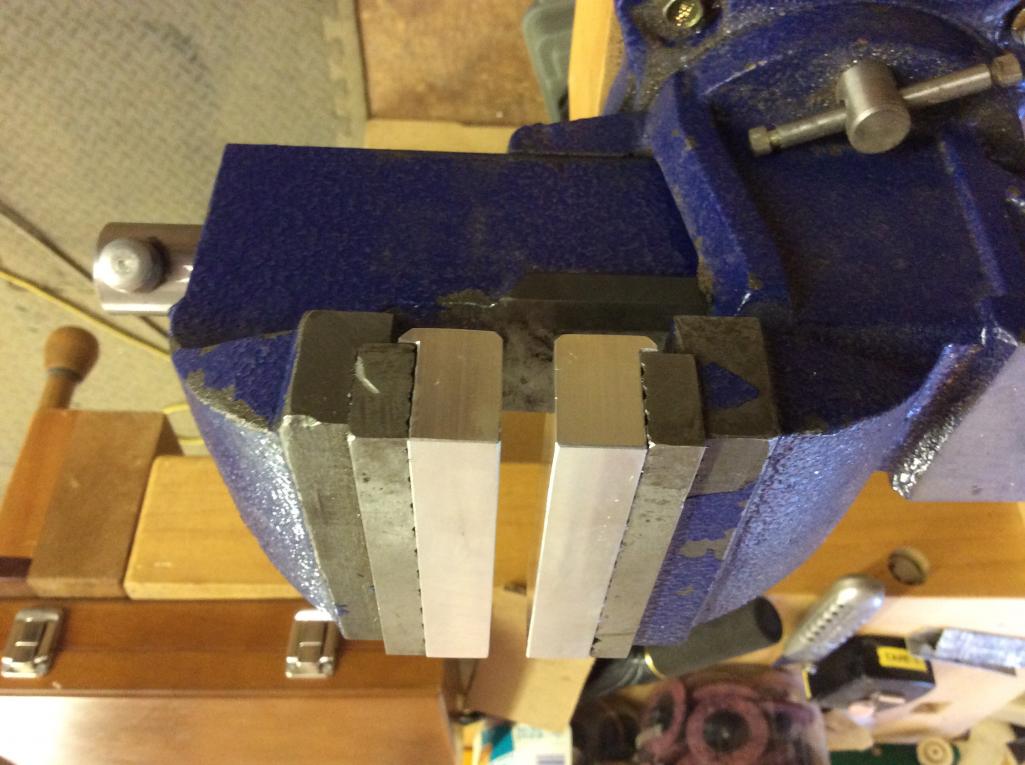

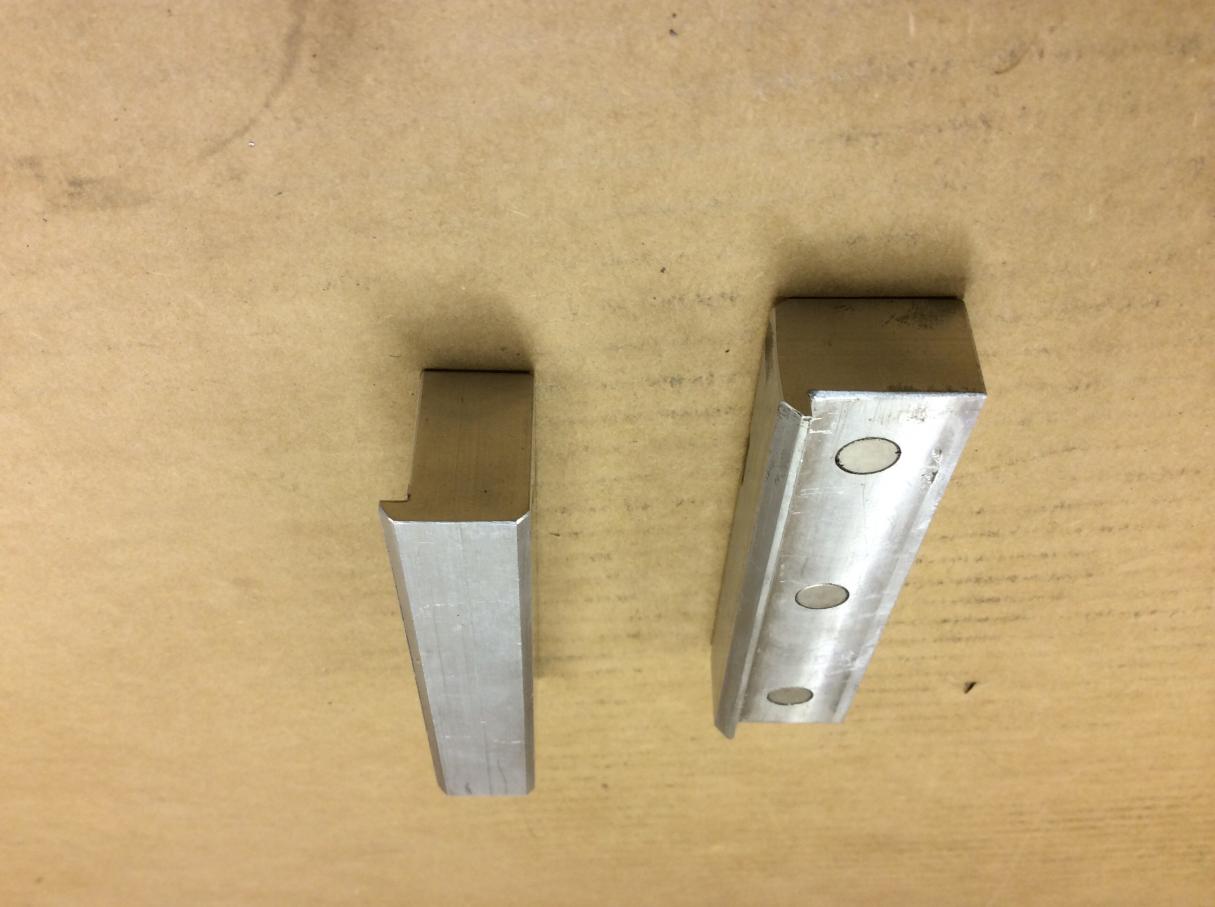

    Some new soft jaws from 6061 Alu. Size 4" x 3/4" x 3/4". Potted in neo magnets.Vise Soft Jaws-image.jpgVise Soft Jaws-image.jpgVise Soft Jaws-image.jpgVise Soft Jaws-image.jpgVise Soft Jaws-image.jpg

    The soft jaws looks like something I would like to build. What are the dimensions (diameter and height) of the rare-earth magnets?

    The magnets are Dia 0.315, Thickness 0.117. I bought 100 on ebay real cheap. Very strong.

    Now I have an idea of the diameters to get. I've been thinking of getting a batch of neodymium magnets but didn't know what size would be appropriate.

    I love the neo mag approach over bolt-on ones. Easier to install and remove.
