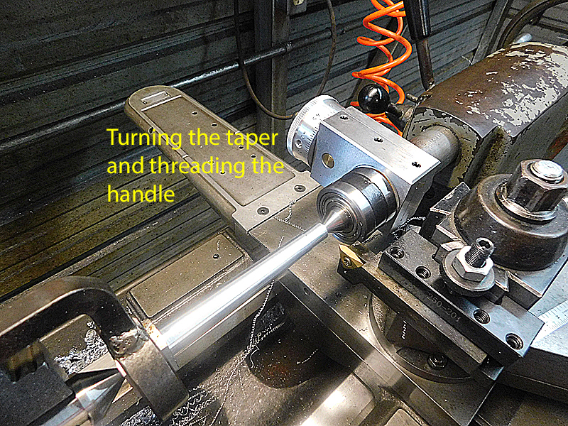

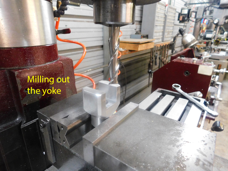

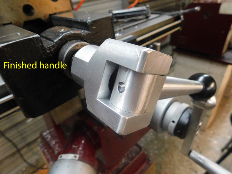

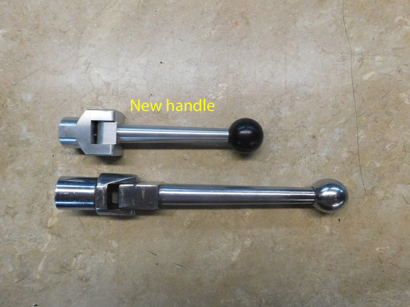

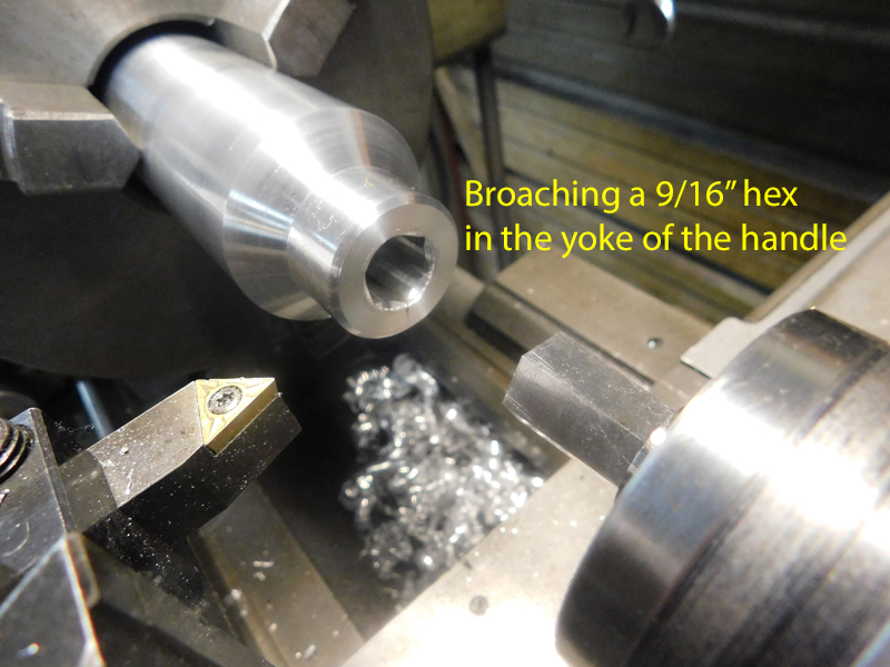

    I use a 4" vise on the mill most of the time, it's alot lighter than my 6" plus the 4" does 99% of the work I do, the only thing wrong with the 4" vise is the handle, it's as big as the 6" vise handle, it's big, sloppy and falls off all the time, when it fell off the other day and I had to do an Indian dance to keep from getting my toes mashed I said that's it, it's time for a new and light handle.
    it's just made from Aluminum, a 5/16" dowel pin and an old plastic knob I had in the junk drawer.
    Some photos below
    Thanks for looking and happy machining
    Doug

    Beautiful work Doug! That yoke is primo-extraeligant! Is the broach a snug slip fit to the hex shaft...or could it use a ball detent of some kind. Just thinking it would be easy to turn a groove on the hex and add a prefab ball detent screw (McMaster) to the yoke for $5 would be the cat's meow. Doing the Indian dance...been there done that.
    Thanks very much!

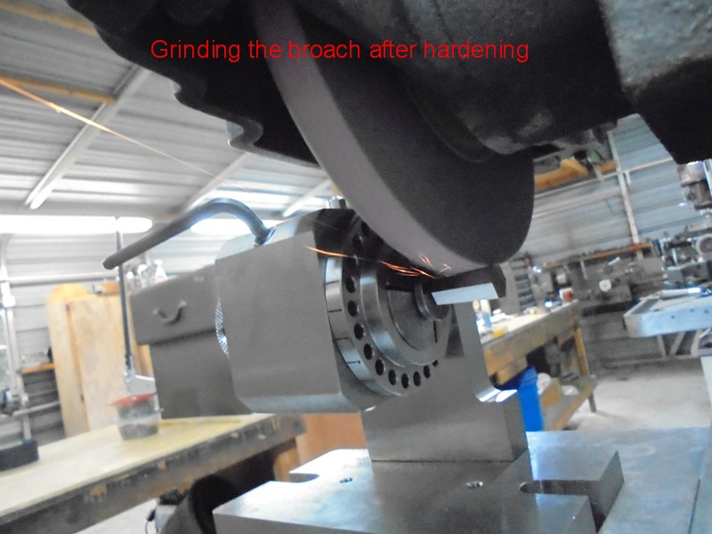

    Thanks very much!
    PJ
    Thanks PJs
    I machined the 9/16" hex broach to .585" across the flats of the hex, after hardening it was set up in the tilting dividing fixture and ground to .570" across the flats which gave some wiggle room on the hex of the vises screw and allowed for a couple of sharpening's, it's also ground at a 3° taper to allow for the 1° wobble in the broaching tool and to give the cutter some side clearance as it passes through the hole.
    It works very well, here is a photo of the grinding process on the 9/16" broach

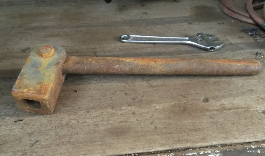

    Sure a lot prettier than the handle I made for an old monster vice of mine.
    I made this handle every bit of 20 years ago. It was one of those things that I just got tired of not having a handle for the vice so I tossed a few bits togethere and welded them up
    That is a 10" adjustable wrench
    It doesn't have to be pretty as long as it does what you want.
