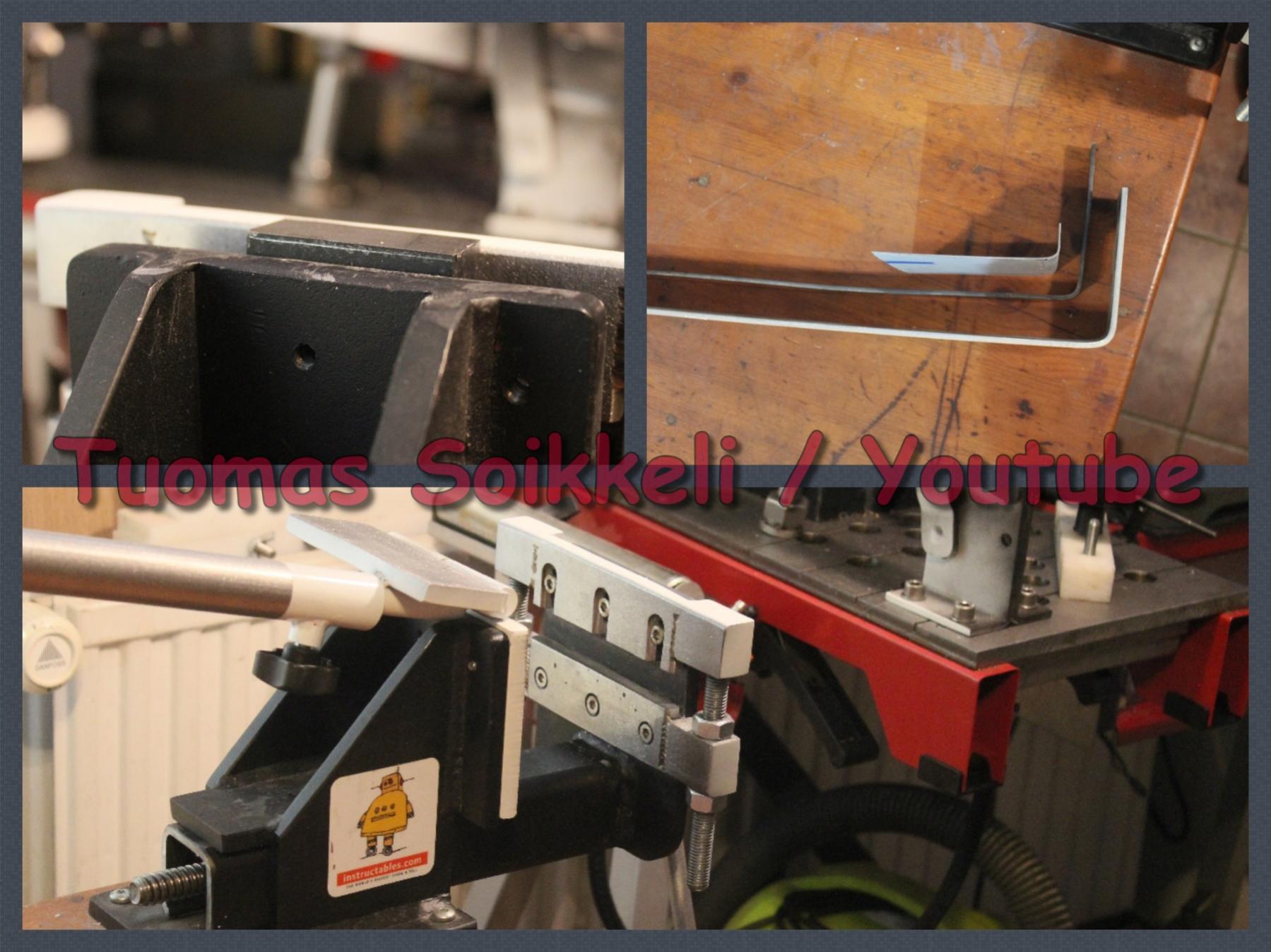

    Improvement nro 1
    Height adjusted front jaw. Gives more support when filing, and allows better view to the object. Specially with thin materials.
    Allows to adjust bending radius unportable.

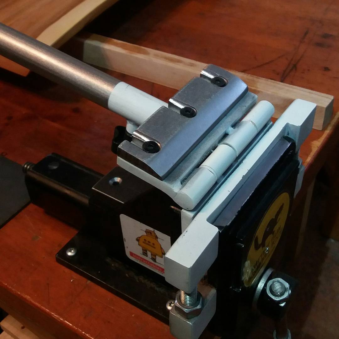

    One more add...
    Now i can adjust the position of the point that leans against workpiece. This gives more symmetrical result.

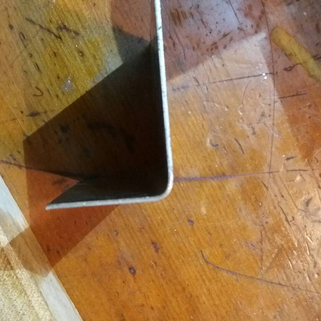

    I actually had a reason to make it.
    To make bends to the ends of the pieces that have bends on side.
    But i needed to make bend to the opposite direction. I had no tool for that before. I'll post a pic someday.. that explains it better.
