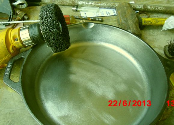

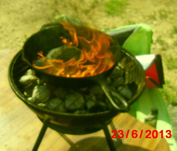

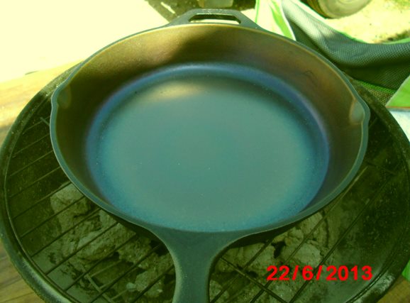

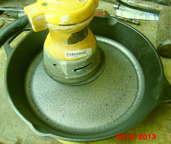

    Skip another 10 years having to buy more new cast iron skillets this time I decide to short cut the seasoning time.
    First off I used a sander to smooth the inside I kept sanding until I was using 400 grit making the inside look like a mirror then poured in cooking oil and heated on an outside grill until oil had completely burned away. I polished it and did this again a couple of times
    Virtually Non stick cast iron cookware-cimg6666c.jpg Virtually Non stick cast iron cookware-cimg6667c.jpg Virtually Non stick cast iron cookware-cimg6668c.jpg Virtually Non stick cast iron cookware-cimg6669c.jpg Virtually Non stick cast iron cookware-cimg6670c.jpg

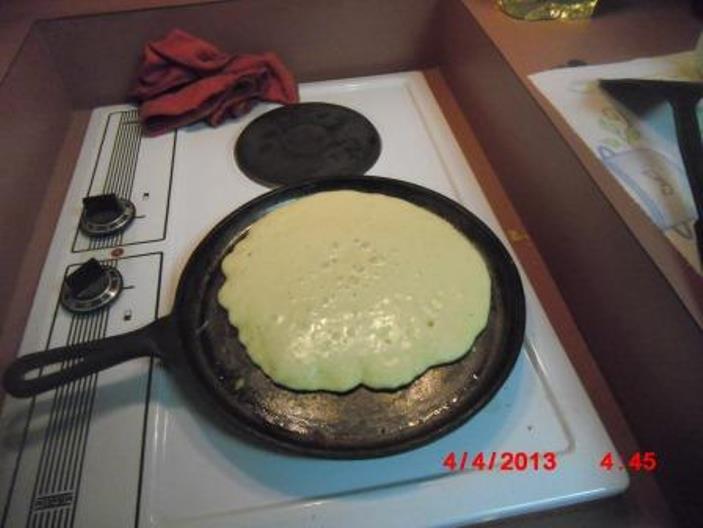

    And the flat skillet
    Virtually Non stick cast iron cookware-cimg6167c.jpg Virtually Non stick cast iron cookware-cimg6223c.jpg

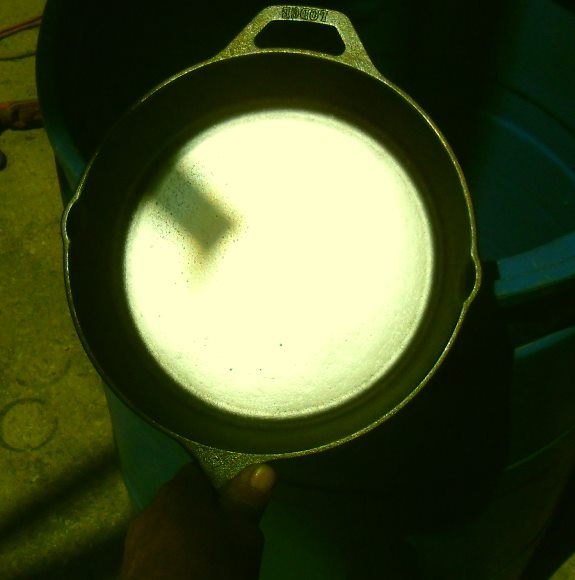

    4 years later

    Try using Flax seed oil,(raw Linseed),you don't need food grade. After cleaning scrub with detergent to clean, warm slightly before coating and let soak for a while before heating to smoke point.
    A well seasoned cast iron pan beats hi-tech coatings hands down and the extra mass provides even heat.
    I use salt to clean the hard stuff like residue from fried beans. Cove pan, heat, scrub with wadded paper towel and rinse. a wipe with a bit of cooking oil on a paper towel is all that is needed to keep perfect.

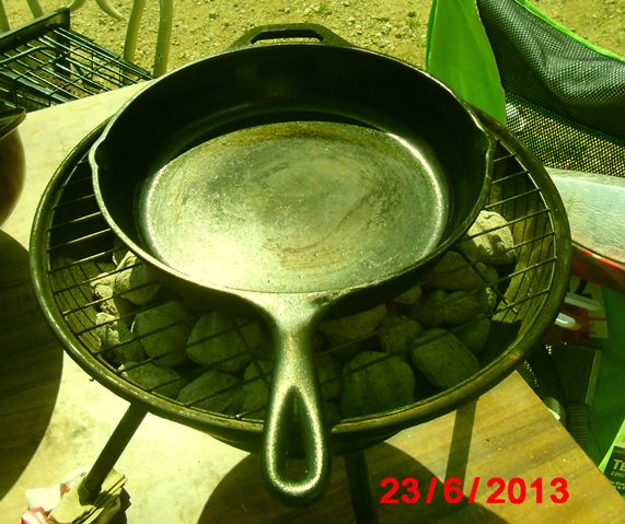

    I don't know how many of you guys feel that a humble cast iron skillet is an important tool which needs special care or even use them.
    Growing up my Grand mother and mother shared the kitchen and in our kitchen there were dozens of heavy cast iron pots pans & skillets
    In fact except for a few thick copper and some pyrex cook ware there were little else the exception being cake pans and cookie sheets.
    You couldn't find a single thing made of aluminum in their kitchen let alone any of the new fangled Teflon coated stuff that started coming into popularity later on in the late 60's
    After I got married to my 1st wife I bought her what ever she wanted for her kitchen but it was not cast iron and since she grew up a city girl from a different culture she was not exposed to this type of cookware Heck when we got married she didn't even know how to boil water without burning up an aluminum pot , she actually did that once.
    Anyway I was no kook by any stretch of anyone's imagination. I could grill steaks & burgers or cook bacon & eggs but that was about it.
    Someone gave us an old cast iron skillet blackened and crusted up from many years of use but the inside was smooth and slick almost shiny it became my favorite skillet to use when I would have to make my own breakfast
    Skip a couple of decades 2nd wife great cook and by this time out of self preservation I had become a fair hand in the kitchen as well.
    Skip another decade or so living in another country we buy some new cast iron stuff it takes forever to get it properly seasoned it seemed

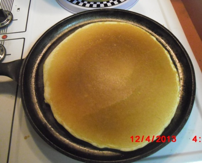

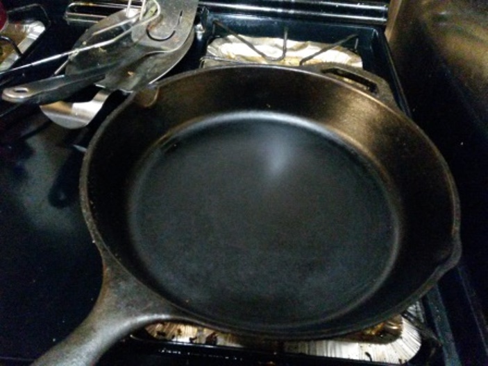

    4 years later

    Quote Originally Posted by NortonDommi View Post

    C-bag here's a tip on heating the skillet. I found it best to build a large charcoal fire in a grill much larger than the skillet. then just as if you were going to grill a steak as the coals begin to die down a bit place the skillet on the grill you want the heat to come up slowly and evenly everywhere even the sides of the skillet. I used peanut oil but that was just what I had at the time. I left it on the coals until all of the oil was burned away and peanut oil takes a long time to burn away. then I removed the skillet scrubbed it with steel wool and rock salt (ice cream salt) then wiped it clean and put it back on the coals again after I had re stoked them with more charcoal then did the oil burn the second time finally just cleaned it up and let it cool before taking it in the house or at that time into my RV.
    I've done this to several now and with the exception of 1 cheap no brand someone gave me I have been very satisfied.
    the cheap one cracked all the way around the bottom so I don't know if I heated it too fast or if it was flawed it had a too thin bottom I felt to begin with.
