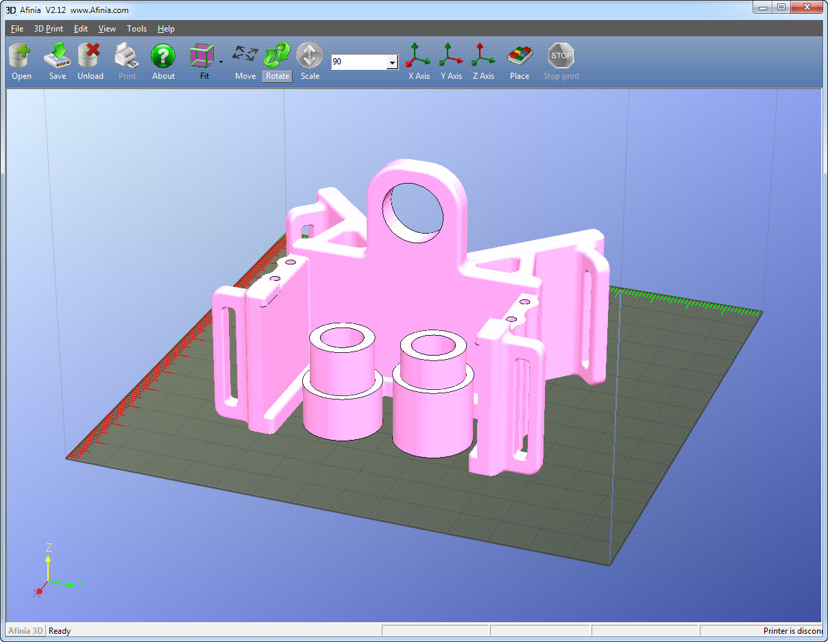

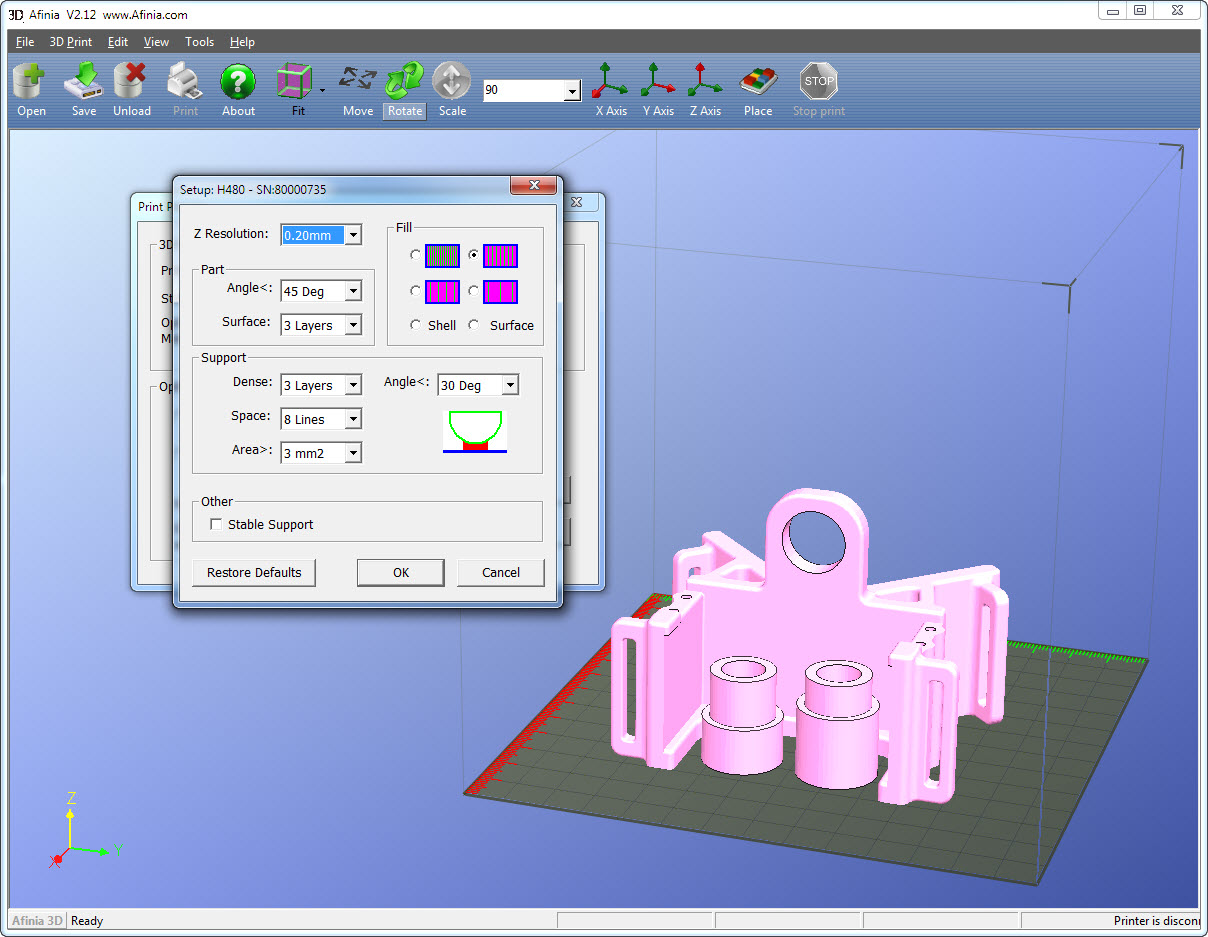

    For me, it is all about the 3D-Printing software and I got to try out a lot of different brands a few years ago by taking test .STL files with me on a USB drive to Las Vegas trade-shows and having them print the item for comparison so I could see their software features.
    To be clear, when I say 3D-Printing Software, I am talking about what the 3D-Printer does AFTER you have a finished CAD model ready to 3D-Print. The software uses code logic to figure out where to put the support material, what type of hollow fill you wish to put inside, etc.

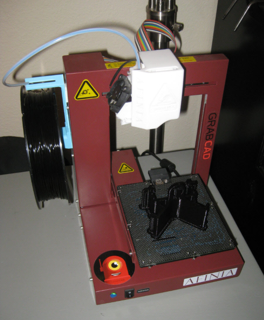

    When looking for a 3D-Printer under $2000 I chose AFINIA 3D because their software (my opinion) is amazing!
    Vice Metal Casting from 3D Printed Patterns-updated-version-done-3d-printing.jpg
    I have yet to design a metal casting pattern for something on SolidWorks that this little H480 3D Printer can't print ... if it fits in the printing area, then it prints it ... and it is only $799.
    Afinia H480 3D Printer - Afinia 3D Printer
    Of course, my inexpensive 3D-Printer can't print the fine detail, and very small parts, like the expensive 3D-printers... but it certainly works for my projects .... and AFINIA's software deals with overhangs completely in it's logic-software and puts the support material where it needs to be; yet, the support material just pulls off when done.
    Basically, you open the part' .STL file in the AFINIA software, place it on the virtual printing bed in a good printing position and then press START and the software does everything else and you come back a few hours later and you have your 3D-Printed parts.
    The only issue I have with my 3D-Printer is Large parts printed with ABS filament will warp a bit off the printing platform, but then I tested out their PLA filament and it prints flat as can be, so I don't have any issues with my patterns if I use PLA.
    They came out with a Larger 3D-Printer last year for $1900, but I have not had the chance to test it yet.
