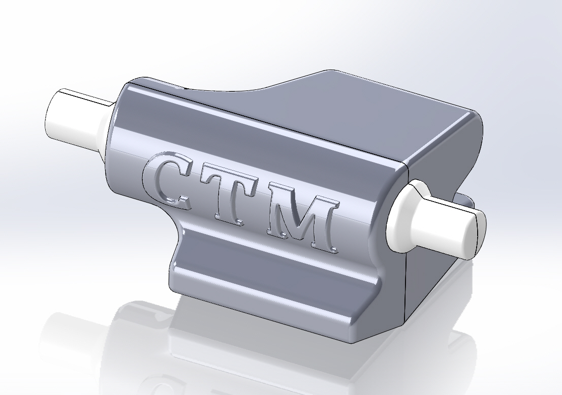

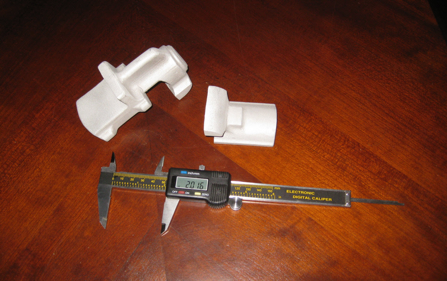

    Collaborated with SuperDave to make 3D-Printed patterns to create Metal Castings for a Small Workshop Vice ... and some other items.
    Vice Metal Casting from 3D Printed Patterns-vise-castings-before-machining.jpg
    I will update this Post after have finished machining the castings ... Aluminum, Brass, and Cast Iron

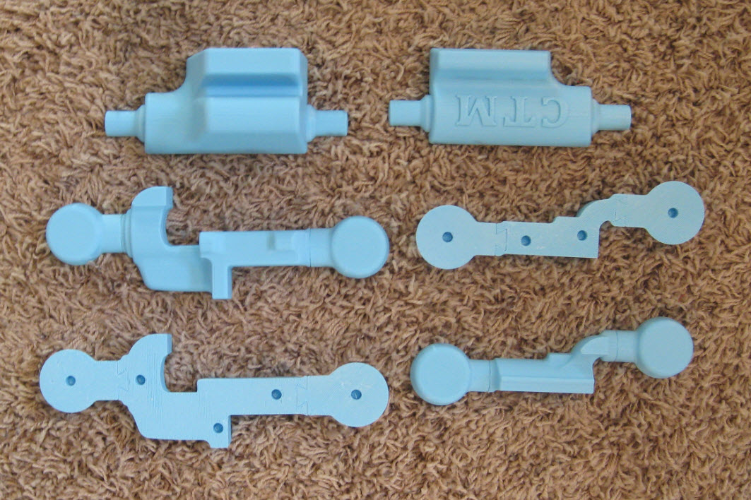

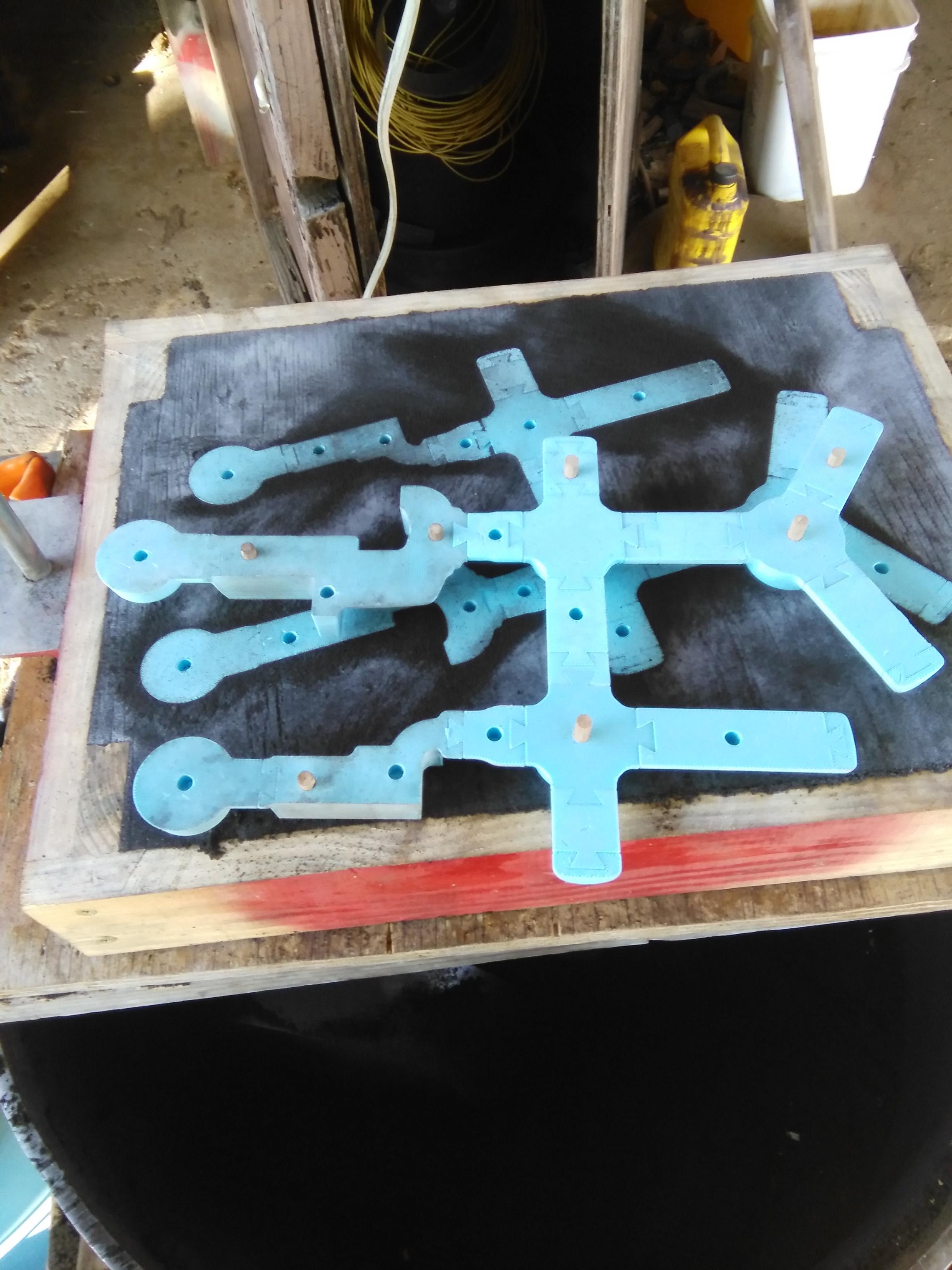

    For the long Story & Lots of Photos Click this Website Link:
    https://ctmprojectsblog.wordpress.co...nted-patterns/

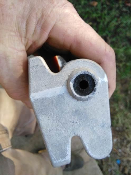

    The Short story is 3D-Printers are basically toys right now, but there are some things you can do with them like making patterns for Sand Mold Metal Casting.
    Vice Metal Casting from 3D Printed Patterns-sand-casting-alignment-dowels.jpg
    Created the designs with SolidWorks CAD software ... then Split the patterns ... and added alignment holes ... and then converted the files to .STL ... and then 3D-Printed the patterns.

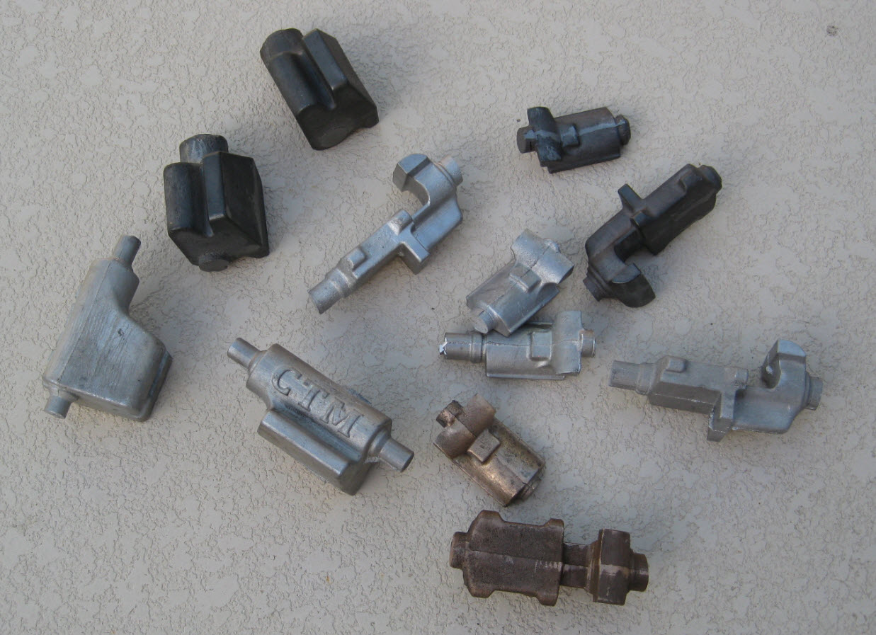

    SuperDave cast some of my part designs and some of his part designs.
    It might take me a while to machine all these castings, but I am looking forward to the practice.

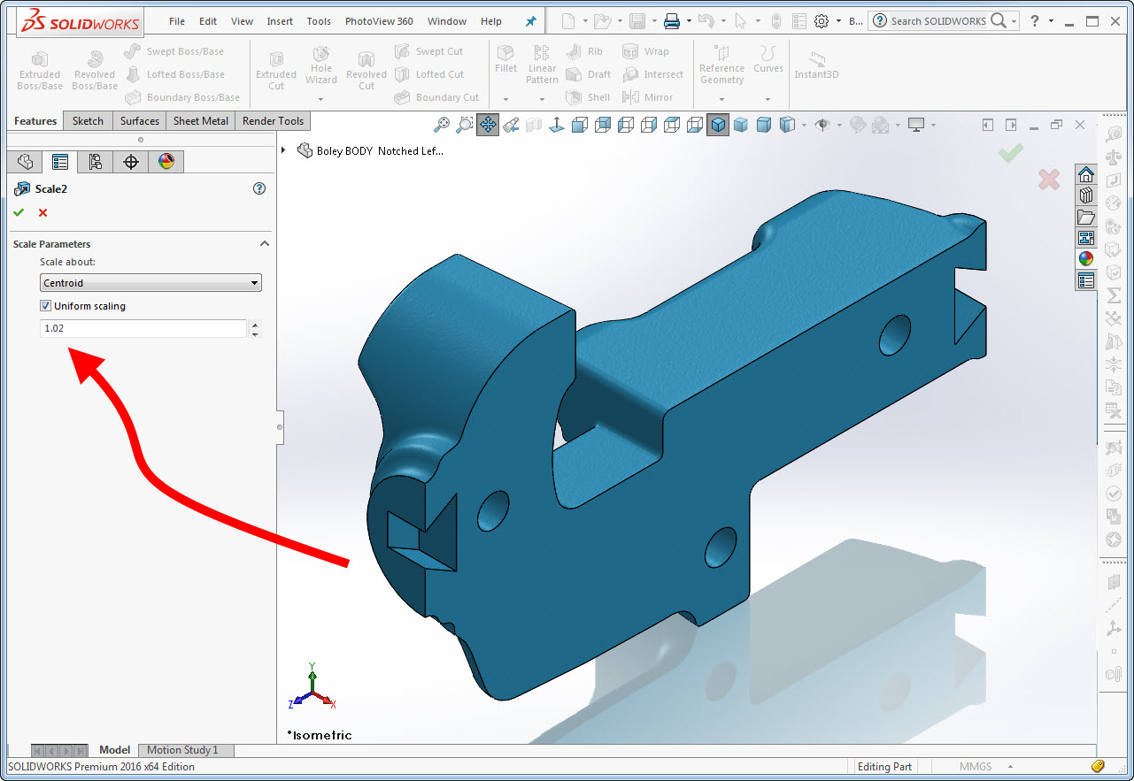

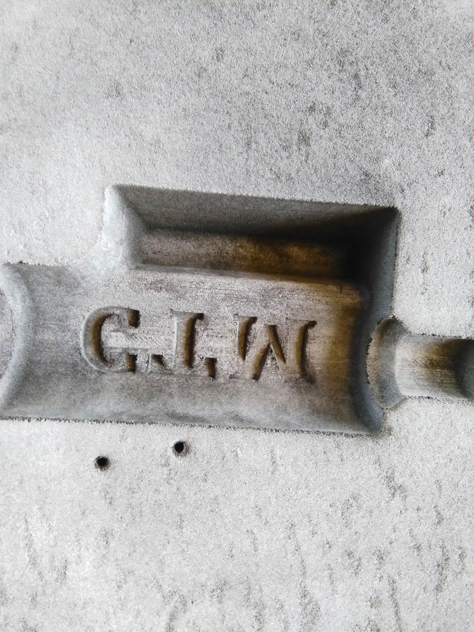

    We draw the pattern designs in SolidWorks and then 'Centroid' Scale-Up the patterns to account for cooling 'shrink' of whatever metal going to cast them out of which works very well to create accurate dimension final castings.
    Experimented using carbon rods for cores (Including Air Carbon Arc Gouging Rods)

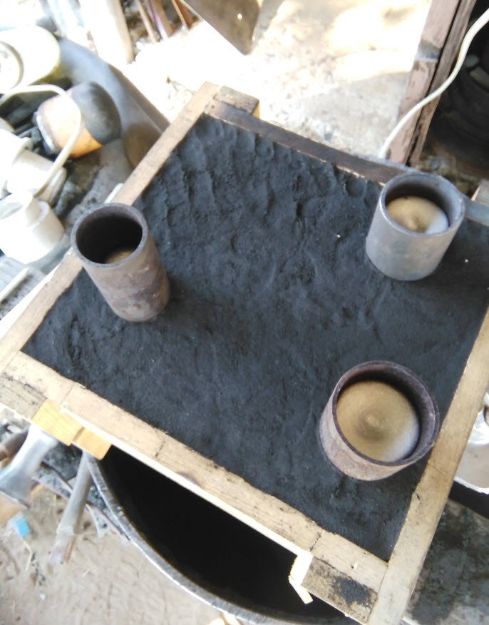

    Short 2 minute video showing the SolidWorks Assembly Design ...

    I will be making another website posting in a week or so showing more photos of the metal parts we Cast from 3D-printed patterns.

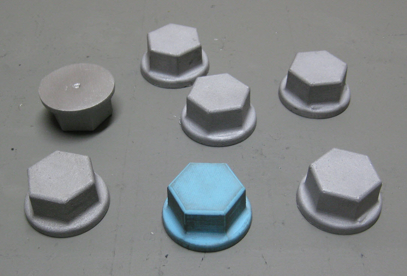

    First ... I want to machine a few of the metal castings to better show BEFORE and AFTER views of the metal items.

    You make a great point about the ability to recycle materials ... as-well-as melting aluminum scrap to cast metal parts one could also make an ABS plastic grinder and throw in old 3D-Prints that didn't come out correctly... or ones not needed anymore.
    Then use the chewed up ABS to extrude new 3D-Printer filament to make more 3D-Printed patterns and ABS parts.
    I draw my patterns in SolidWorks and then 'Centroid' Scale-Up the patterns to account for cooling shrink of whatever metal going to cast them out of which works very well to create accurate dimension final castings.
    However, on the more recent 3D-Printed patterns that will cast in the future that I know will use a lot over the years ~ I will then add a 2nd Centroid Scale-Up percentage in SolidWorks to make them even larger so after being cast in aluminum and polished off 'glass-like' smooth then those metal castings become my Sand Mold Patterns because accounted for the shrink to make a metal item that is now a pattern to cast future metal items.
    Got the idea from SuperDave
    https://www.youtube.com/user/SUPERDAVE257/videos
    So basically with little effort have several patterns made out of Aluminum to use over and over to cast more metal parts.
