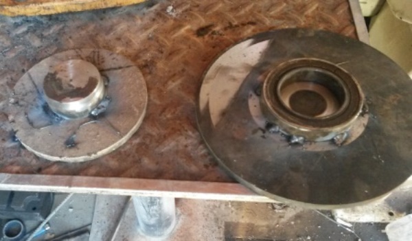

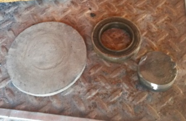

    In addition to my welding table for the repair project I also needed a lazy Susan to rotate the part I needed to weld. No I could have made a 450 mile round trip to our property and spend countless hours trying to remember where another of my fixtures was packed away or I could simply grab a couple of pieces of metal and an old bearing and make one
    First I chucked up a round disk and trued up a small area for the bearing to be placed and a relief so that the inner race would not rub then I turned a short stub shaft to fit the inner race. then tacked that to anopther round disk. Since this was most probably only going to be a 1 time use tool I only did the bare minimum of work on it as I needed to get started on the repair as soon as possible.
    A very simple lazy Susan welding fixture-20161128_150033d.jpg A very simple lazy Susan welding fixture-20161128_152655e.jpg A very simple lazy Susan welding fixture-20161128_153127e.jpg A very simple lazy Susan welding fixture-20161128_153155e.jpg

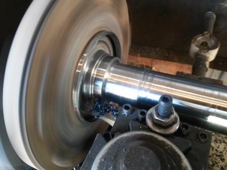

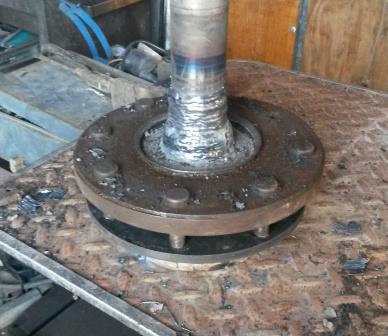

    The shaft is welded and ready for machining
    not shown but the housing was also welded up on the rotator

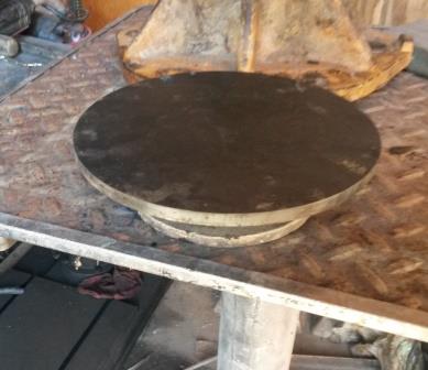

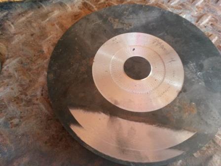

    We might have a little confusion here these are the parts for the lazy Susan

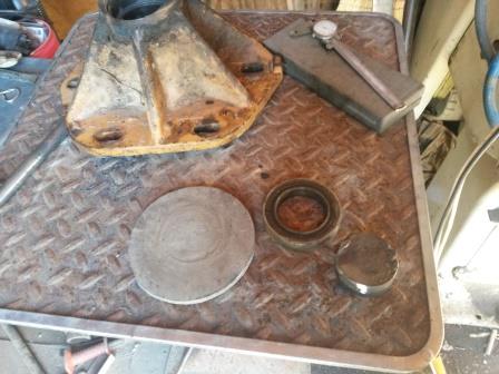

    the first pic shows 3 of the basic componants the bearing the stub shaft and the plate that welds to the stub shaft then was tacked to the table

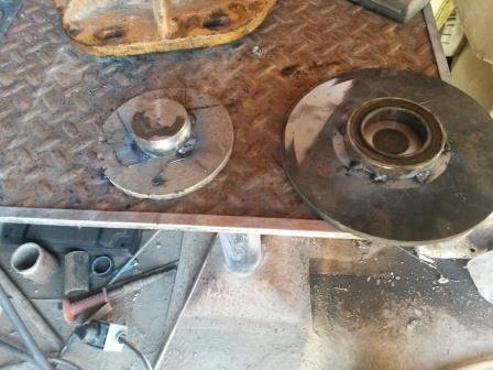

    The 2nd pic shows the bearing tacked to the top plate and the stub shaft tacked to the base plate

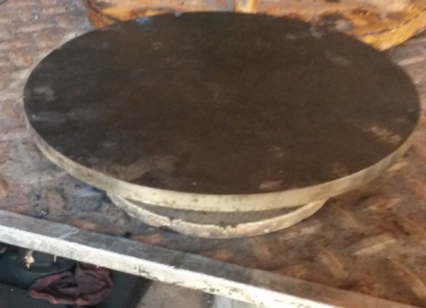

    the 3rd pic shows the Lazy Susan tacked to the table

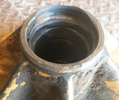

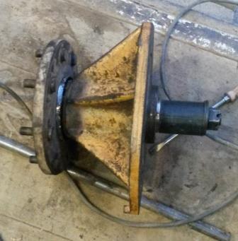

    The yellow part was the skid steer housing that needed welding on the inside and machined for a new bearing and oil seal

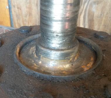

    Here is a close up of the damage
    This is the damaged axle shaft

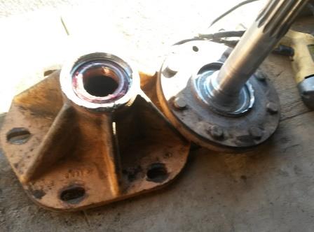

    this is the repaired housing with the new bearing installed and the shaft

    And in answer to doug42190's question yes a simple lazy Susan can be made using materials at hand. The bearing that I used was a pull out from something I had repaired I put all new bearings in the machine but a few of these ball bearings still spun freely so I used it since I was in a hurry and did not need to make a robust permanent fixture I merely tacked it in place. Essentially it is what I consider a throwaway tool as the welding current passing through the bearing will eventually erode and pit the bearing making it unusable. However in the past I seen bearings used in fixtures such as this one last for hundreds of hours of nearly continuous welding
