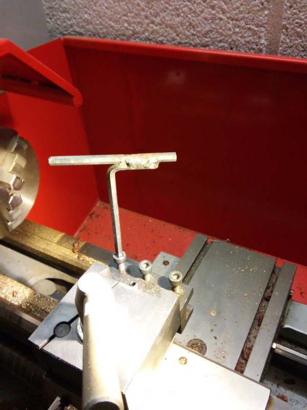

    I have just purchased a new MIG (no gas) welder, and I have just tried it for the very first time.
    And with my first two centimeters of MIG welded joint, I made a new tool :
    I just took a couple of these redundant Allen keys often delivered with various purchased things to be mounted by the user, and welded them together in a T shape. I then cut the upper one, at the elbow.
    Here it is, a strong T handle, keeping the possibility to use the three hex tips !
    I've never been a good welder, I used to "arc" weld with an inverter, but for a first attempt, that's not so bad.

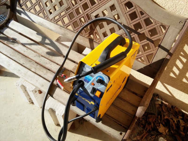

    Here is the welder :
    GYS SmartMig 110 (No Gas, welds steel only)
    Could anyone tell me why it says only steel on the pack ? The wire is 0.9, why could'nt I weld, even with a reduced capacity some stainless steel or aluminium ?
    Can I also weld cast-iron with it ?

    well done , on your first time , as for alloy you need an AC welder ...you have a DC welder , also you need a shielding gas of argon for alloy , ...
    cheers

    Thanks stumpy,
    And for stainless steel, is it the same as for alloy ?
    Thanks for the piece of advice.
