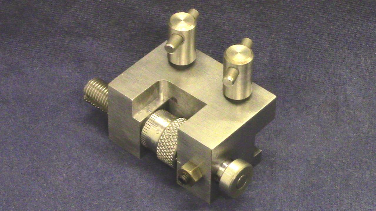

    I haven't posted much with regard to projects (laziness?!) - but thought I'd put this up. For the longest time, on my old Raglan lathe, my stop was a simple block, but felt something better was needed. A video was made but that was 3 parts long - instead I made a very condensed version for a sort of competition that was going on - probably easier to watch to show the main process. One or two errors were made but then corrected so, the end result is still very successful.
    I couldn't easily set up a 40 pitch thread, which would have given a finer scale for adjustment - instead used a 20 pitch but that still works very adequately. Used scrap material for most part.
    The video can be seen on my web site, where I index most of my YouTube videos. Below is an image of the finished item ...

    Ralph - There are many times where during turning you want a positive stop with the carriage - for example, coming up to a shoulder. There is a video and I put a link to it in the original post - http://www.oldmansshop.com/vid-pages/emma-comp-stop.php - this was a compact version of the original construction work. No picture of actual use but perhaps you can imagine how it acts when set up. In fact I think at the end of my video there is a bit where the carriage is brought up to it to test - then just visualize a repeated cut being done up to that point.

    Ralph don't feel bad I've been around lathes for 50 years and have only owned 1 lathe with a carriage stop. and that was the old Warner & Swayse #5
    they are nice to have like has been said for step turning but I've always had a trav-a-dial so just never thought of clamping one one on.

    Our toolmakers would use an indexing carriage stop using spacer blocks for setting, in fact the topslide was clamped up tight for rigidity, once you get used to working this way it is hard to go back, my topslide now lives in the cabinet and only used for tapers etc. I have instead a solid block post on my crosslide.Posted here. http://www.homemadetools.net/forum/t...1568#post74667
    One of my earlier posts showed my version of a carriage stop here.
    http://www.homemadetools.net/forum/h...1628#post74785
