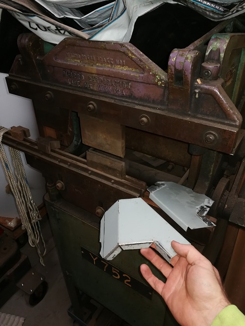

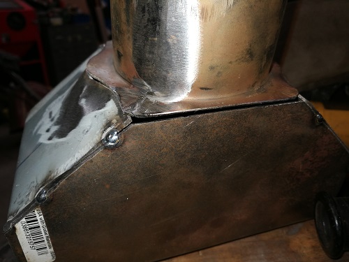

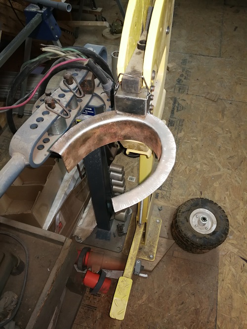

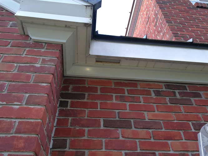

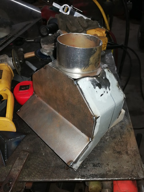

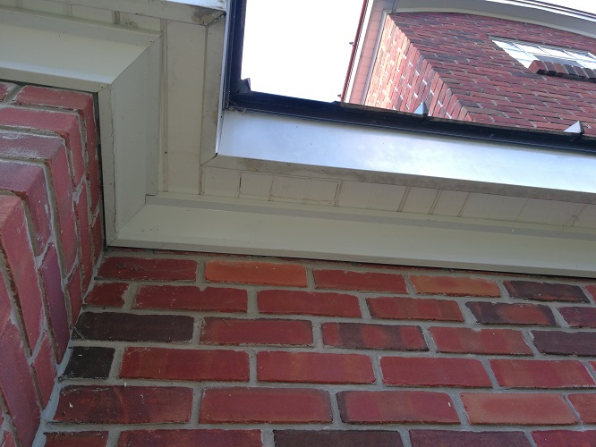

    I'm in the process of doing the preparation work for a boiler system for my radiant floor heat. While I could just punch a hole thru the brick, I wanted a cleaner and sleeker system for the intake and exhaust vents. I came up with the idea of venting thru the soffit. This would be pretty tough to see when it is done and it would keep the venting above the ceiling. I also would not have to cut thru the brick...even tho I have the tools to do that...
    I started by coming up with a cardboard design. Then refined it and transferred the pieces to steel. I was able to use some 16 ga sheet from a couple of salvaged 12" j-boxes and some from new sheet metal. I bent the flanges on the first one. I made the transition to PVC pipe on the shinker/stretcher.

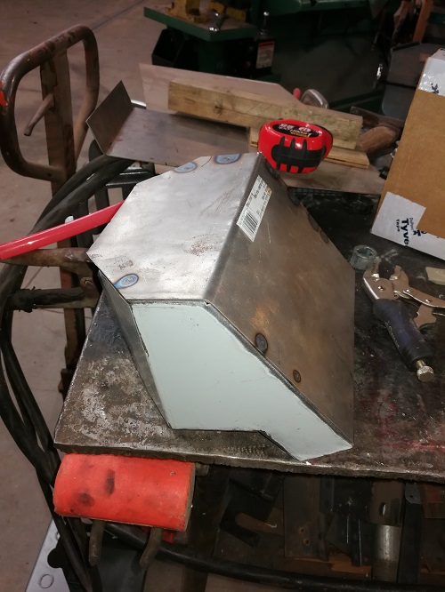

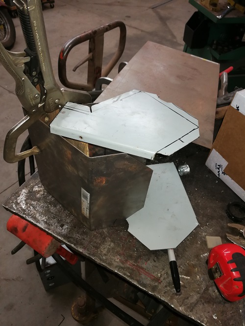

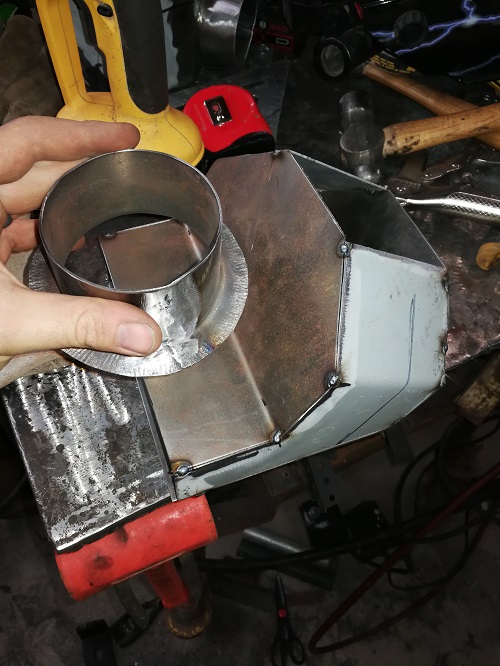

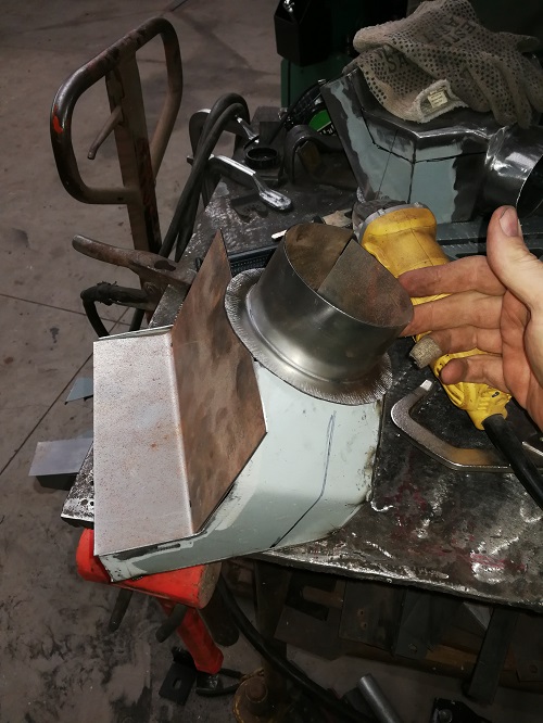

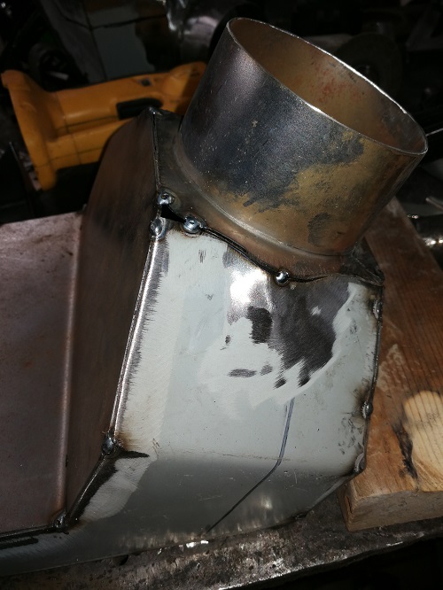

    After I got the pieces cut, I started tacking it together.

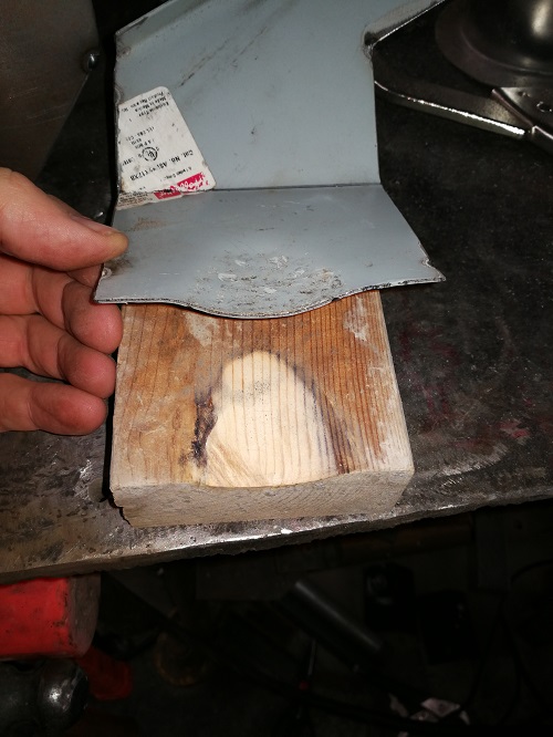

    On the second vent hood, it needed some additional shaping, so I made a quick wood buck and hammered in the relief. Then I tacked it back together and trimmed the excess metal so the joints lined up.

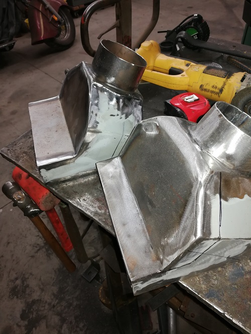

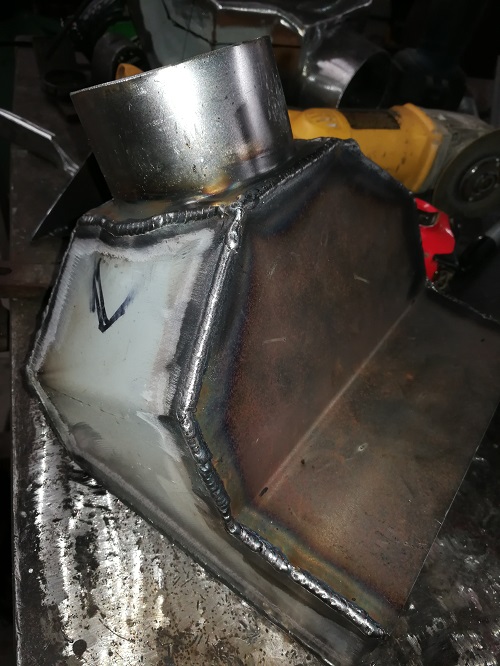

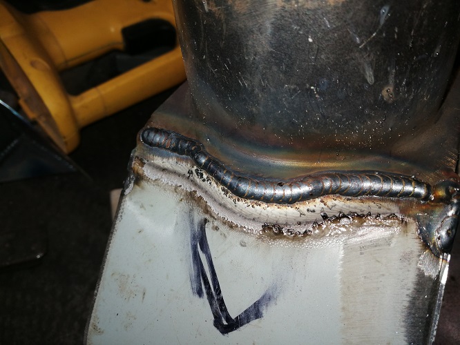

    I proceeded with welding using my Hobart Beta-Mig 250 running 0.045 wire. Yes, this is thick wire for sheet metal, but it worked surprisingly well.
    After a little work with the blending wheel on the grinder and the flapper disc, they are about done.
    This weekend I need to fine tune the hole thru the soffit and get them fitted into place. Then start running the vent pipes....
    I also need to put a coat of galvanizing paint inside and out.
    **NOTE: The grey coating is the powder coat from the salvaged j-boxes.

    That Looks impressive, I take it is for a thicknesser . what angle is the back angle.

    Thanks! Not sure what you are asking in regards to "thicknesser"
    The back angle is about 35 degrees so that it matches the angle of the roof.
    The thickness of all the metal is 16ga.
    More details to follow as I hopefully make some more progress this weekend .

    It's pretty simple. Short run of 3" pipe from one soffit vent to the intake of the Combi boiler.
    Then a run of about 28' of 3" pipe to the other side of the garage and out the soffit vent for the exhaust.
    Intake is on the north side of garage and exhaust is on the south. I could put both vents on the same side with some spacing between them, but it works out much better for my situation to vent to each side of the garage.
    Boiler has a built in fan for power vent and has a maximum pipe length of 100'.
    Trust me, I've read the manual for the boiler and evaluated the venting requirements. There is more than sufficient venting. 2" pipe is actually sufficient up to about 50' if I recall correctly.
    This boiler can use a concentric vent thru the wall and other options. My plan is within the necessary requirements.
    I understand that not all natural gas or propane boilers or appliances have the power vent, however, this boiler is set up for method.
    I'm not poking a vent pipe thru my standing seam roof. I would go thru the brick wall before I did that.
