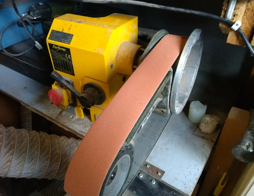

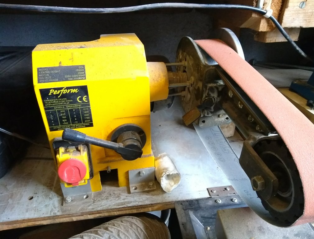

    This is my variable speed belt sander created by combining a lathe headstock with a multi tool belt sander. The sander is held using threaded rod studs, it was only meant to be a proof on concept before turning a proper ring on the metal lathe but it's so solid and works so well I never changed it. RPM's are adjustable from 500-2000, it's a great tool.

    Depending where you are you could contact suppliers of similar machine tools. I cannot say for definite though, I bought mine on ebay, a chance spot for a local pick up item, it was cheap, no-one bid because of the collection only. I thought it might be useful and it was!

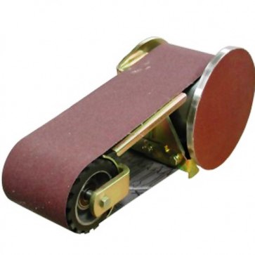

    No it's an (Australian made I believe) attachment designed to go on bench grinders.

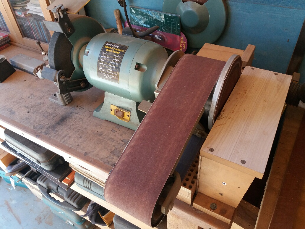

    Ha ha! Small world...Here's mine in 4". Bought with 8" grinder for $300 complete in 2003....now the attachment alone is about $400....very useful, standard 36 x 4 belt and 7" disc. Quiet strong induction motor, will go all day...

    While I don't find the 2" version limiting, I wish I had bought a 4" version, after all you can always run a smaller belt on the larger machine, but not the other way around.
