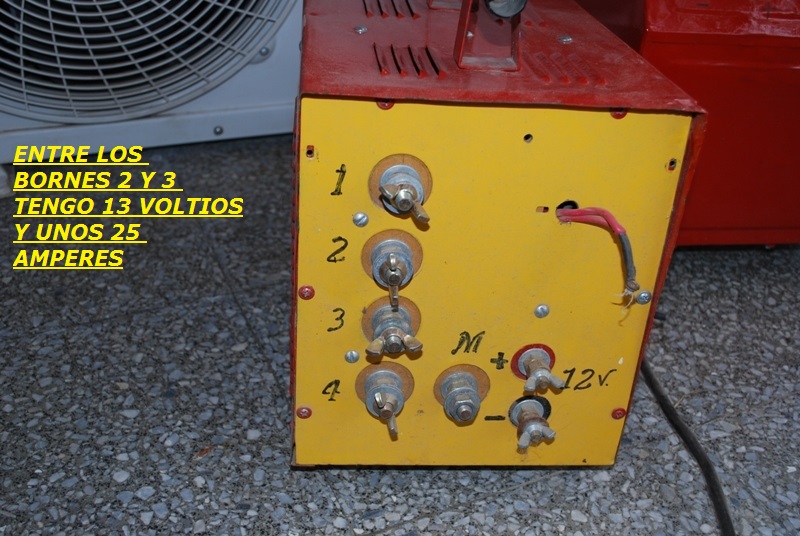

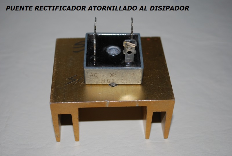

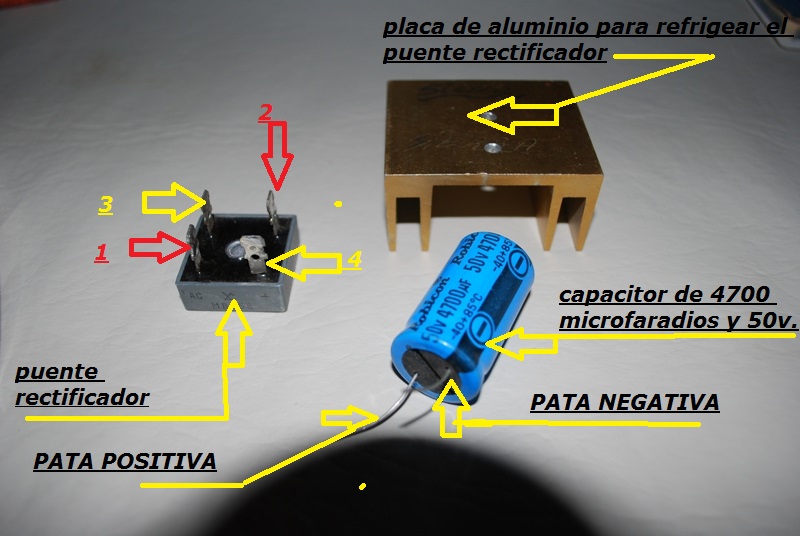

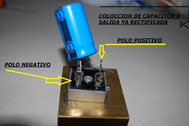

    Quote Originally Posted by Swiss Toni View Post
    Has anyone made a variable power supply for use in home electroplating ?
    Hola suizo toni, con respecto a tu pregunta he subido un tema Convertir Corriente Alterna en Corriente Continua, quizas te sirva lo que presente, suerte y hasta pronto.Variable power supply-1.jpgVariable power supply-2.jpgVariable power supply-3.jpgVariable power supply-4.jpg
