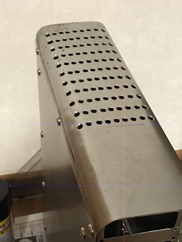

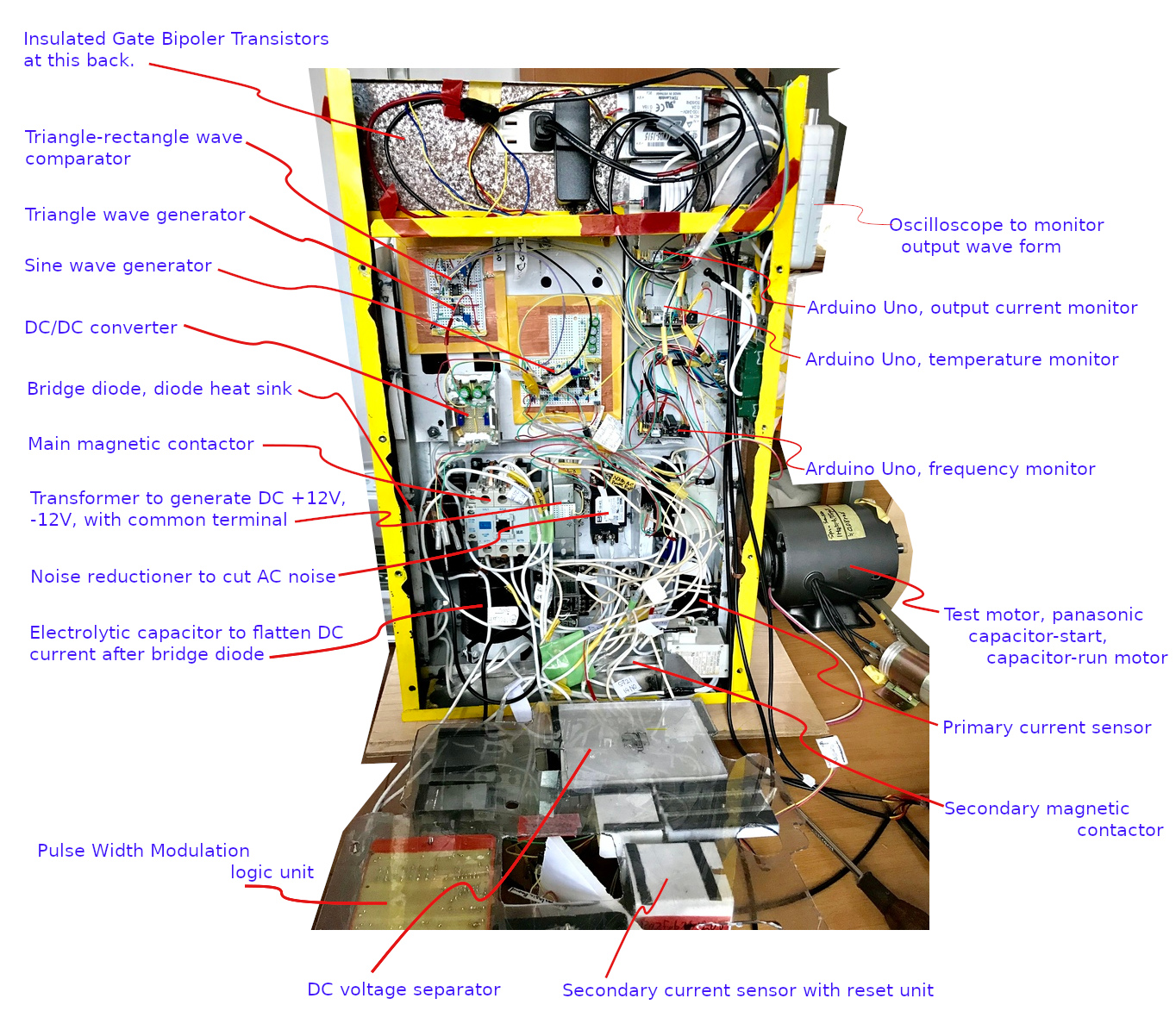

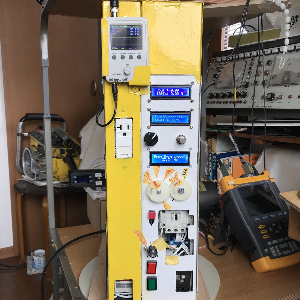

    Last year we had a very hot Summer and Autumn so had a presumption that we should need a very big fan in our shed to get our job easier this year.
    This motivation gave me a way to build a single phase Variable Frequency Drive for a bigger fan motor!
    Fortunately or unfortunately we have cool Summer now, so not yet get a new big fan yet, nor have a chance to run this VFD...
    Inside: Triangle and rectangle generators are analogue unit.

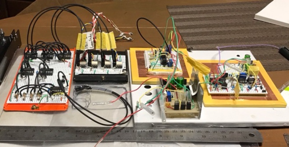

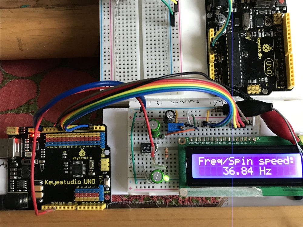

    Started from these;
    Making shifts to the frequency is to be done with a couple of white dials, an obsolete analogue way.

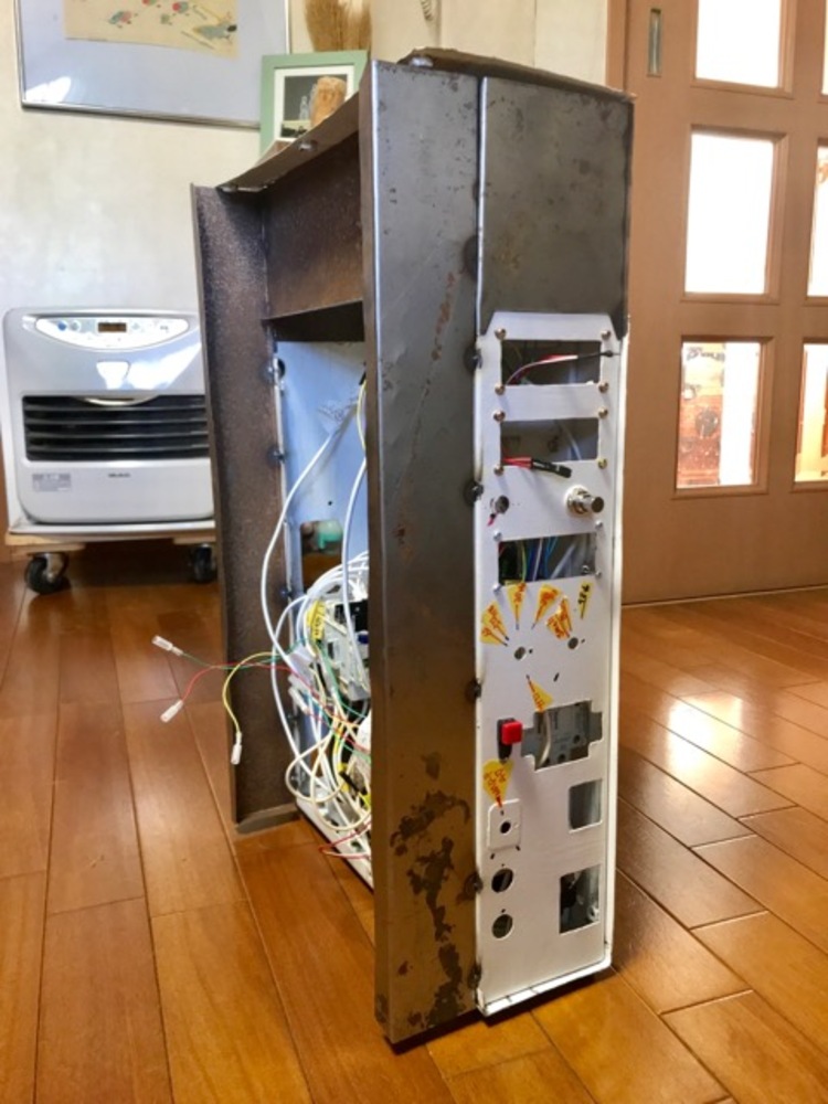

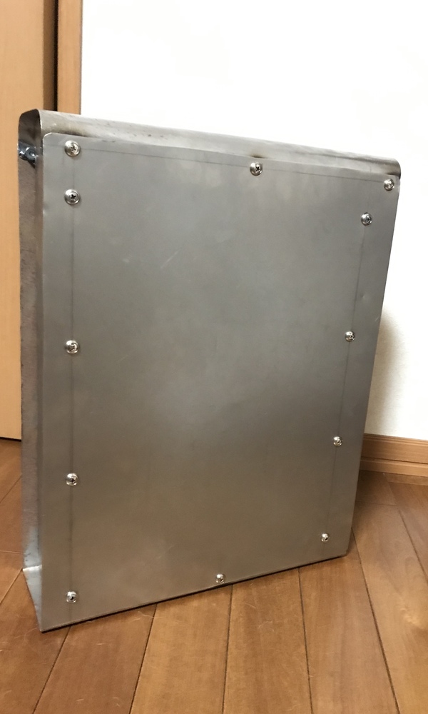

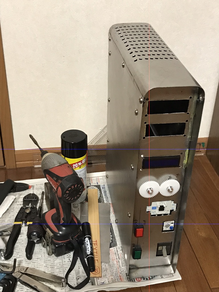

    But on the way of assembling I found this handmade case was a tad small, so added some more rooms ;

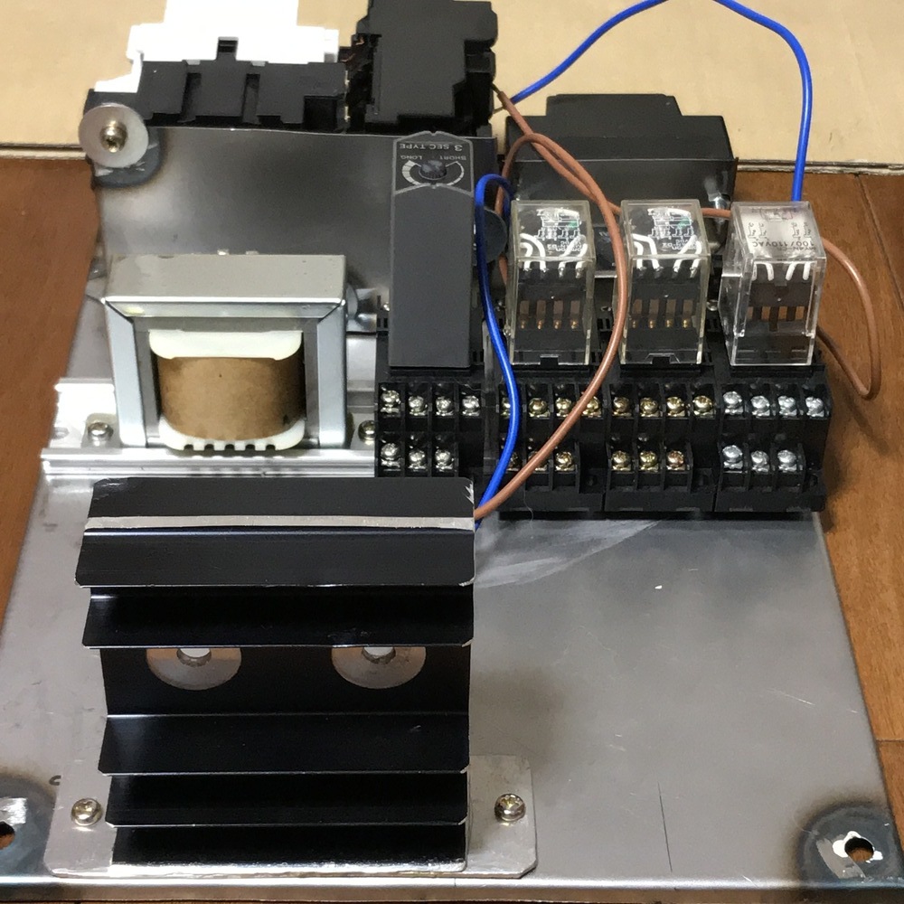

    Main power board with magnetic contactor and a transformer;

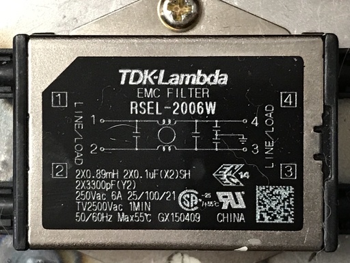

    Placed a noise filter right after the main contactor;

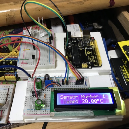

    Temperature sensors are placed onto five different part,
    1: Bridge diode (50A),
    2: Short cut unit,
    3: Isolated Gate Bipolar Transistor unit,
    4: High speed diodes for return current re-circulation unit,
    5: Double 2mH filter coils right before the output terminal;

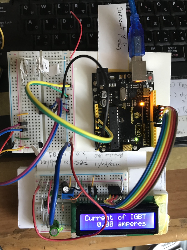

    Output frequency monitor;

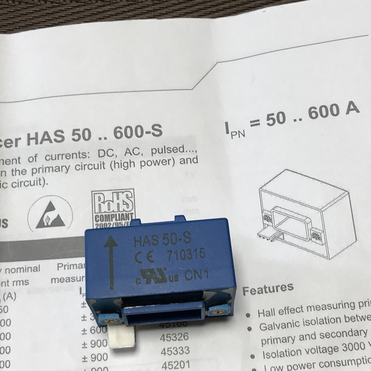

    Output current monitor, and its detector (HAS-50);
    Variable Frequency Drive for a larger factory fan-has_50-s_current_transducerjpg.jpg

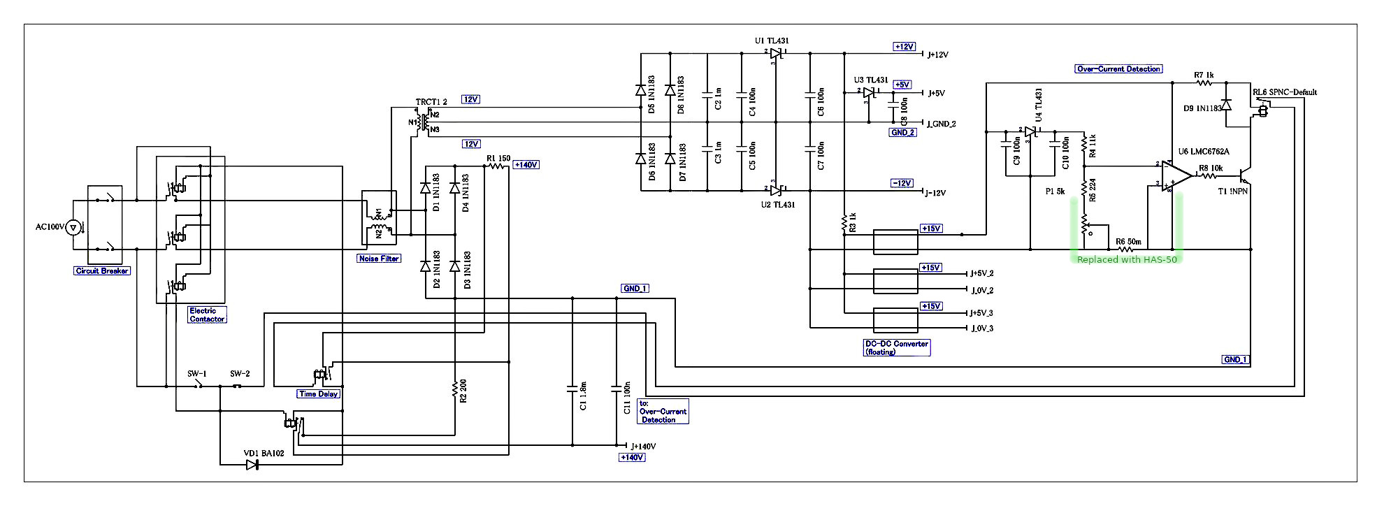

    Schematic for power units is;
    Chy
    please note there may be a wrong design in above drawing.

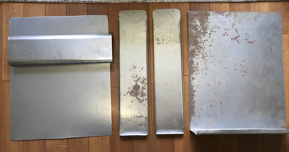

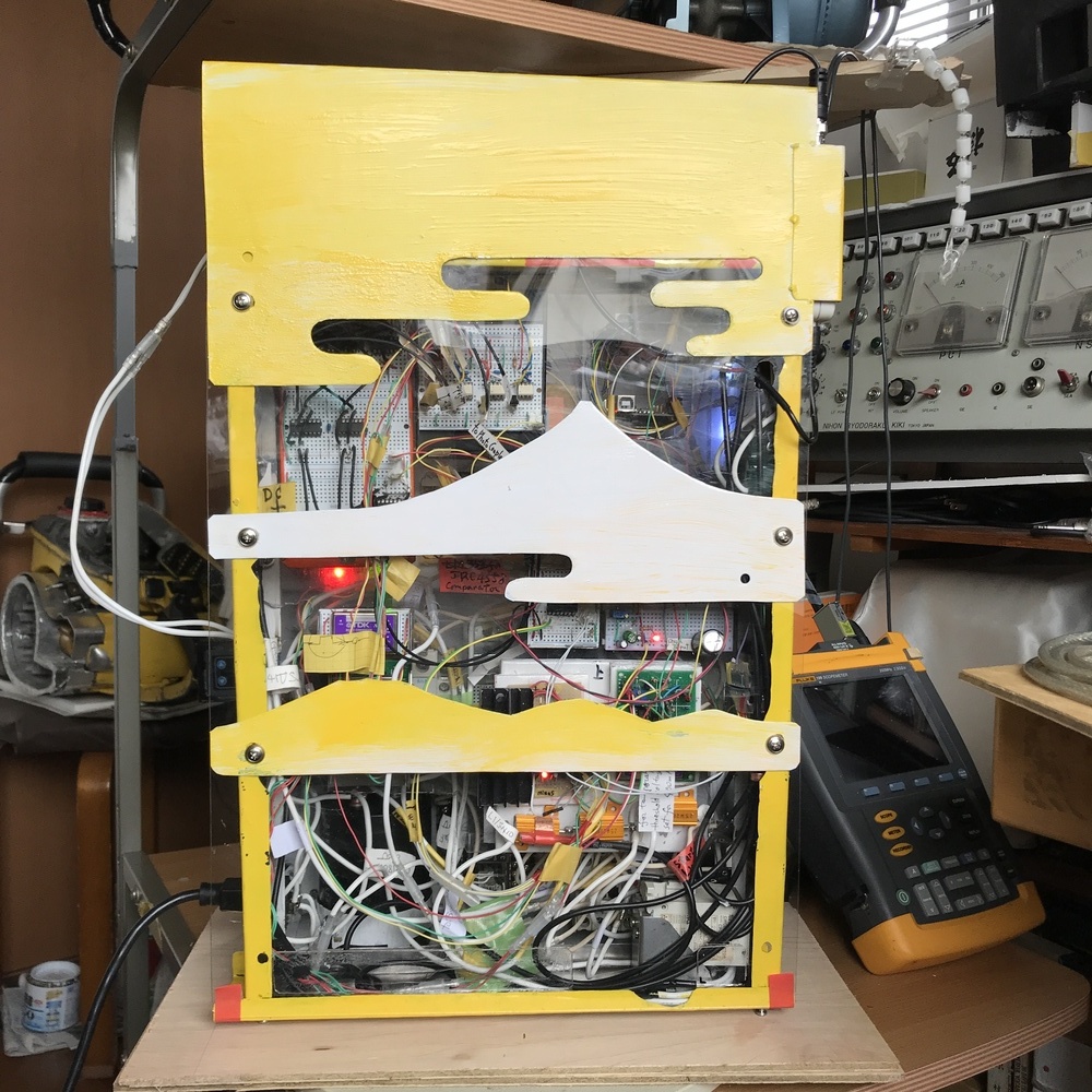

    A couple of logic units of this type is known as noise-fragile to electro-magnetic noises. This part was one of the complexities to me.
    Units in the right half (marked yellow) are electrically shielded with copper plate around them, they are a triangle wave generator and a wave form comparator, and a sine wave generator.
    These in the left half are also shielded with so called shield wire (black wires), they make up a Pulse Width Modulation logic unit.

    That's great. Well done.
    Why three Arduinos?
  14. The Following User Says Thank You to nova_robotics For This Useful Post:
    chy_farm (Jul 30, 2020)
  15. #8
    Supporting Member chy_farm's Avatar
    Apr 2018
    Yokohama, Japan
    125
    65
    Thanked 214 Times in 60 Posts
    chy_farm's Tools
    Good morning Nova, Why? ,,, only because I did not know other ways, lol. Do you make them in one Uno?

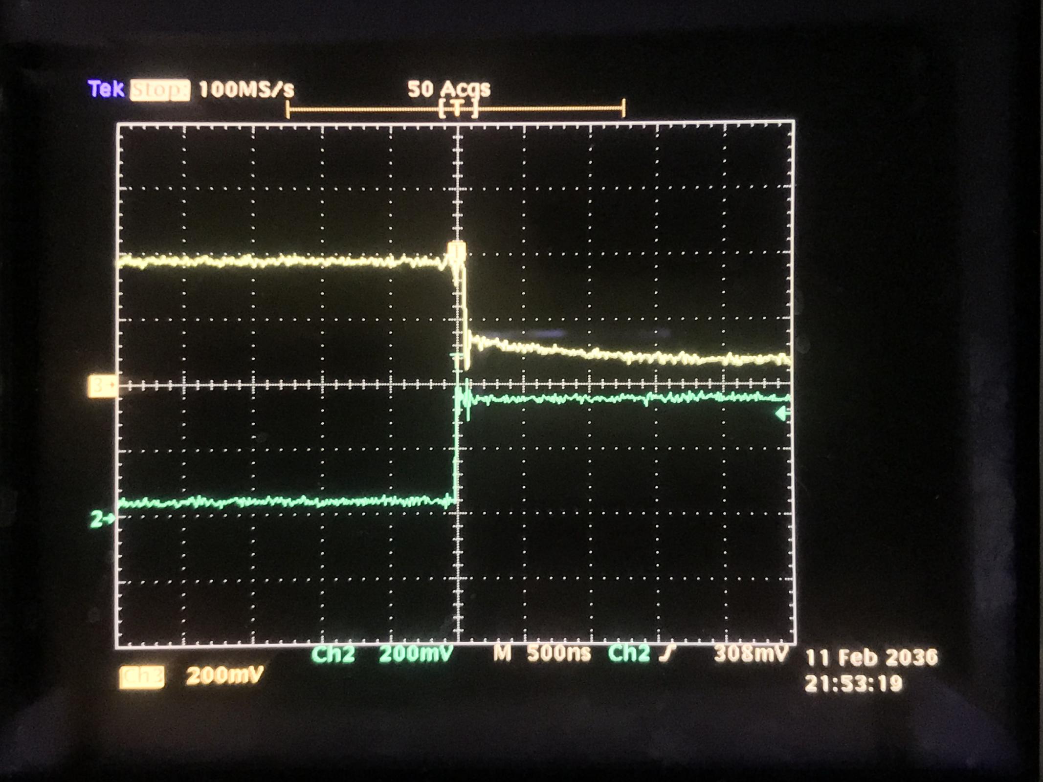

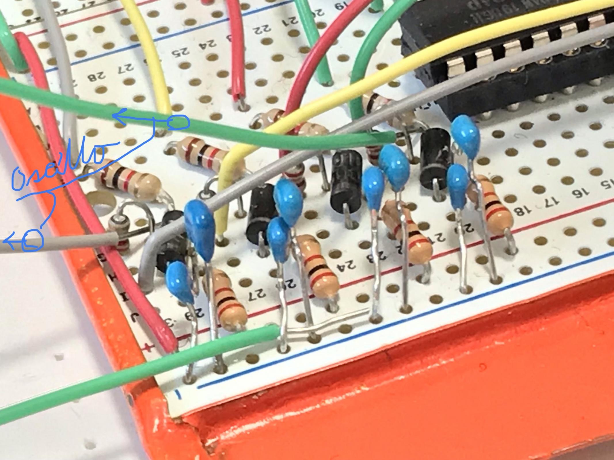

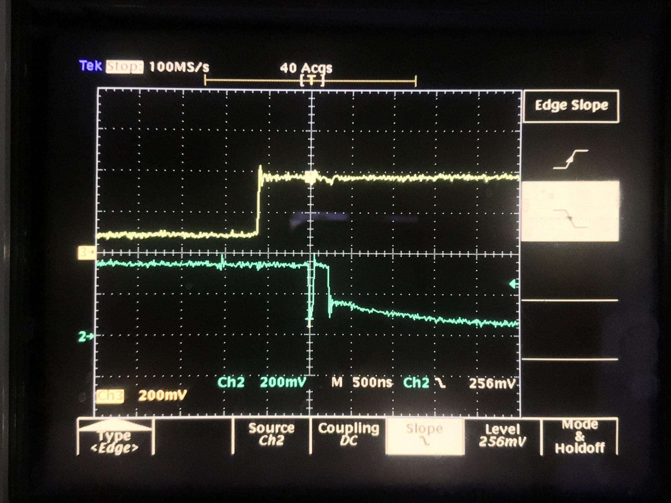

    The logic unit needs a delay-time-unit for one of the safety purposes;
    This unit is not yet given the noise shield.
    The delays are confirmed with oscilloscope views;
    Chy
  17. #10
    trigger's Avatar
    Jun 2018
    198
    216
    Thanked 58 Times in 40 Posts
    Does the breadboard not contribute to rf noise ?Once the design goes to PCB there should not be so much interference.
