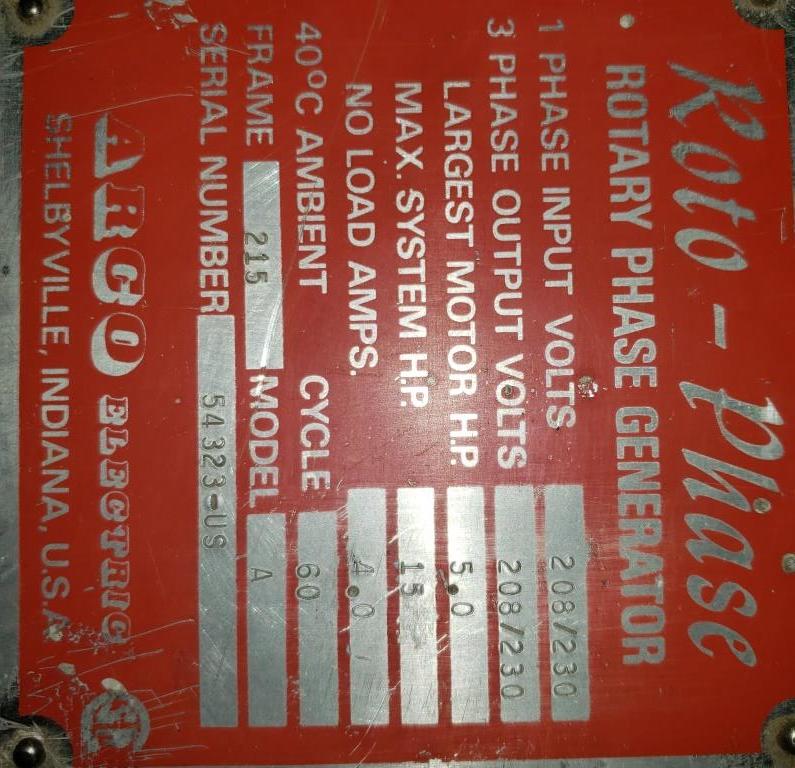

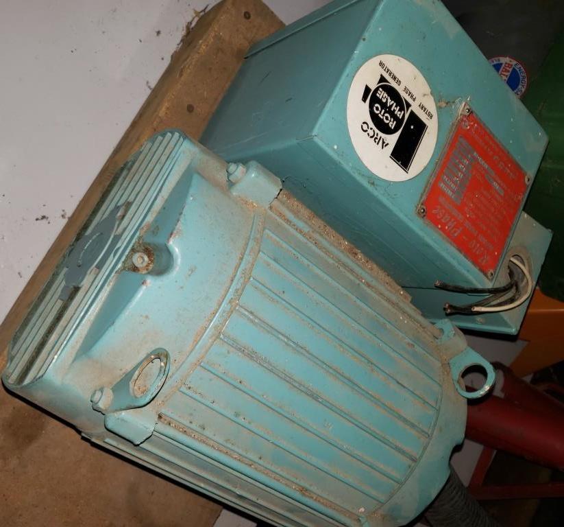

    Thanks for the fast reply, Tony. My 2HP, 3ph lathe came with a new (at the time) RotoPhase converter and 5 HP motor. The lathe also has an antiquated mechanical, infinitely variable drive. Everything has been in storage for the past 30 years and not used. However, my understanding is that the old phase converters were quite noisy. Since I need to convert the lathe to single phase it would be nice to simplify the variable RPM drive. I was considering a VFD because it may be quieter and more efficient than the RotoPhase but also because it would simplify RPM changes. Your thoughts . . .

    . . . About swapping the mechanical variable speed for a VFD, that should be fine unless you need to do heavy work at low speed, I have commented on this in earlier posts.
    Yes, thanks . . . I understand that lower motor RPM = lower torque.
    Like my recent lathe motor change it looks like your lathe motor has gone from 2 hp to 5 hp which will be a big help.
    Sorry, my post was confusing and not clear. My RotoPhase (RP) has a 5 hp motor as part of the package. My lathe is still a 3 phase, 2 HP motor which I need to convert to 1 phase service.
    If you note, the data plate indicates the RP sucks up 4 amps just at idle, no load! I was seeking quieter operation, higher efficiency, electronically variable RPM, and no loss of torque. I thought solid-state electronics could do that but I will loose torque and still have Hi Freq noise (about the same as the RP). Torque is important for my work so I may as well stay with the RP and the lathe's variable speed drive. I'm also considering buying a 3 HP, single Phase motor to make up for the HP loss when going from 3 phase to single phase.
