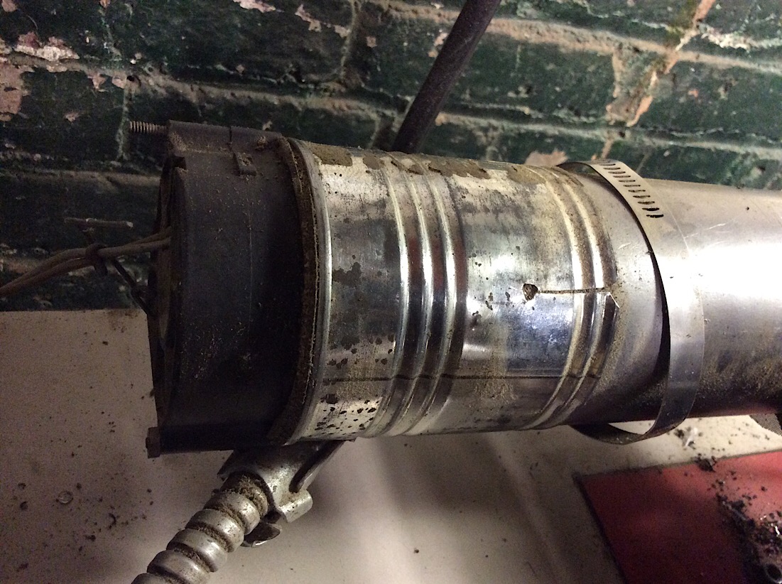

    I use smaller brushed permanent magnet dc treadmill motors on my bench top lathes and mill. Their speeds are different than the original motors, they’re rated ambitiously, and a couple were challenging to mount. I didn’t reuse the flywheel pulleys so I cool them using external fans - here’s my fanciest fan shroud.
    variable frequency drive conversions-0da455a3-150c-42b5-9f04-ac129eb4aebf.jpeg

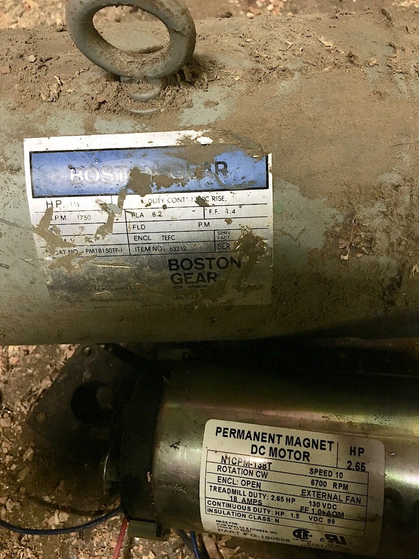

    This picture should give a sense of how their horsepower ratings compare - the motor on top is a regular but older 1-1/2hp 1750 rpm dc motor, and the bottom one is a 2.65hp 6700 rpm treadmill motor.
    variable frequency drive conversions-6053ad3b-f7d8-466e-8fa9-03b7a1e238b3.jpeg

    Well - that PM DC motor sucks up max 18 Amps @ 130V, which gives 2,34 kW input & 2,65 hp max, intermittently
    but it has only a CONTINOUS output of a mere 1,5 hp @ 95 VDC.
    (Which sorta gives me 13,1 A and 1,3 kW IN, for 1,5 hp [or 1,1 kW] OUT at app 5000 rpm. And 200W of heat)
    Reason it can be smaller for the same output is:
    1) Power=Torque x Angular velocity (RPM), so the PM DC has near 4 times the revs,
    but ONLY 1/4 of the torque of the AC motor.
    2) Being a PM motor, it doesn't need the AC's bulky field windings, and (being hi-rev)
    3) Delivering less torque, it can have a smaller rotor diameter.
    Dia equals leverage: You can't loosen wheel bolts with a 6" wrench, you need bigger to get the necessary torque.

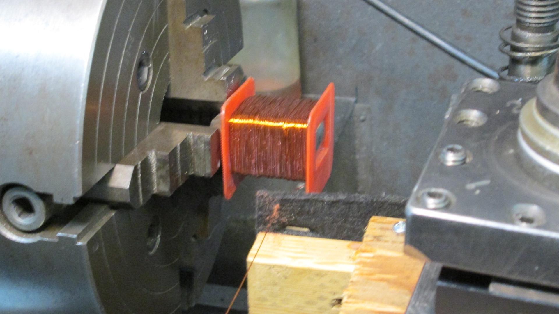

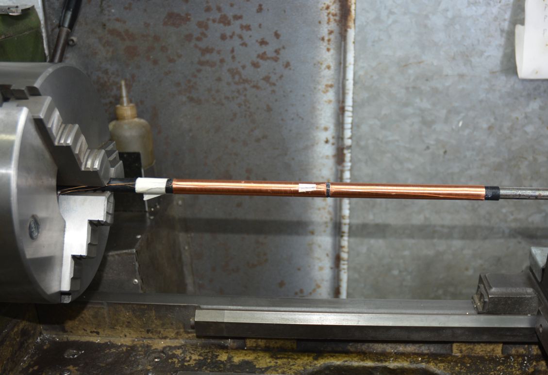

    Is there anything that you can do to keep good low spindle speed torque with the benefits of motor speed control? The answer is to use a grossly oversize motor as I did on my mill conversion and recently on my lathe. The mill motor went from 1.5 hp 3 ph to 5 hp 3 ph with VFD and the lathe from 2 hp 1 ph to 5.5 hp 3 ph with VFD. I will never need 5 hp on the mill nor 5.5 hp on the lathe but they give higher low speed torque than smaller motors.
    Both the mill and lathe have reduced SPINDLE torque at speeds that would normally require back gears to obtain, and that could present a problem for certain types of work. I do not anticipate this being a problem for me because I am usually after higher speed rather than lower. I occasionally used to use back gears on the lathe for coil winding but that needs minimal torque and a test with the new lathe motor running very slowly was in fact better for coil winding because of the increased smoothness.
    variable frequency drive conversions-coil-winding-01.jpg variable frequency drive conversions-coil-winding-setup.jpg Click for full size.
