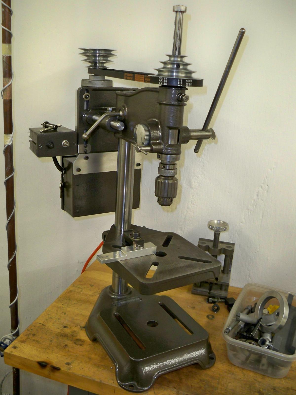

    I have a variable frequency drive motor from a treadmill. Can I change my drill press to use it? The drill press is a 5 speed bench
    mount unit. Is it useful? Any ideas on how to do it? I thought I read an article about it but can't find it. Any help is greatly appreciated.

    Yes I do. I have the rheostat, wires ,etc. If I can remove the belt drive (it is a round disc that is threaded on ) I am aware that I will have to machine an adapter to mount the coned pulley or use a single pulley of what size?

    Then this should work fine. If this is a brushed motor like most treadmills, be aware of brush life. Long for hobby use, not so much if it's constantly in use.

    I recently converted my 10 inch lathe to use a treadmill motor(brushed) rated at “2.75hp”. I used a pulley that allowed the motor to operate in the higher voltage/rpm range. I have threaded at 60 rpm with no problem and turned a 3.5 dia. Losing only 8-10 rpms. I used the motor control from the tread mill and wasn’t smart enough to separate it from the rest of the circuitry and added a tach.

    Quote Originally Posted by mdhatter3 View Post
    They work great for smaller drill presses. If you have stepped pulleys on the DP now, you could still retain them with the new motor so you have a "speed range" for each of the steps. This was an old beater w/ no motor I got for free and cleaned up and installed a DC motor and speed controller from a treadmill.
