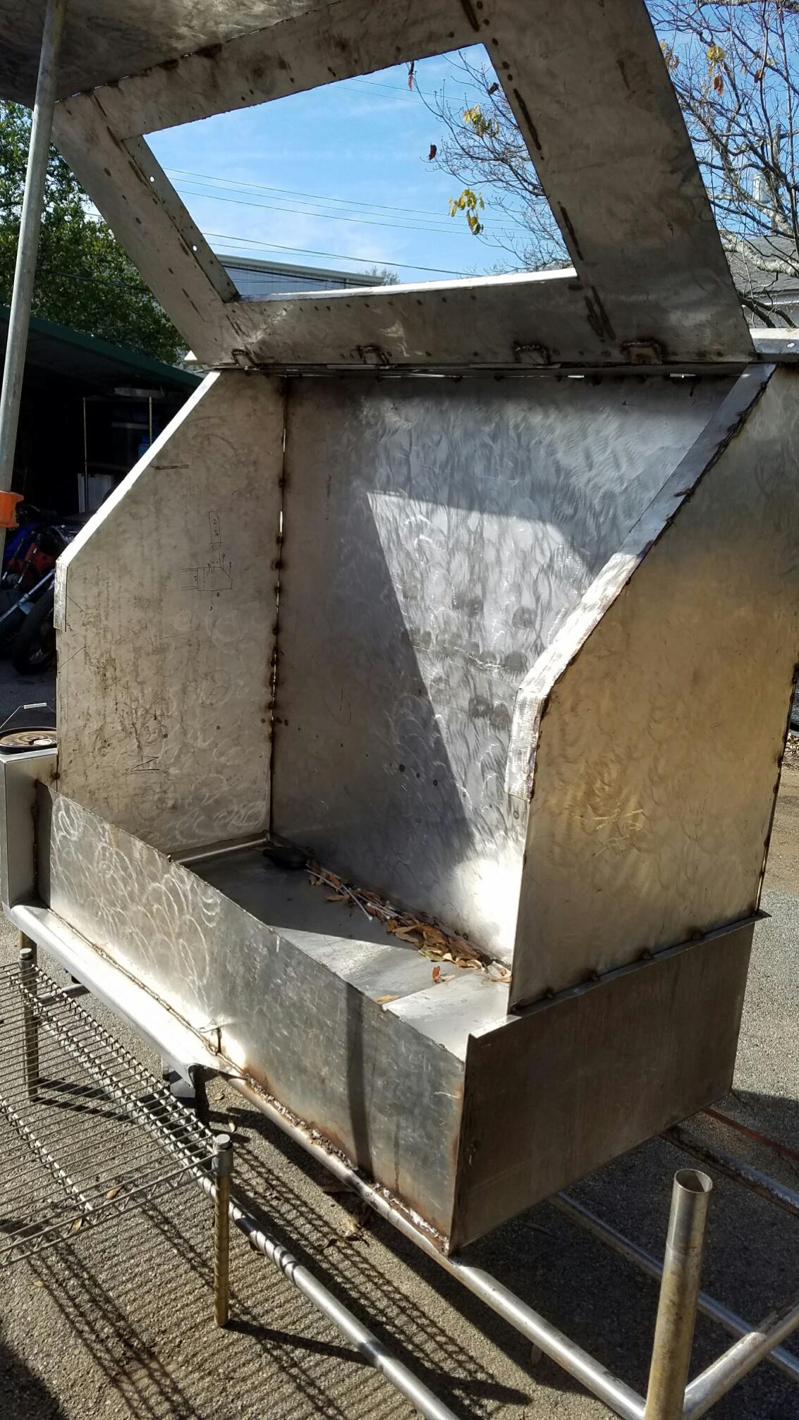

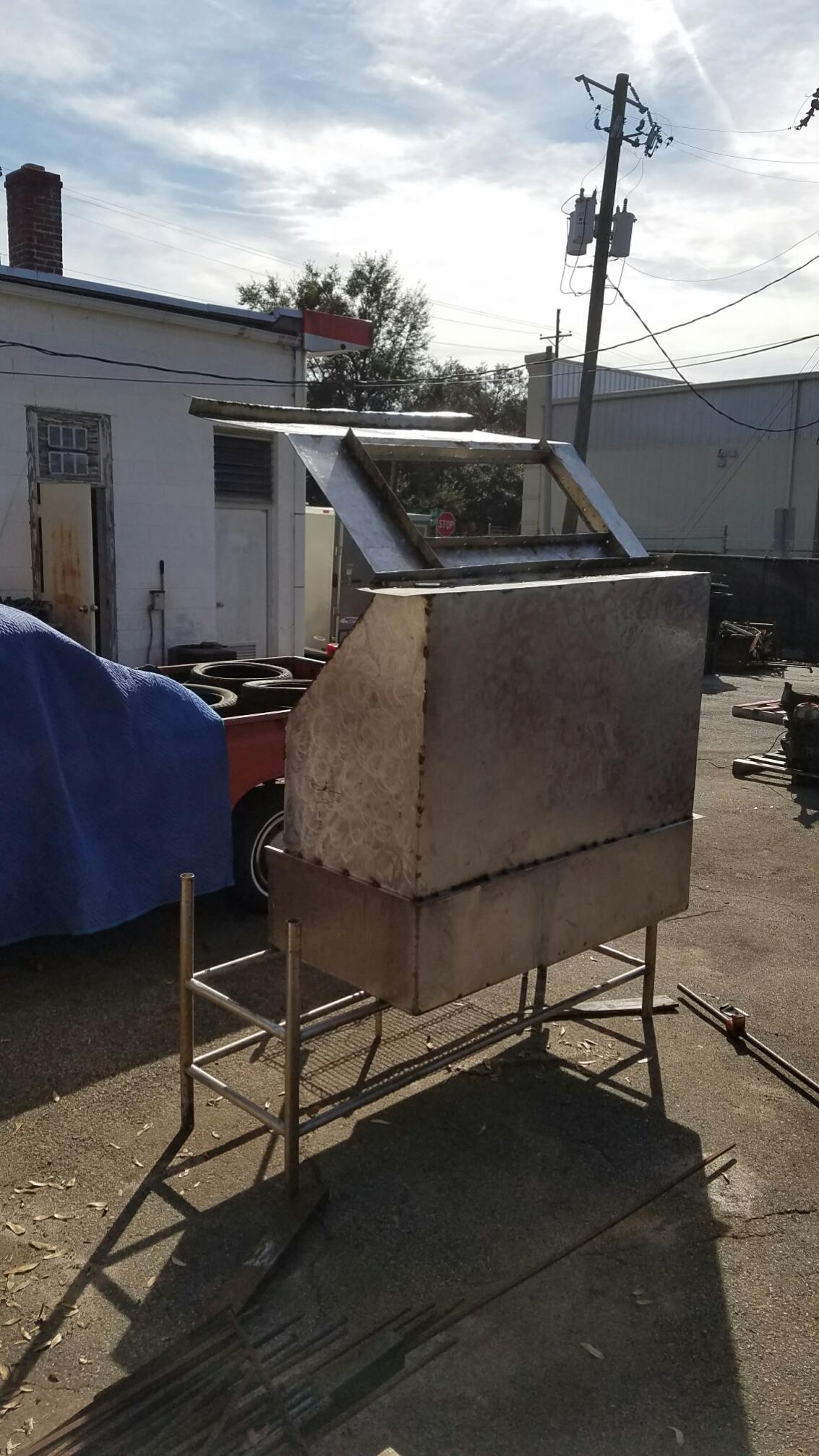

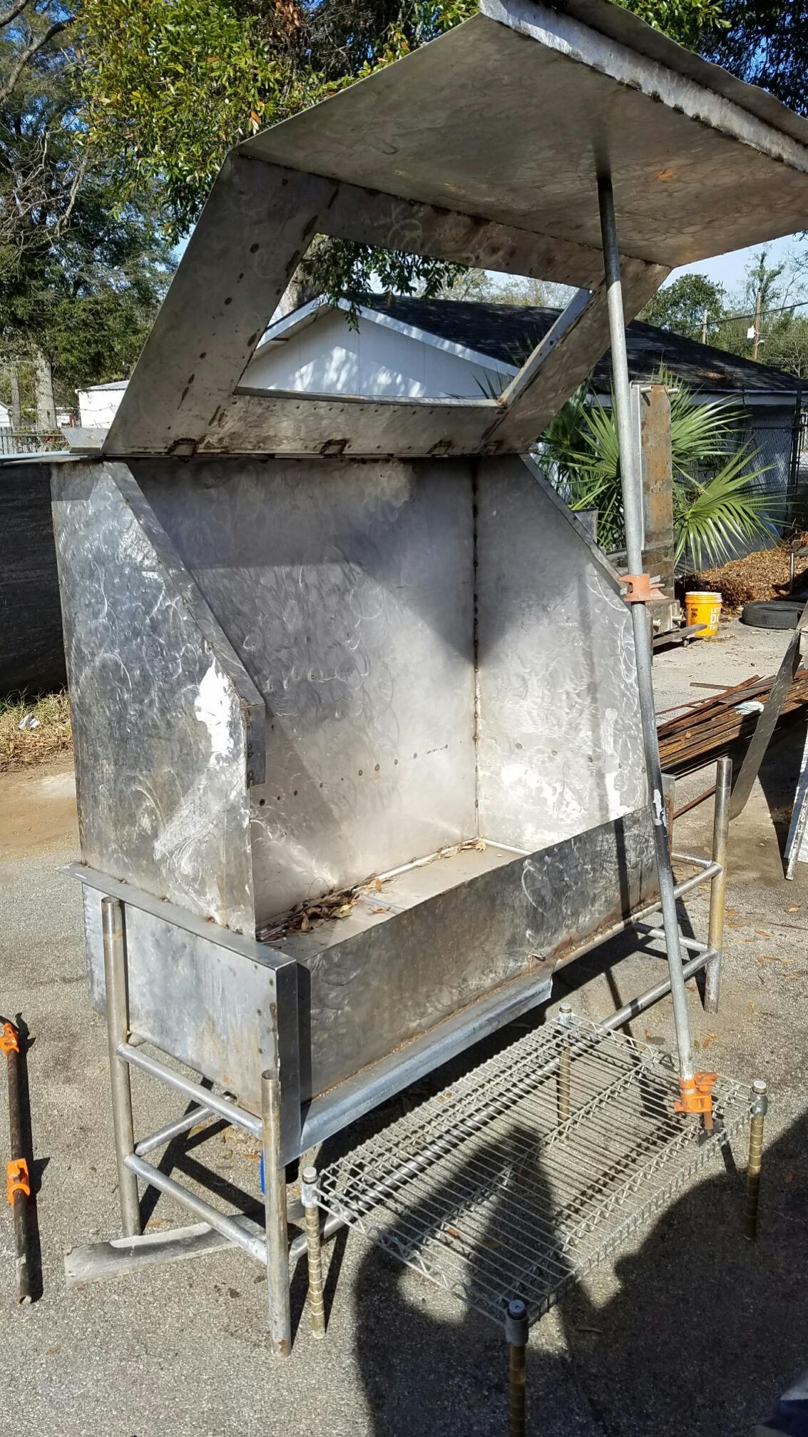

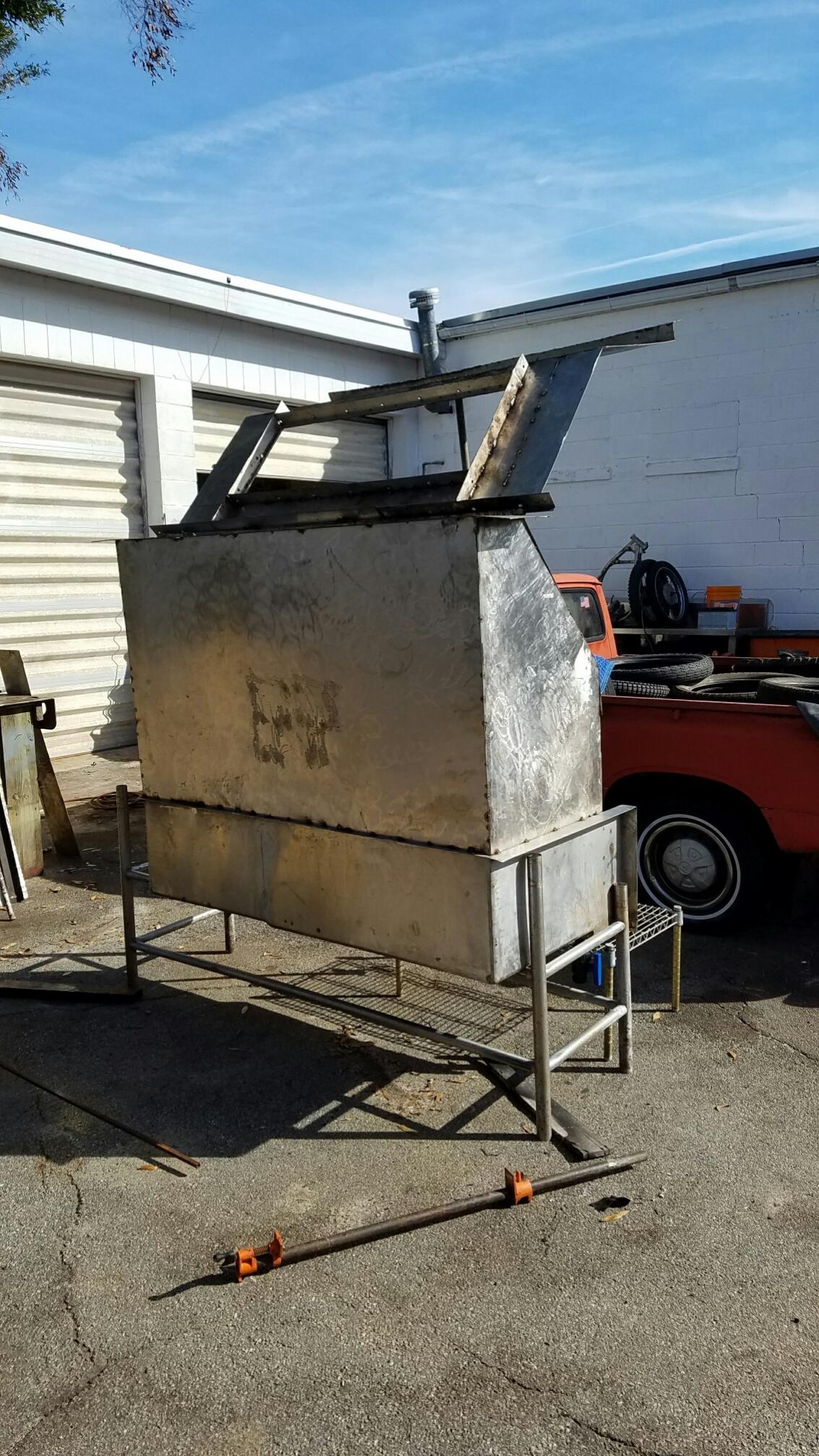

    So I now have the door reinforced at the viewport and hinged to the body of the spray booth. It's taking a bit longer than I expected to finish this build. It was freezing the other weekend and I had shoulder surgery this past week. Kind of cuts down on my free time to work on it.Vapor Blasting Cabinet-20170115_113503_resized.jpgVapor Blasting Cabinet-20170115_113443_resized.jpgVapor Blasting Cabinet-20170115_113432_resized.jpgVapor Blasting Cabinet-20170115_113452_resized.jpg

    Yup, that my experience of all my big projects. I get the basic broad strokes done then it's the those details. And they seem to take way longer than the main part. It's cool you have so much stainless to work with. I don't know how I'd get anything done until the shoulder heals up though. Good luck and thanks for posting your progress.
