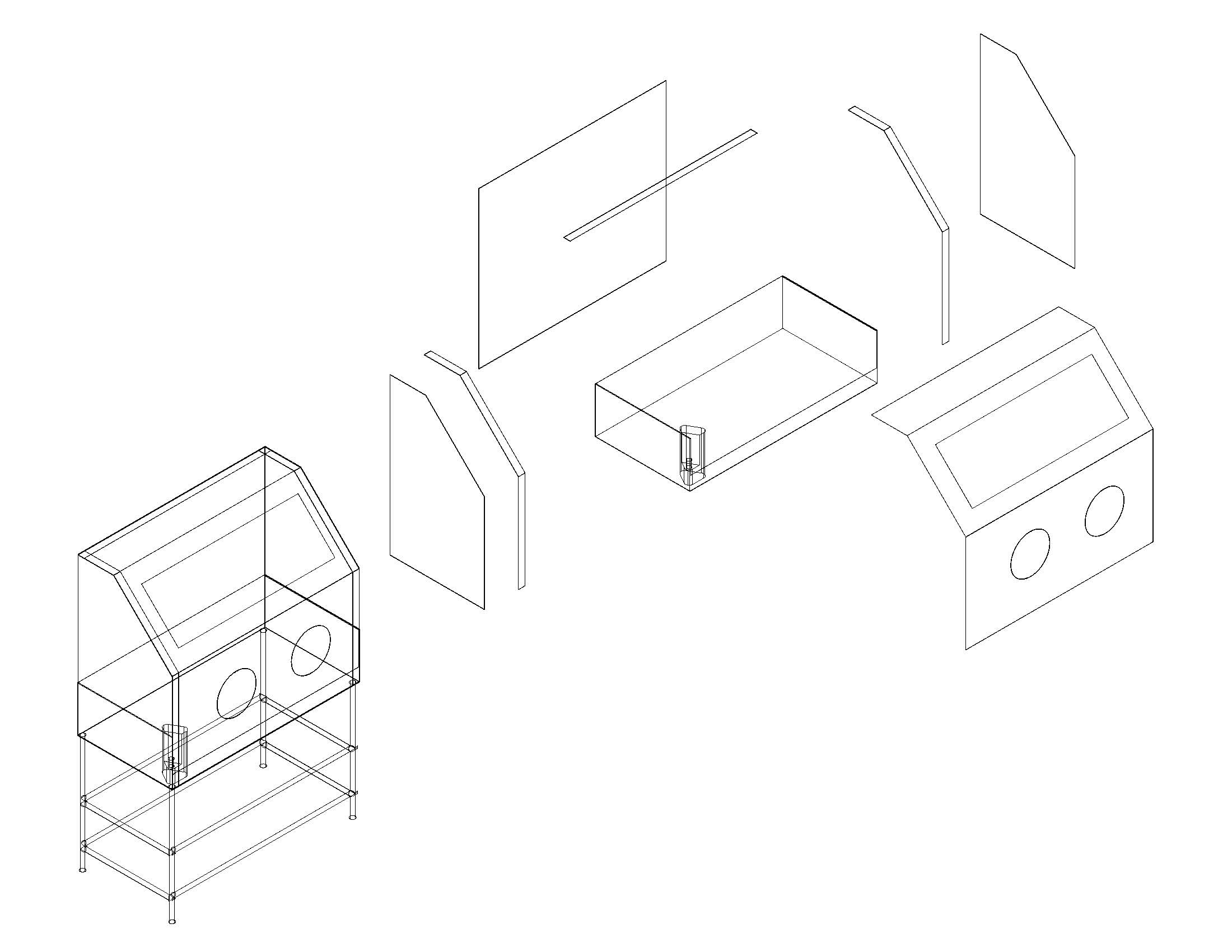

    CAD drawing of booth

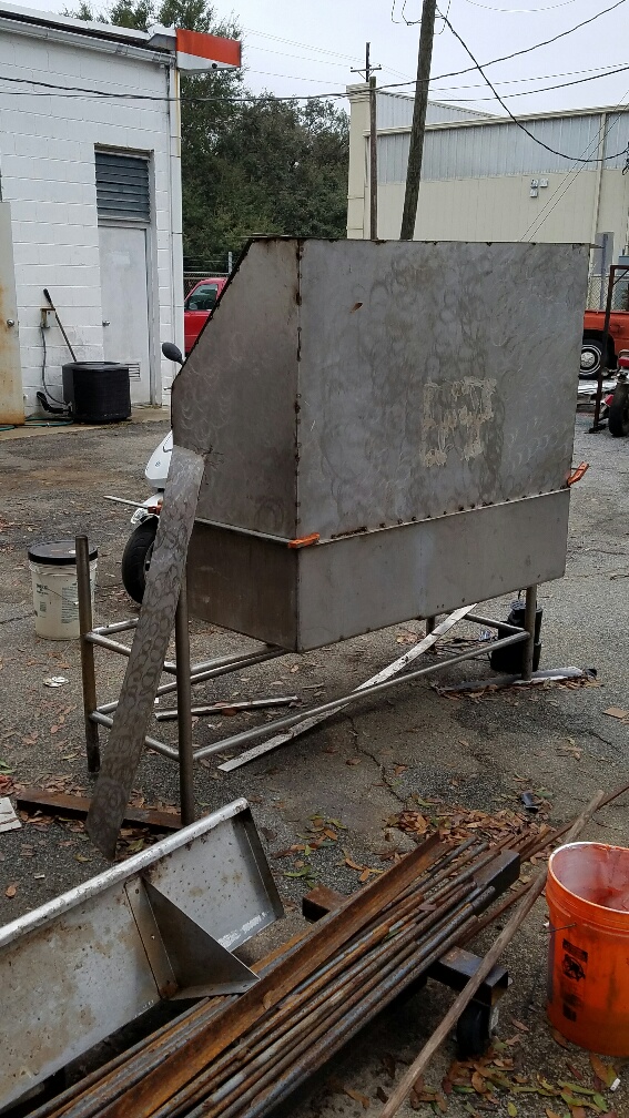

    So I started with an idea of what I wanted based on the items I had at hand. A sink/counter out of an old IHOP and a bunch of stainless sheets a buddy of mine gave me.

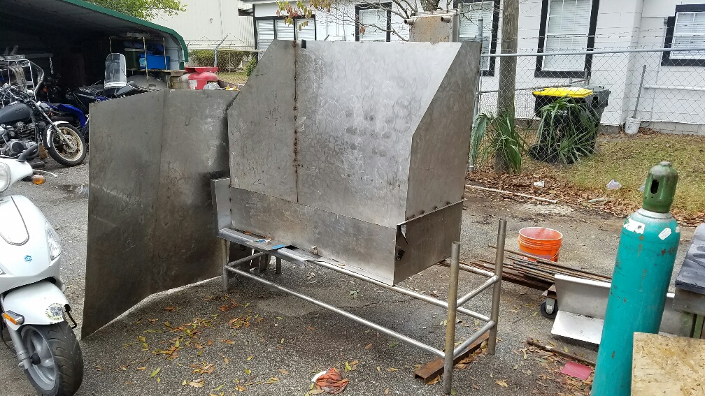

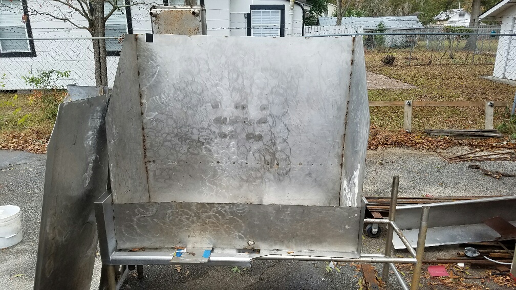

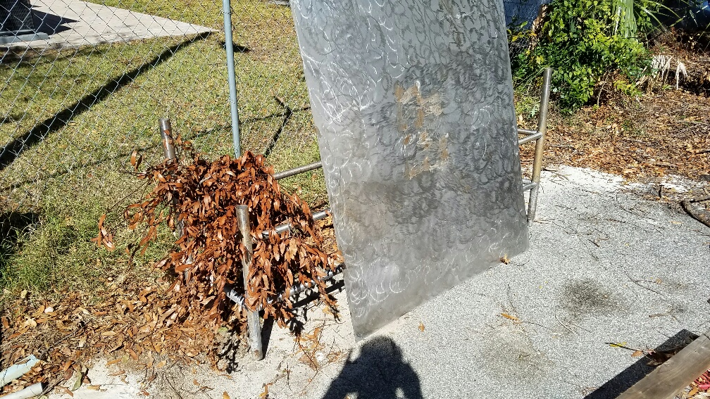

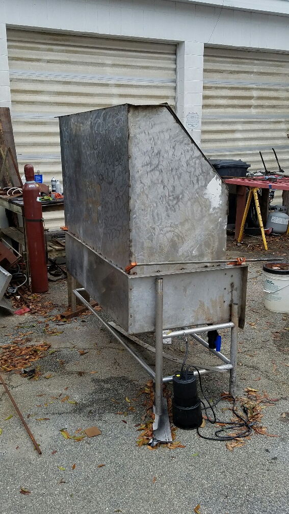

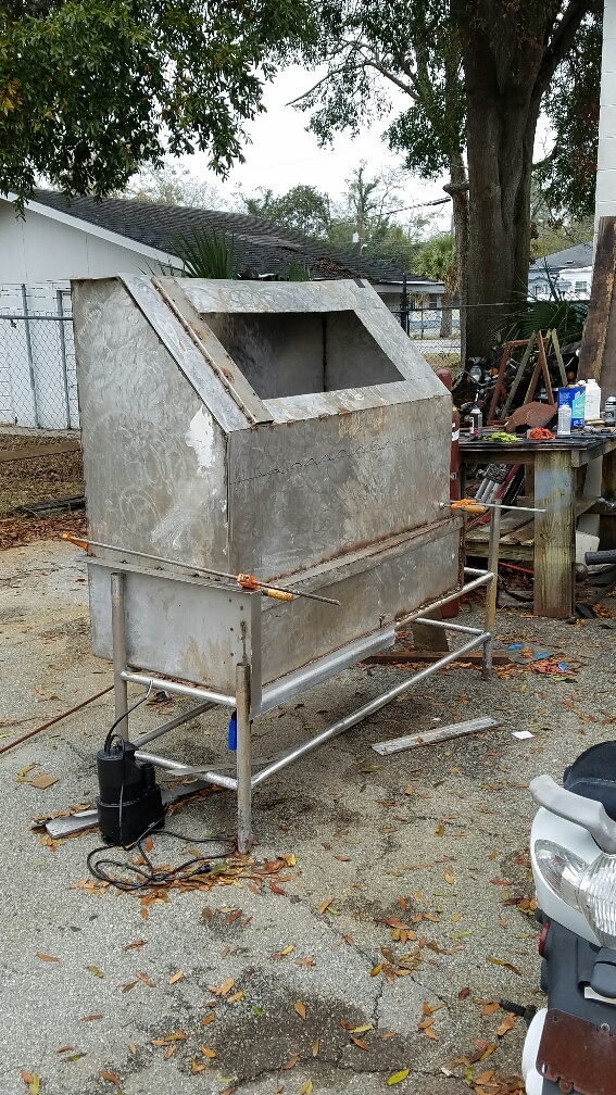

    more pics

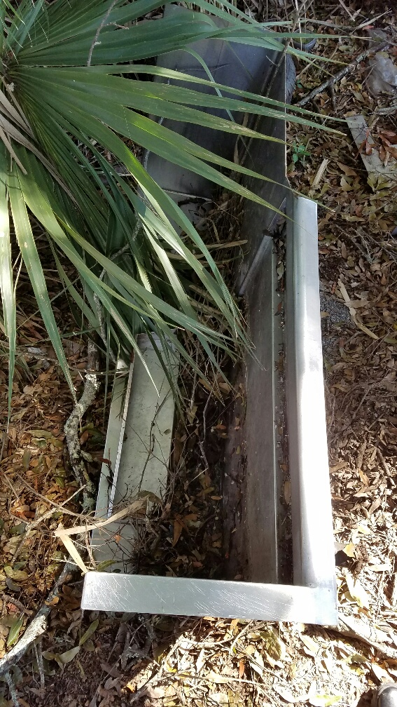

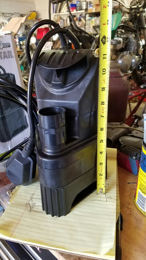

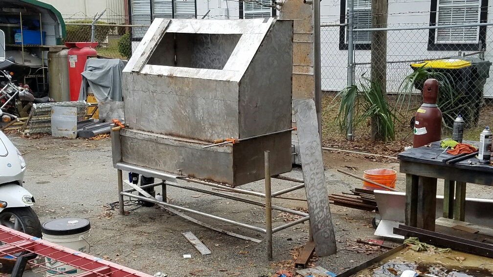

    just a few more of the materials and the start of the build.

    Yeah, it's a high CFM, but I'm using a sump pump that gives me about 1/2 that and restricting it down 75%. I'm also using more pressure on the air side.We'll see. Might need to go with a larger pump.
    The blast media usually is glass bead. If you want to scour aluminum oxide off that's really crusted on hard, you can go with a crushed glass instead.

    I've looked through a lot of builds and also the commercial booths. I settled on what I could find, scrounge, or dig up. To date, I probably have around $500 invested in parts, Argon, cutting wheels, pumps, lights and what not. I like to think of it as Karmic Tool Fabrication. Whatever I can get my hands on goes into the pile and then I see what comes out the other end! lol
    C-bag. A lot of folks use a pressure washer for their power, but I found a gun and hose that uses a lower pressure water/slurry and introduces compressed air at the gun to increase pressure. The bottom of my build isn't in the drawn down hopper configuration so we'll see how well the slurry is agitated. I may need to introduce a secondary pump to keep it all mixing down below.
