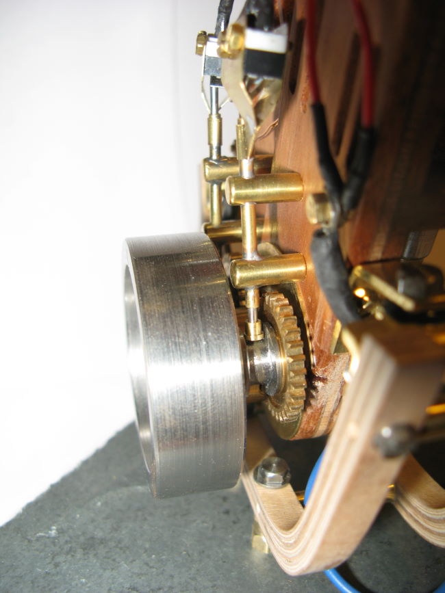

    Quote Originally Posted by baja View Post
    That would be a 2-stroke?
    Hello Baja, this is actually a 4 stroke, the switches are driven from cams that are geared 2:1 from the crankshaft. Hopefully the image below helps:

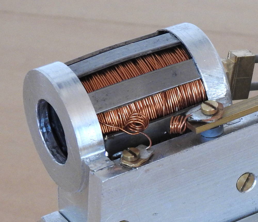

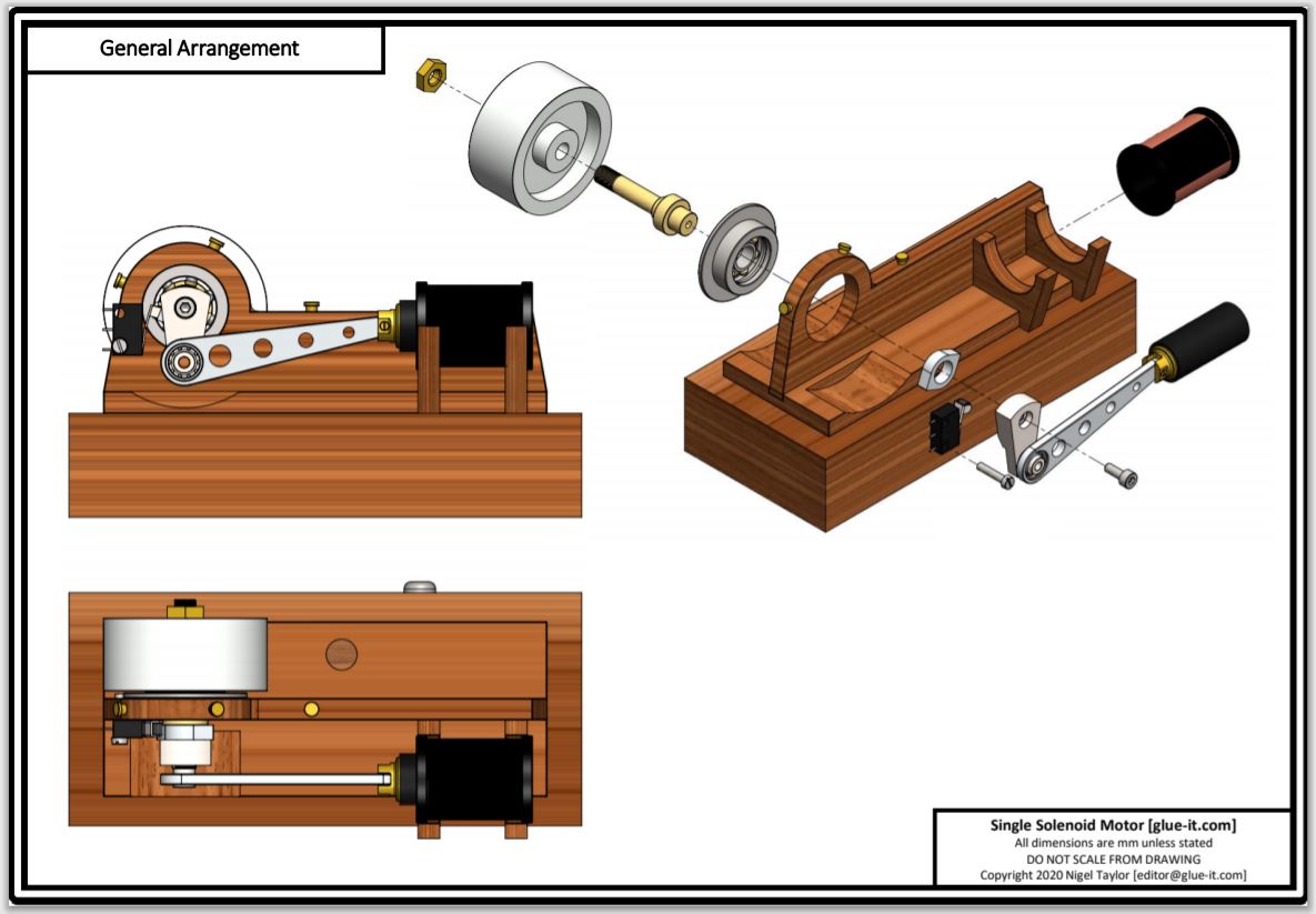

    I've finally managed to complete the plans for this motor/executive toy

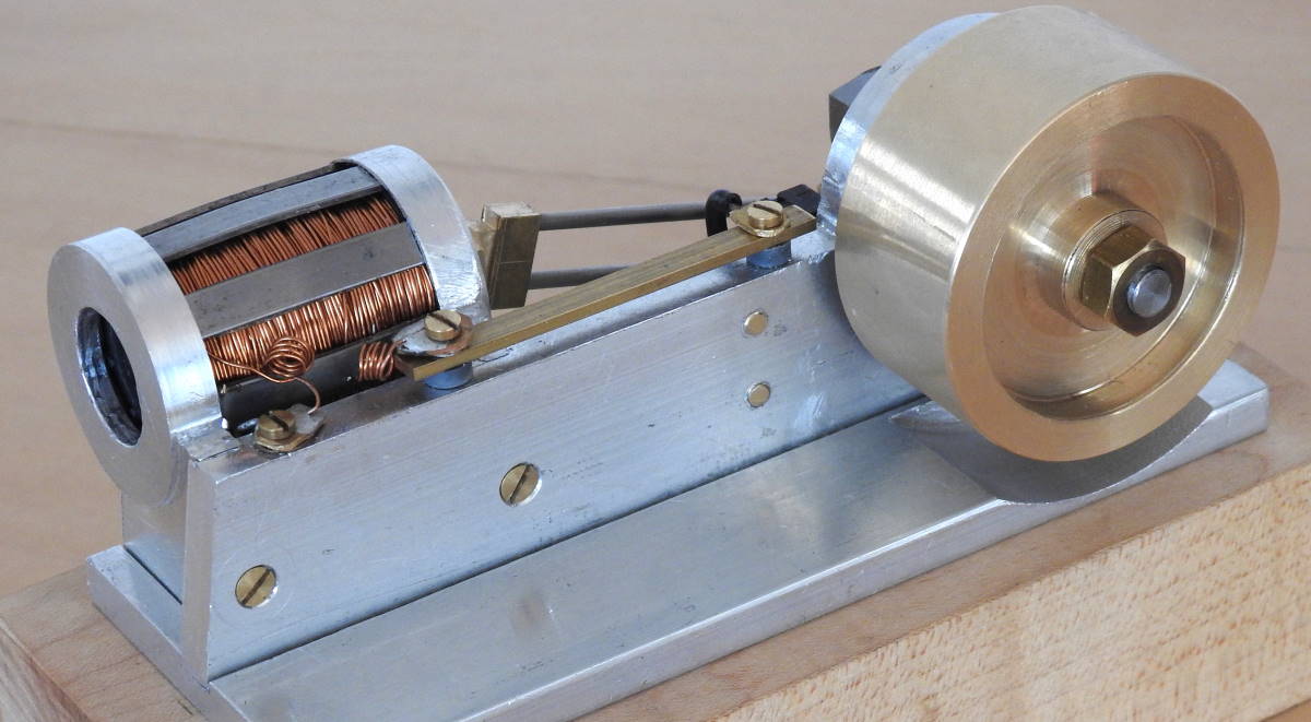

    Sometimes people take your design and improve it. Henk Kaan used my plans for the solenoid motor and selected different materials to produce a sharper looking model.
    More details of Henk's material selection and build.
    This little machine is a great desktop toy and easy to make over a weekend, especially a rainy weekend.
