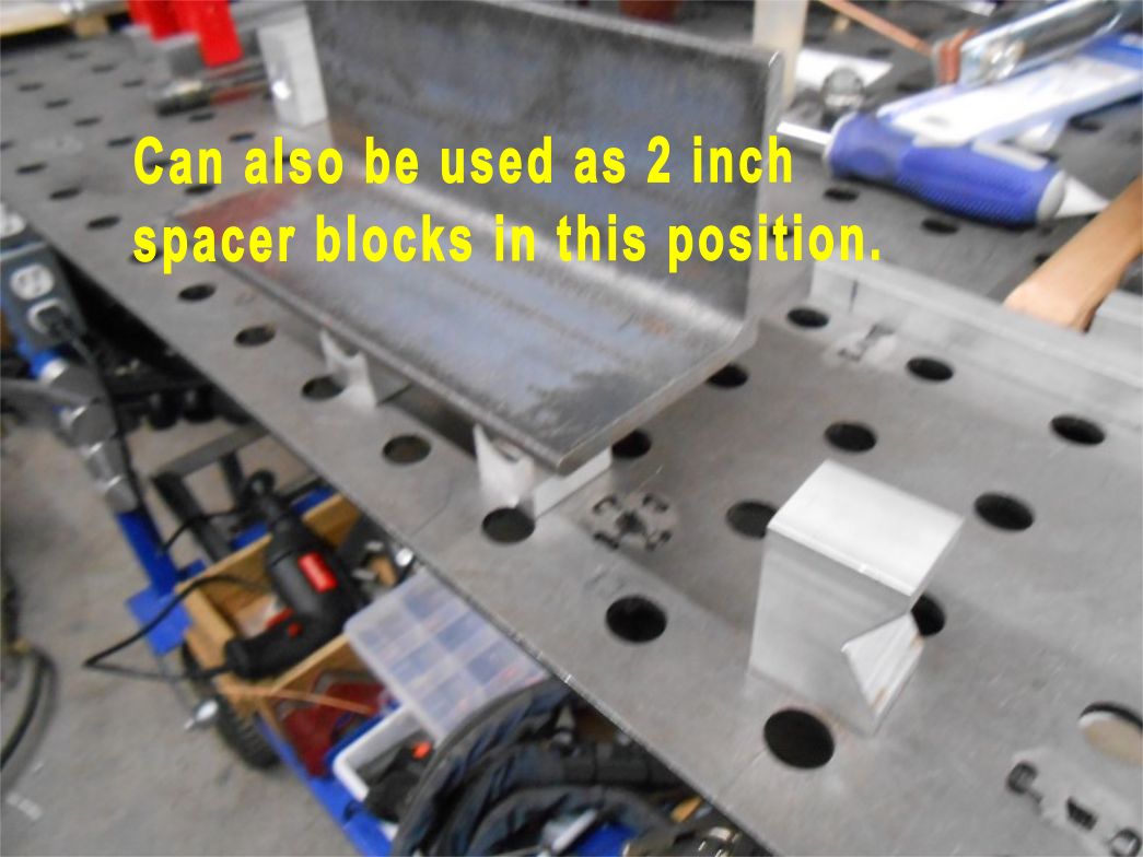

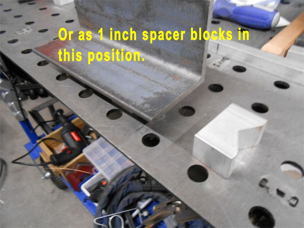

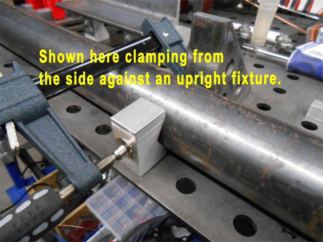

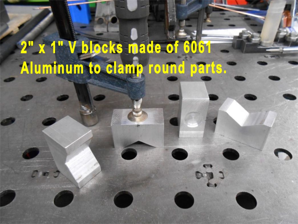

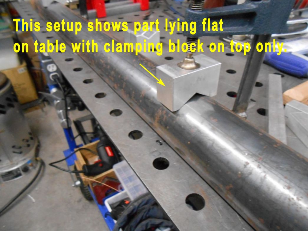

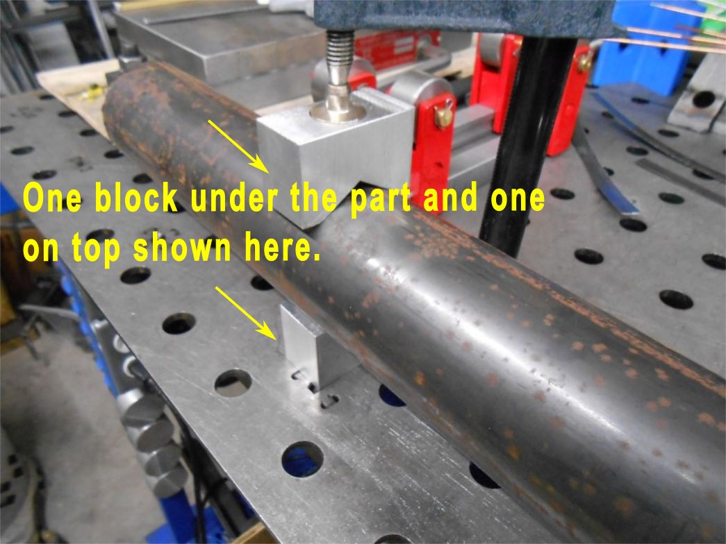

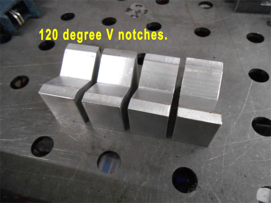

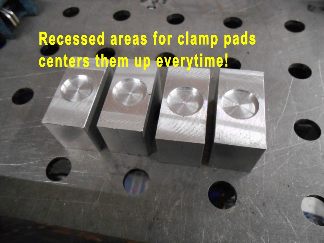

    I made these aluminum V blocks to help aid in clamping round parts such as pipe to my welding table. They feature a 120 degree angle, recessed areas on back for quick center alignment with most F and C style clamps. These easily lock down those hard to clamp pieces!
    They can also be used as 1 inch or 2 inch spacer blocks.
