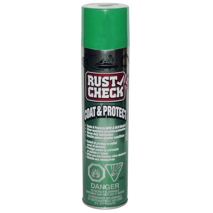

    Quote Originally Posted by BuffaloJohn View Post
    Some WD40 goes a long way to keep the cutter from clogging...
    I used to use WD40. Stuff stinks, gets everywhere and doesn't stay on the material you're cutting. My current favorite is a can of green rust check. It has absolutely no smell and comes out very thick and sticky. It works amazingly well. If you like WD40 you'll love this stuff.
    Using wood router bits on the Mini Lathe-10e8ca0d-7d65-463f-a97b-64894d8b07cf.jpeg

    I actually like the smell of WD-40, I would literally use it as cologne if I could. I buy it in 1 gallon cans locally and use a WD-40 branded squirt bottle which I like a lot. It's shoots a nice narrow stream that I can aim right onto milling cutters etc.
