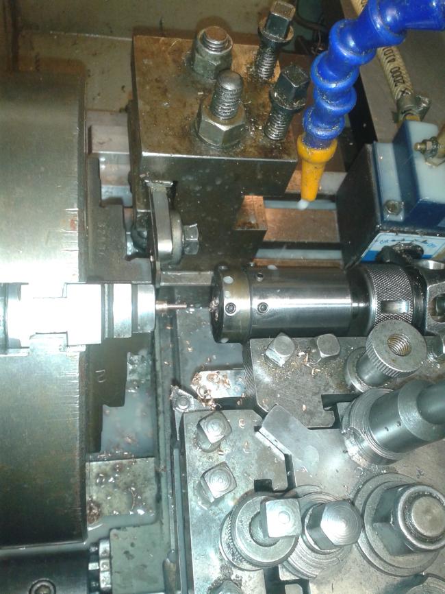

    Hi All
    I have a Coventry die head but this doesn’t work well on short threaded studs or bolts, due to the fact it needs to pull its self forward out of its main body by 3/4mm to disengage.

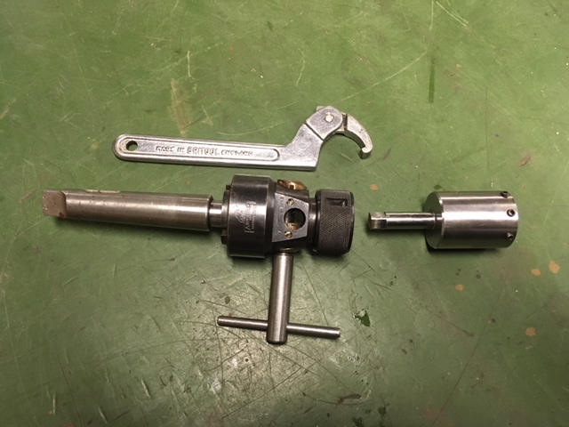

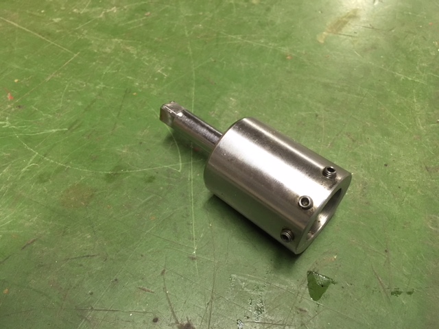

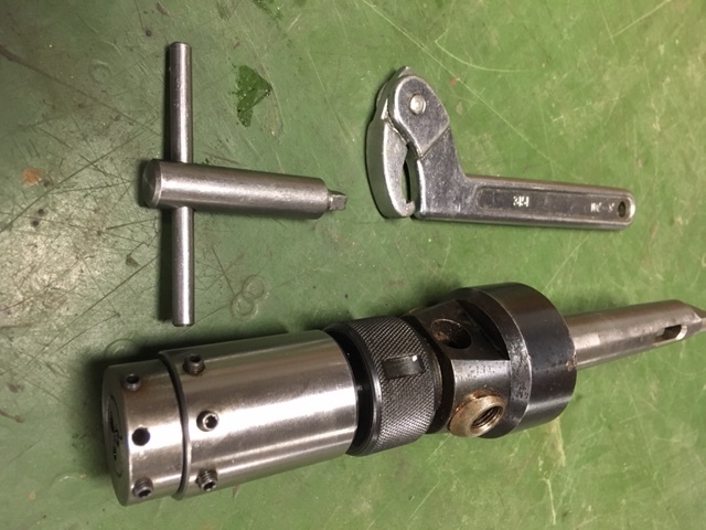

    To aid threading under power I decided to machine a die stock which fitted in to an Archer friction tapping head as can be seen in the first photo.
    With the clutch set correctly on the tapping head, it is possible to machine right up to a shoulder or the chuck jaws under power without fear of snapping of the screw or pulling the job out the chuck or damaging anything for that matter. Having a positive stop/datum aids length tolerance repeatability, of the thread being cut. I have added a link to some bolts I made for my 1” scale Minnie traction engine in bronze using the tapping head setup.
    This is a link also to my split die setup which saves a lot of time and effort http://www.homemadetools.net/forum/s...ie-setup-65783

    Hi Frank
    There is a friction clutch in the back of the unit which can be easily set by tightening the castle nut with the c spanner to compress the friction pads. Once you come up against a shoulder etc. If set correctly the chuck simply over comes the drive friction and spins. I have several tapping chucks and in my opinion the Archers are the best.
